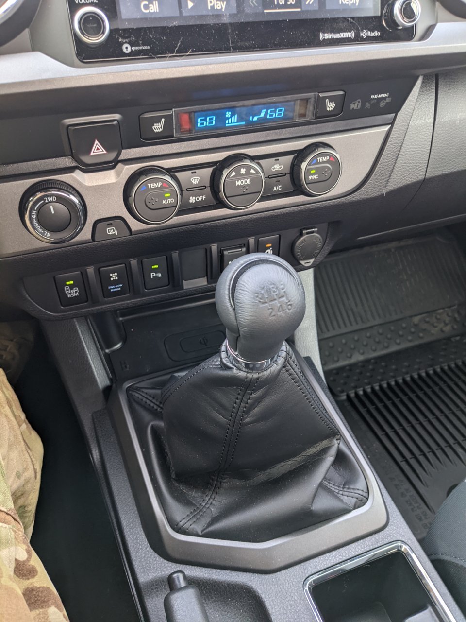

    If only they made a DCLB with a manual. Personally I'd rather have a 6' bed than a manual, and the annoying part was that the problem was solved with a tune using the same software Magnuson is using (but with an improved tune), but Magnuson isn't doing anything to improve it (as far as I know)...
