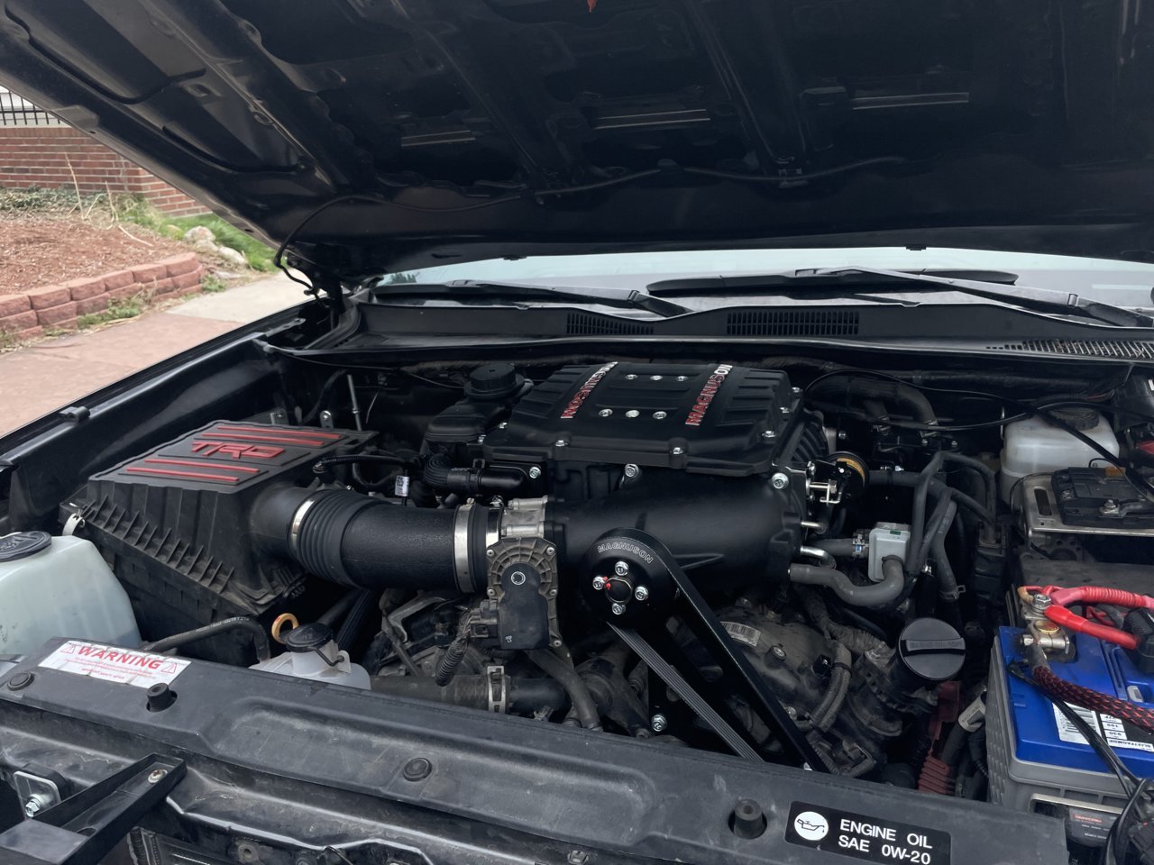

    And that's fine, I understand your point. Should I have just went with your turbo's? Maybe, and I've been following that thread since the first post. But I know there is untapped potential in this SC. I would be so fucking stoked if you got on board trying to get it to where it should be and really hope I don't have to give some dude in Canada my money to get it there.
    Also A) if they say they can accommodate a request they should follow through
    and B) I can't believe they actually took the stock mapping and thought people would be happy. I want to hold back on the shit talk after spending 6.5 grand but at this point I can't... The tune is garbage and OvTune 2.0 and KDMax honestly blow it out of the water. The whine is nice without the restrictor... but it is what it is

    Ok, that's fine for all intensive purposes on a dyno- I would argue there is a comparison though because it felt 1000x better with KDMax than with the SC (not only driveability but also power delivery). 2.0 even felt way better, call BS on me if you want. Sure, I feel the power lower down (definitely doesn't feel like 50% more) but the stock 3rd gen tune is garbage and anyone that knows anything knows it. The primary reason people want to customize performance is for the shifting logic which is atrocious stock and why I have an LLC now. Again, like I said I can tell the potential is there. It's just using an absolutely garbage tune, and I wish I knew more about tuning FI.
    And that is what I was looking for. If I have to buy it from Matt2 or OvTune10 I will. Take my money
    The first person to market with this is going to make a killing. If that's any inspiration for you to get it done. Fact of the matter is if someone wants to do their own thing with it I don't think they should be sending locked tunes. Especially if people are willing to void their warranty for it....

    You are the first person in a good while to complain about the performance. Check and make sure you are getting around 7psi of boost. You may have a boost leak somewhere.
    Stupid question but are you using the gas pedal enough? The 3.5 especially with the SC wants near wide open throttle for any performance. It’s just how the engine is. I come from low HP high revving car backgrounds where it’s full throttle or no throttle unless you are holding a steady speed. Driving that way I’ve always been happy with the 3.5L and it’s even better now with the SC. But most truck guys don’t use the skinny pedal that much and it takes a decent bit of throttle to open the vacuum bypass.
    3rd party tunes will eventually be available but it’s going to take a couple years likely. The right people have to buy a magnuson SC and make the tunes.

    I admit I am from Boston and I'm the first person to speak my mind always. But yes, I am pretty pissed off with the SC. I am WOT pretty much anywhere. Again like I said it feels nice around town and less then 50mph. No leak a big shop (who's an authorized Magnuson installer and could do them in their sleep) did the install and also said most people that are somewhat experienced tuners/have a custom tune don't actually enjoy the SC in 3rd gens, I said whatever install it anyways. And yes I know most people don't complain about it, but how many were actually actively tuning before it? I am in this thread way back asking about reactions etc.
    Again, I think there is huge potential here. But it's a conservative tune, and the fact that it's locked after paying 6.5k is annoying. If I tell them they can void my warranty why not let me change stuff? And if they tell me they'll change stuff for me why didn't they do it? It's frustrating.

    I think the problem you're feeling is the lack of transmission tuning which has been a problem with the 3rd gen since it was released and the reason I would never own one with an auto. I don't notice that with the manual. Judging from dynos of before/after it's a 100 ft/lb more torque starting at about 2500 rpm and stays that way. For me it is definitely noticeable, especially with downshifting one gear to put the truck back in the midrange powerband.

    I have no dog in this fight, but I think what Adam @MGMSangTaco is trying to say is--he does not doubt the tune is good for HP and torque, the problem is DRIVABILITY.
    The stock Toyota tune has terrible drivability--upshifting, downshifting, throttle, Cruise control, etc.
    What he wants is for Magnusson to allow him or someone to give them a better base tune to add their SuperCharger ignition, AFR, etc. settings to.
    A Dyno tune will not help Drivability like a good base tune will. A Dyno tune will increase power and torque.
    Them using the Stock tune as a base is the problem.

    No you're right on the money. It would also be fun to get 350+ rwhp out of it down the road with a smaller pulley etc (and I know Matt said that'd likely require fueling upgrades) but drivability would definitely be a start.
    I will say it really does have some power and zip down low at lower speeds WOT for sure. But again, the stock tune's transmission is just completely all over the place. It's more indecisive shifting on the highway than when I ask my girlfriend where she wants to go out to eat.

    A good dyno tune will increase drivability too. Every shop I've gone to gets a max power run then we adjust everything to make it smooth.
    putting the restrictor back in will smooth the transition between boost and no boost. That won’t fix the shifting but it will help with cruise control.
