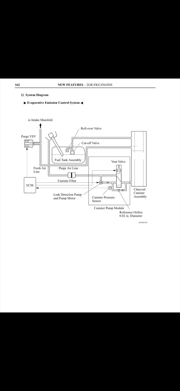

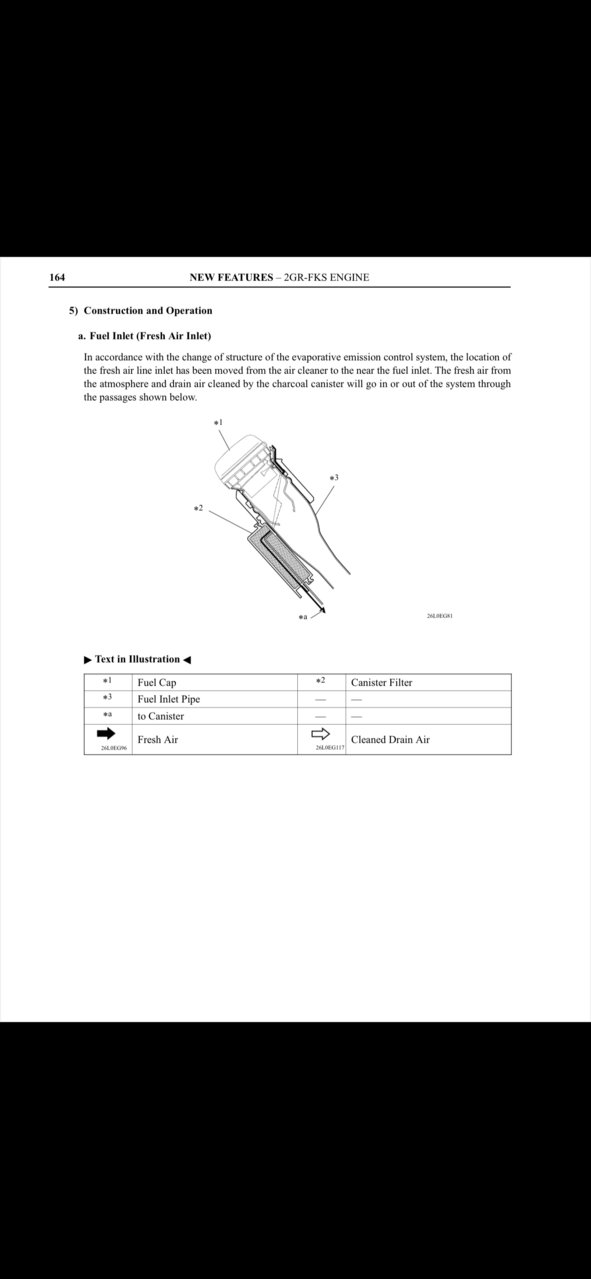

    Update, I got a CEL for PO0455 something (Large leak). Cleared it and did a smoke test. It seemed to come from the fuel cap area, so got a new factory fuel cap and it still returned. Need to go back and do another full check. Might be a loose line in the system. Will update once I get it resolved. But, still....getting better gas mileage than before, easier passing, and oh yeah....smiles every time I hit the skinny pedal!

    Fresh air line?

    Nice....Im gonna take a look!!
