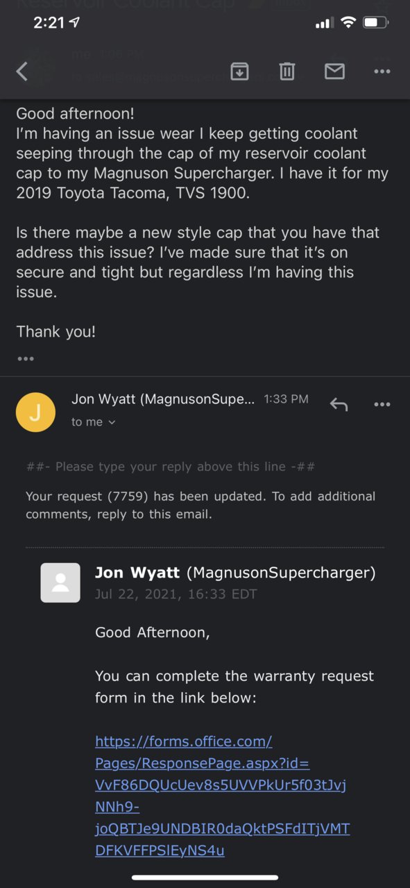

    Does anyone have coolant seeping through the reservoir cap?
  7. Jul 22, 2021 at 2:21 PM
    #847
    sorevilo
    sorevilo Well-Known Member
    Apr 17, 2019
    #290480
    312
    @Isay0526 yup! I emailed Magnuson about this today actually! They said to email the warranty department
    Isay0526 likes this.

  9. Jul 22, 2021 at 2:26 PM
    #849
    Isay0526
    Isay0526 Well-Known Member
    Jan 27, 2018
    #242579
    150
    Isay
    2017 Tacoma TRD offroad
    I knew i couldn’t be the only one. And I’m sure most of us are. I’ll send them and email also.

    I cleaned mine up, siphoned out a bit and haven't had the problem again. It seemed for around for about 3k miles before that though.

    mind showing us what you did? I was wondering how pressure was going to be relieved when I was installing this kit.

    same for me - had a few signs of leakage - waited until it had cooled down and pressure had dropped (from heat and expansion of liquid) - used a turkey-baster to remove liquid to ensure it was a good 1/2 inch below top of tank. cleaned up the screw top and put it back on. No problems since.
