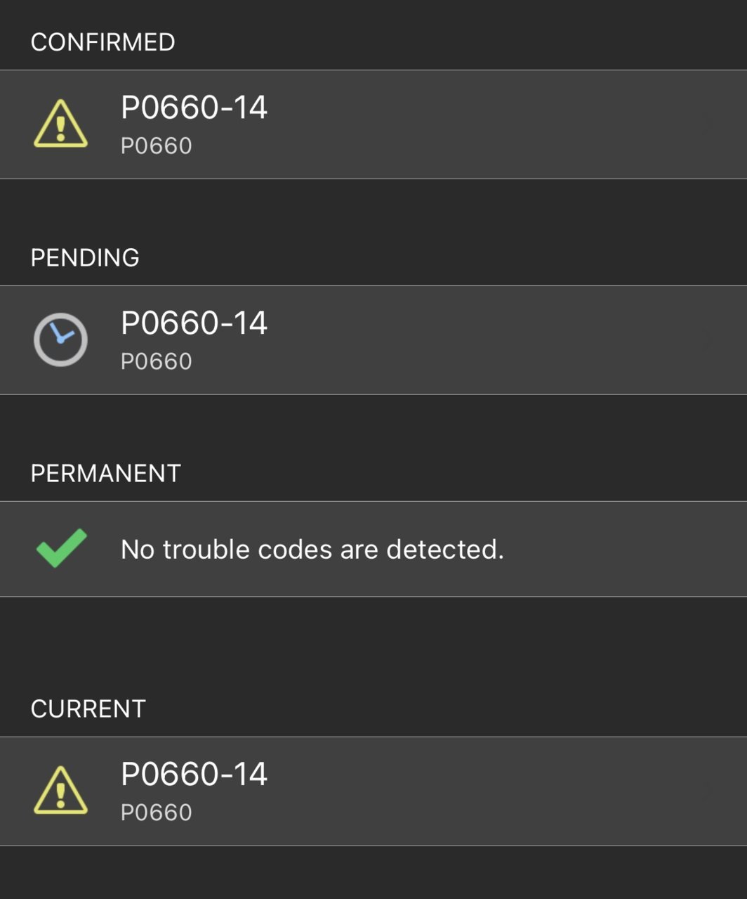

    Just took a drive to pick up those bed stiffeners in the thread you tagged me in on the highway and took it easy but no problems. Oddly enough now I’m getting P0660-14. Just cleared codes again and drove and nothing now. I have 1k left on my factory warranty and know a good service advisor but I can’t help but think this is related to the magnuson since I have never thrown a code before and all the sudden my dash has become a christmas tree..

    The obd link app said “cruise control code”… the internet says this “Error Code P0660 is defined as Intake Manifold Tuning Valve Control Circuit/Open Bank 1. This means there’s a problem with the bank 1 of the engine intake manifold turning valve control circuit, which is usually caused by damaged wires or defective PCM.”
    Just reset codes and nothing now. Blech

    isn't the Tuning Control Valve the connection/clip not reconnected as part of the process ? The connection by the driver side firewall where the PCV valve from the manifold is ?

    Yeah just searched the code here and saw way back in this thread about how it will throw that code cause of removing the acoustic valve. That is definitely not going to fly in some states for emissions so I’m not sure how that hasn’t been solved. V7 is still the current tune correct?
