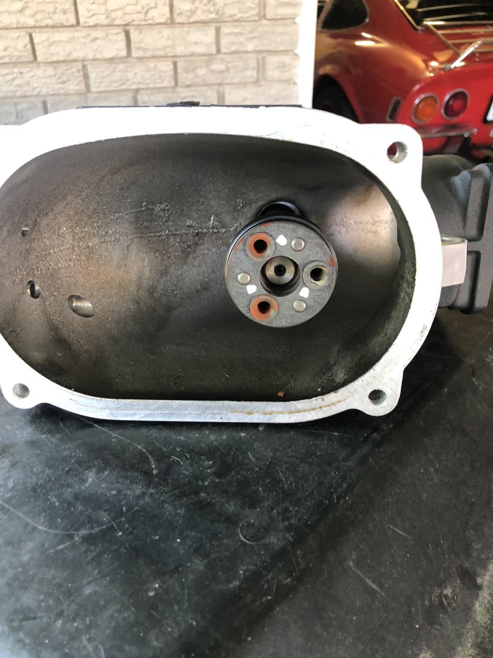

    no it wasn’t that it was one I’ve never heard. I’ll have to try and record it if it appears again. I did go back a few pages here and someone had a rattle noise. Could be that same noise I heard.

    Next time you hear it listen very closely around the engine bay. Mine was a faulty nose cone drive. You could hear the marble in tin can sound around the SC pulley. If that’s it it’s not a terrible repair. Just takes an hour or two.

    By your pics you posted doesn’t look bad. I’ll definitely keep an ear out for it. Thanks
