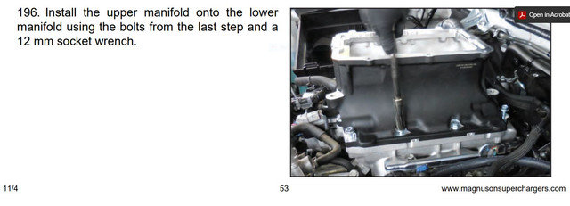

    Heavy Dupree
    Heavy Dupree Member
    Nov 8, 2020
    #346162
    17
    2020 Tacoma TRD Sport AT Access Cab VooDoo Blue
    3" lift, 285/70r17, 4.88, Bilstein 5100s, Icon UCAs, Ripp coil packs, Afe catted downpipes, URD Spec-U w/dual exhaust.
    Unless the OEM upper (with the ACIS) and lower intake manifolds are both removed and replaced, correct?

    #100
    OpelGT
    OpelGT hOPELess Power
    May 6, 2018
    #252678
    558
    Texas
    2018 TRD OR Tacoma MT, Magnuson Supercharged
    ACIS is gone with this kit.
    Heavy Dupree[QUOTED] likes this.
