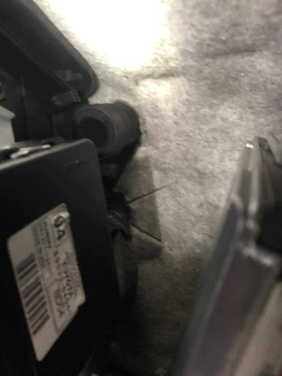

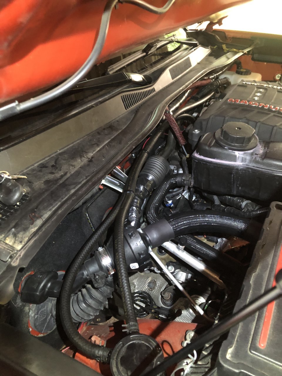

    i watched the video just now. Actually I was the first to do this mod a couple months ago. I briefly swapped out my homemade mustang sound tube for this universal fosters sc mod. I immediately ripped it back out and said NOPE.
    it sounded exactly like a kazoo in my car and brought in TONS of other undesirable noises. Adding the muffler from the mustang sound tube helped, but ultimately I cannibalized the larger hose from the foster kit and added it to my mustang sound tube and it’s perfect for me.
    I wish I had a video. The intake noise was hilarious in person. I took one drive around the block and removed it faster than any other mod I’ve ever done lol.
    here it is enjoying its 15 minutes of existing behind my ECM before it was repurposed into spare parts.
    this is what’s on my truck now. It sounds much more realistic compared to the floor kazoo I had from fosters.
    MGMSangTaco likes this.
