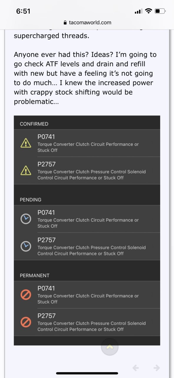

    I finally checked my AT fluid a few weeks back (dealer told me they had done a drain and flush at my 35k service) and it was almost a full quart low and looked disgusting. Not completely burnt up per say but nasty. Good thing I never go to dealers anymore. I did a drain and flush like you had recommended and added some lubeguard in (as recommended by @gearcruncher who knows his stuff), and it's definitely driving way better and smoother all around. Still hunting at higher speeds but not as bad. I monitored my trans temps at highway speeds right before the change and was ranging 195-220. After the change and fill to correct specs it sits 195-200ish max.
    I am too nervous to try the cruise up a steep grade above 70 mph again though after throwing a CEL 3 times. I'm going to measure driveshaft angles etc later today (I have Deaver Stage 3's on it, and a GFC) which might have been why I had some slippage then. Need to get this all dialed before I hit a dyno etc.

    what codes were you throwing for CEL? Why did it trip?

    Unsure to the answers. Flushing the AT fluid with the proper levels and lube guard helped around town but I’m hesitant to take it above 75. Only would happen when in cruise and going up hill over 76 mph which is strange. I did also replace my AAL pack with deaver stage 3’s and a GFC which could have contributed to drive shaft angles being off or something, or potentially it was fueling (I’m in CO too). Lots of variables and I’ll report back when I get a chance to check my drive shaft angles and correct them if needed.

    How long have you have the tune? Did you reset your dtc’s and learning values? To be fair the stock tune does this as well with a ton of trucks but tuning made it better for the most part. After I reset my values it drove like absolute garbage for about 25 miles (similar to the NA tune regardless how good it is).
