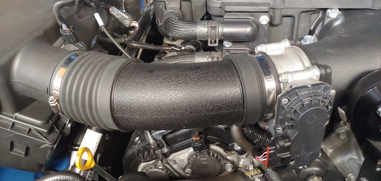

    WRT the Mag-SC, there's some info I've been trying to figure out: if the MAF/housing is replaced/larger than stock and if so, what the diameter is. Hopefully somebody here with the kit can help me out with this info, or at least if someone happens to know.
    A Mag-SC owner mentioned something to me about the IAT sensor having been moved post-intercooler, which makes sense, but I'm assuming Magnuson kept it maf-based and left the MAF in relatively the same location? Idk.
    Thanks in advance guys.

    the connecting points are OEM with regard to diameter and location - nothing really changed MAF or other. Only piece terminated is the ACI.
    mZiggy[QUOTED] likes this.
  10. Oct 14, 2021 at 12:23 PM
    #1190
    mZiggy
    mZiggy Honey badger
    Apr 8, 2017
    #215707
    4,709
    Marc
    2020 MGM Tundra SR5; 2020 4R TRD Pro; 2008 4R SR5 v8
    Thanks man.
  11. Oct 14, 2021 at 12:39 PM
    #1191
    GoldenBrew
    GoldenBrew Insufficient Privilege
    Dec 18, 2016
    #205159
    2,755
    Golden, Colorado
    Gen3 4X4 TRD OR AT - SOLD not Forgotten
    Pic fyi.
    reymataco and mZiggy[QUOTED] like this.

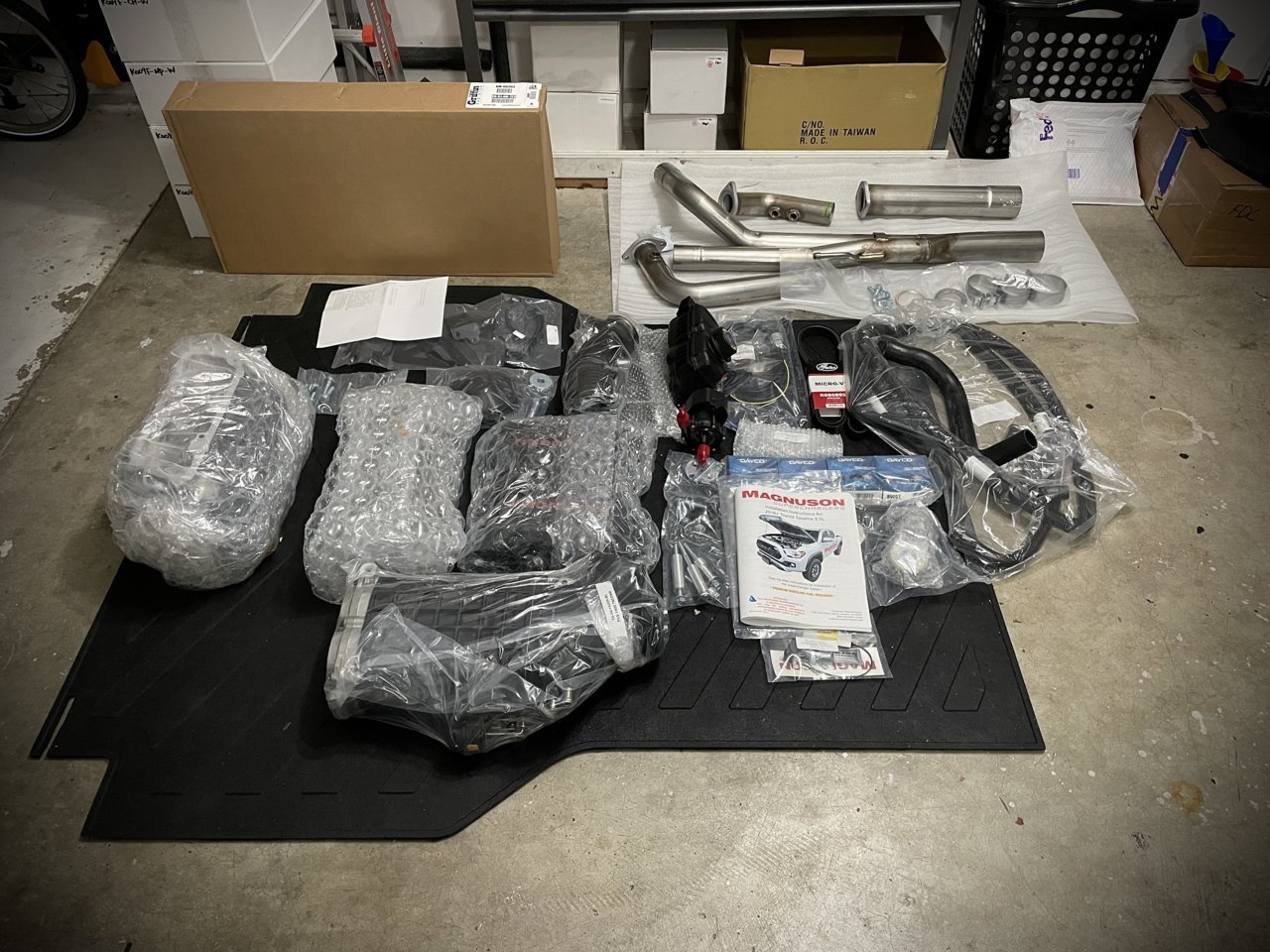

    Got the notification yesterday that my Magnuson supercharger shipped from URD! So I’m guessing Gadget has a few in stock. Of course FedEx already delayed the shipment ETA… LOL
    Oil, filter, coolant, plugs, boost gauge, 90 degree aluminum NPT fitting, strap wrench, torque wrench, hose cutter, and a partridge in a pear tree all ready to go!

    Ok so everything looks to be here. Question for you guys that recently installed one of these.
    I went through the steps, downloaded the VF software and driver, went back to Magnuson and filled out calibration form 1 and 2. They responded very quickly and within a few hours I got the calibration file. It says next step is to connect the ECU and flash the calibration. Just want to confirm that this is indeed the last step on the tuning side. I read somewhere in this thread or the other that I have to email VF tune? Was that during the early stages?

    No, you only have to email Magnuson. vFtuner only provides the software to Magnuson for the tune. They have nothing to do with magnuson's tune for the kit.
