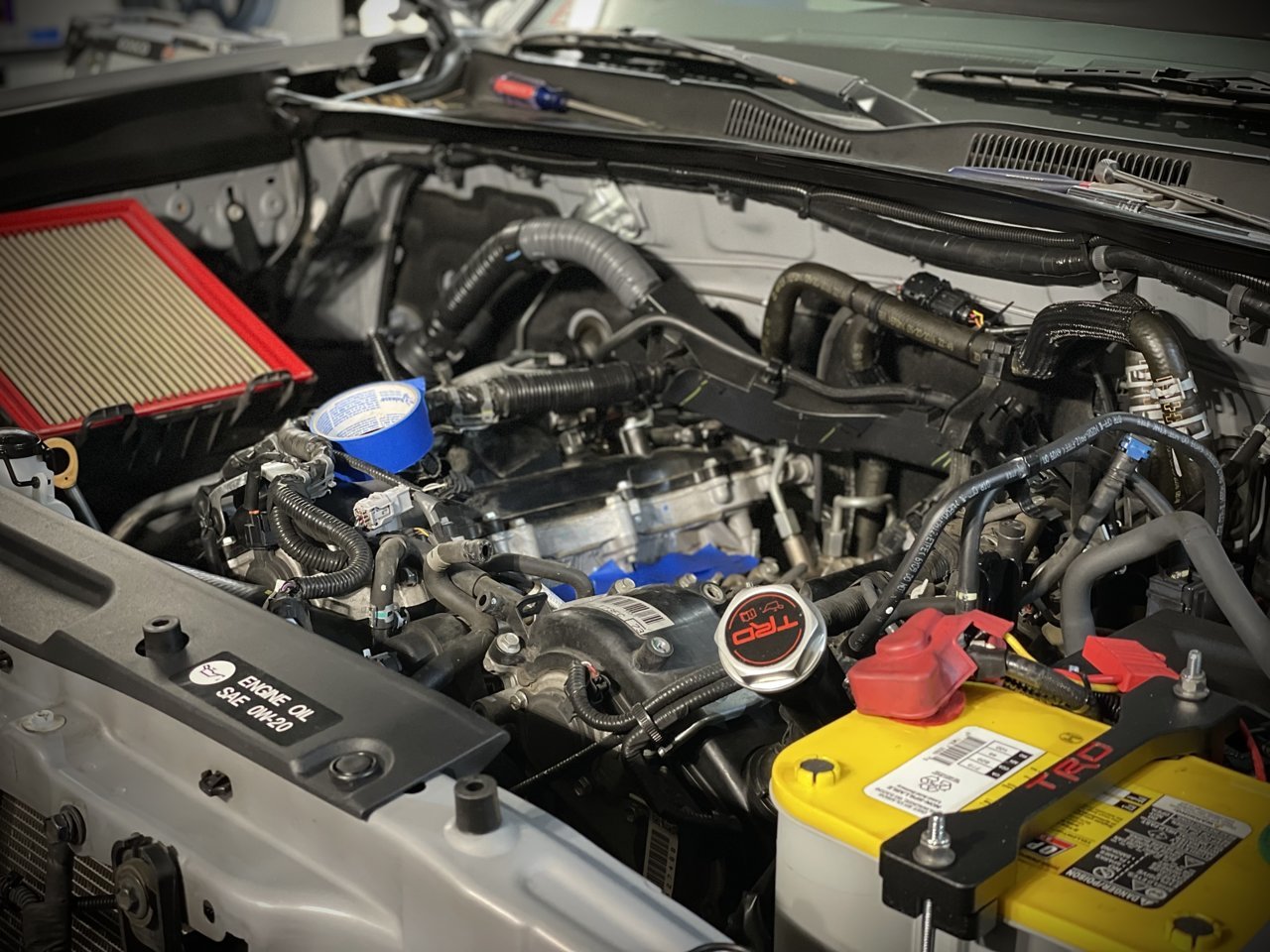

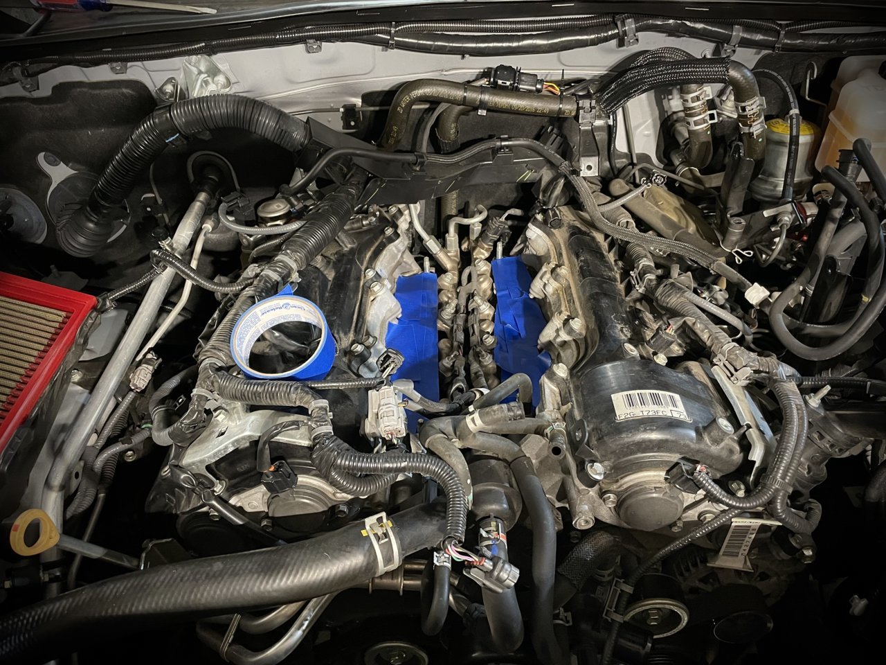

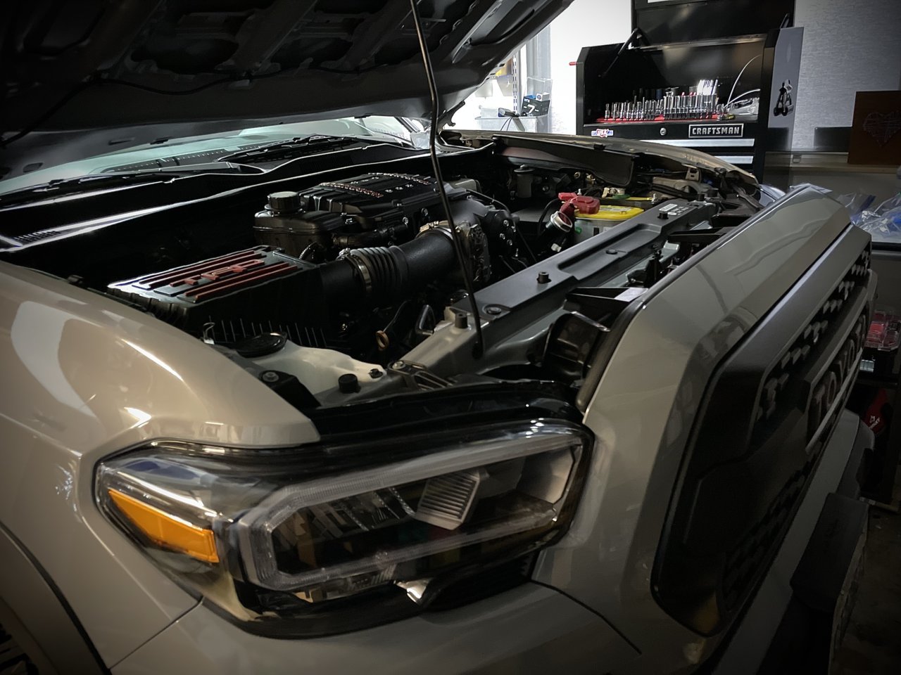

    My buddy Ed helped me install this thing yesterday. 7-8 hours? Gonna call bullshit on that one. Maybe on a brand new Tacoma with two experienced installers cutting half the instructions out. The instructions were very well done. We ran into issues getting the crank pulley off, (pulley holder bolts bent, had to bump start with breaker bar resting on frame… fyi Toyota engine rotates clockwise facing the crank pulley from the front), torquing the crank pulley down, etc. The total time was 15 hours. This includes draining the oil, changing the filter, draining coolant, removing the radiator, (to get an impact onto the crank pulley which ended up failing anyway), changing spark plugs, (bitch to get some of the coil packs out), cleaning some sludge out of the runners under the lower intake manifold, (catch can highly recommended), filling oil, filling coolant, burping the system at the end. There are definitely steps in that 260+ step install manual that I think folks are omitting when they say 7-8 hours install time. Anyways, had a blast! Not quite sure why folks complain about the power bump. It’s definitely an improvement over stock.

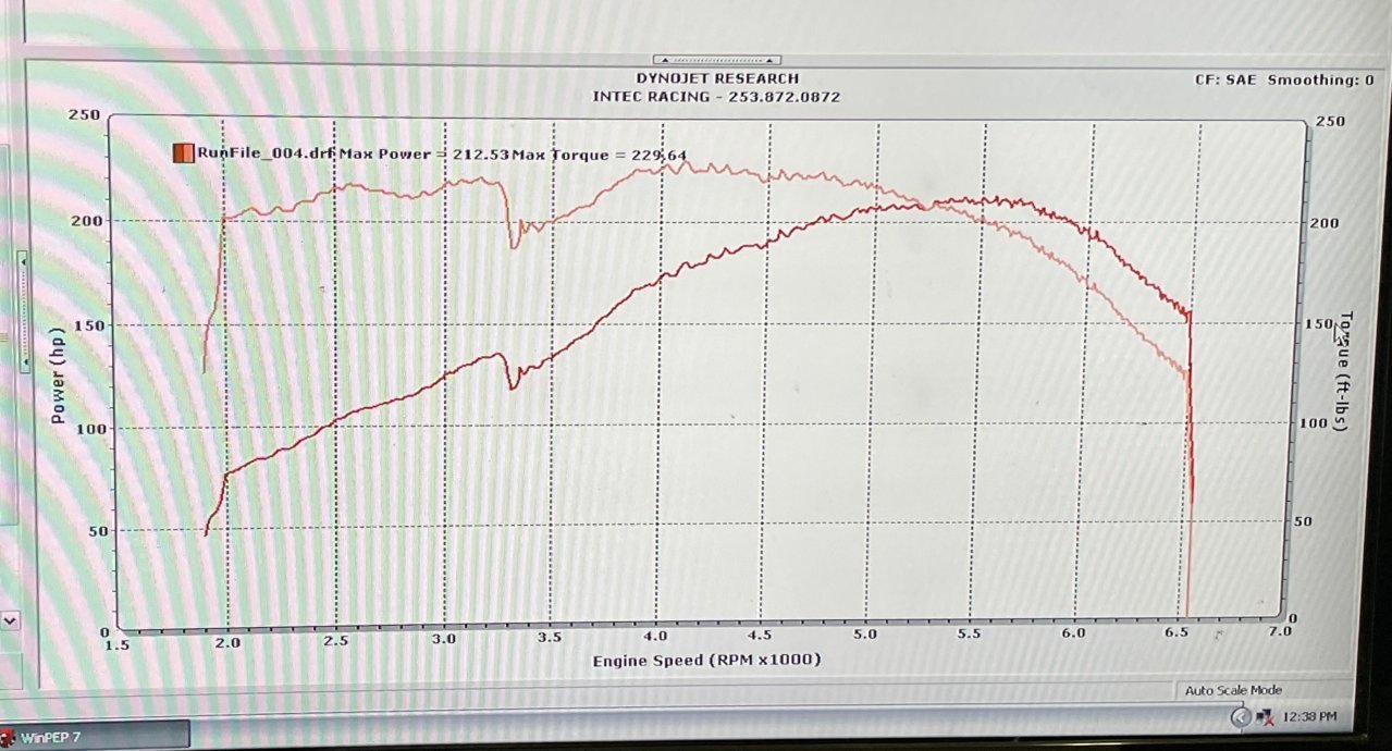

    That was the plan. The pulley was ordered when I ordered the supercharger. Unfortunately ETA is November per Magnuson. Doesn’t really matter. Will strap this to the dyno on Tuesday and when the pulley eventually gets here will swap the pulley and do another dyno run. The baseline dyno run without the supercharger on OV Tune 2.0 was done on Friday. Attached below.

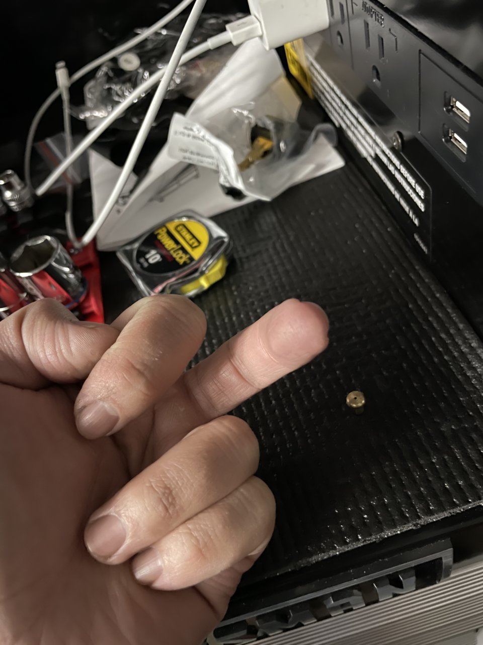

    Pulled the restrictor out of the bypass valve today. My review is summarized in the pic below but in a nutshell… hello partial throttle torque down low!
    :burnrubber:
    What I don’t get is this… The whole purpose of the bypass valve is to delay the onset of boost. It’s already delayed with the bladder valve functioning properly. My 3.4L had a malfunctioning bypass valve on the TRD and it would hit peak boost immediately 0-7 psi instantly. Driving around town like that is impractical. However this bypass valve works just fine so… Not sure why Magnuson would put a pretty significant restriction on top of an already effective existing restriction. My best guess is to further retain MPG’s during partial throttle. Sorry… that lame shit definitely needs to go!

    A/T trucks can have a real harsh engagement with them removed.

    Well as promised, strapped to the dyno. Suspect bad gas so will need a rematch.
    Supercharger: 274 WHP
    OV Tune 2.0: Made 215 WHP
