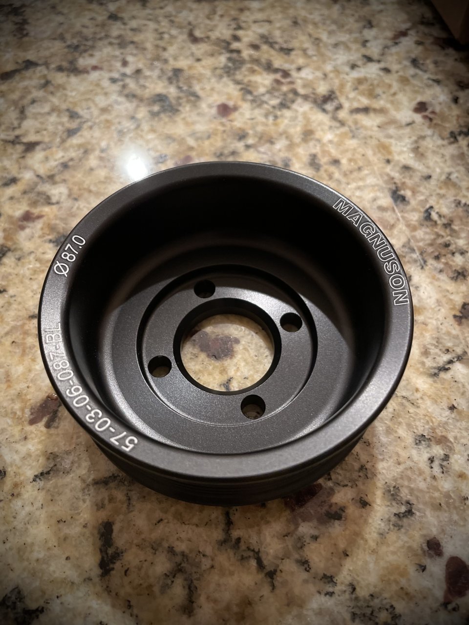

    Is there a link or part number for the 87mm pulley?
    I got it off the pulley: 57-03-06-087-BL

  13. Nov 18, 2021 at 9:38 PM
    #1353
    WaitingOnMyR1T
    WaitingOnMyR1T No longer waiting…
    Aug 5, 2020
    #336687
    3,396
    Josh
    Portland, Oregon
    2020 White TRD Pro - Magnuson S/C & Rivian R1S
  14. Nov 18, 2021 at 9:39 PM
    #1354
    Formidable
    Formidable Well-Known Member
    Jun 25, 2015
    #158158
    554
    2017 TRD PRO 6MT
    Haha you may want to have a buddy pick it up for you.
