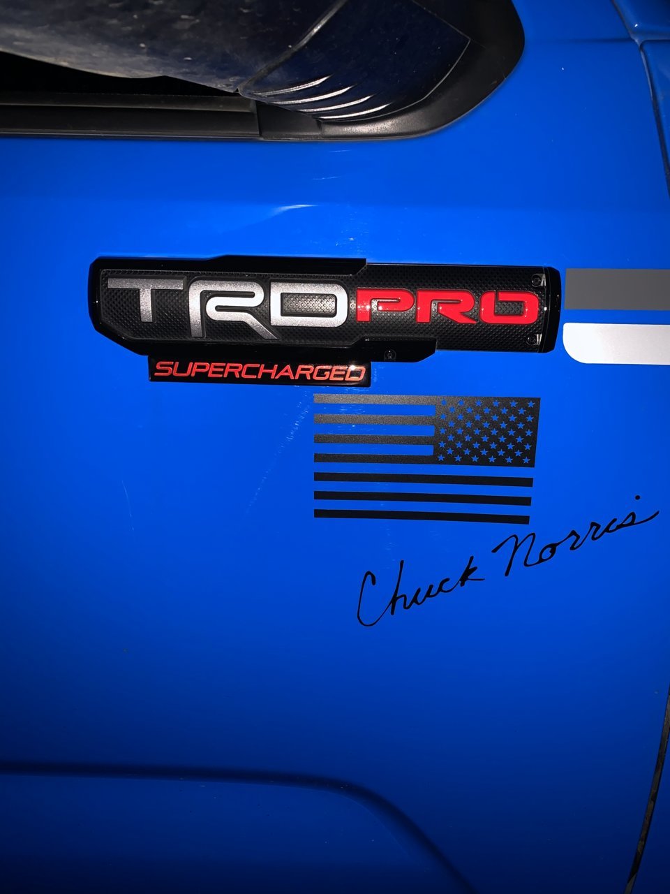

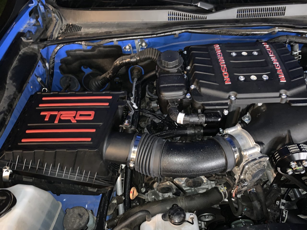

    Thanks to OpelGT I added the CAI.
    Than I added the SC badge
