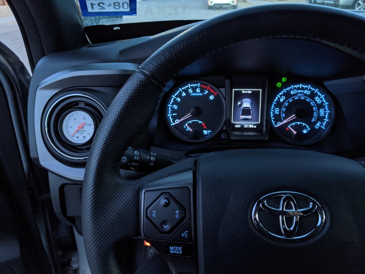

  15. Dec 5, 2021 at 6:07 PM
    #1435
    mZiggy
    mZiggy Honey badger
    Apr 8, 2017
    #215707
    4,709
    Marc
    2020 MGM Tundra SR5; 2020 4R TRD Pro; 2008 4R SR5 v8
    I had my boost gauge in the left driver side vent when I had my TT Tacoma.
    Got the mount from @Bigetaco22 worked out nicely there. Was nice to have to sorta out of the way but look over at it somewhat conveniently.
    I wouldn't recommend this type of setup for two gauges though, since your other vent would be taken up too. Air gets around it by design, so it remains functional, but still...
