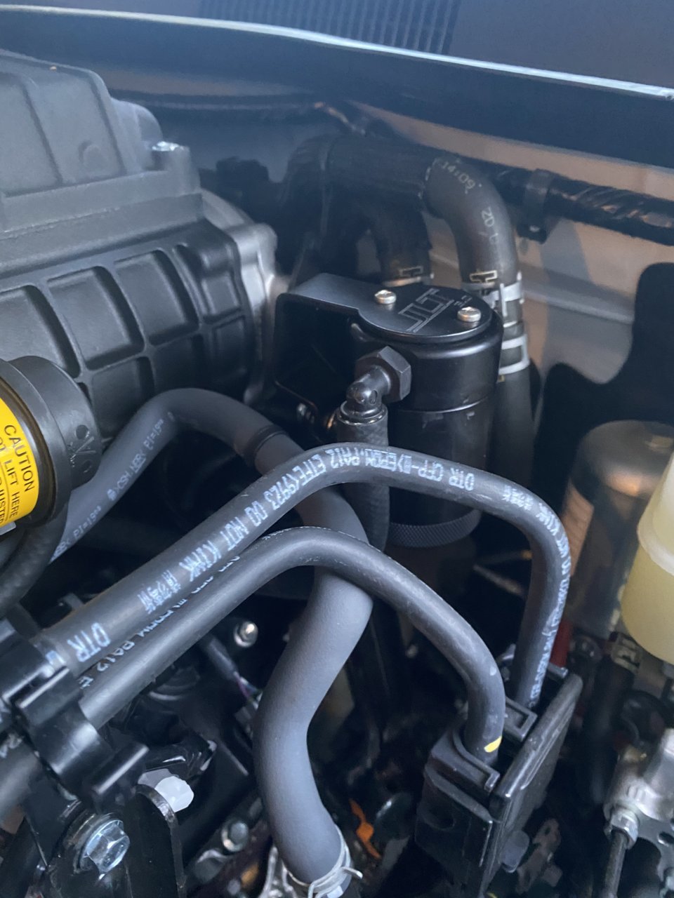

    I had the JLT kit on my Tacoma. Easy install. Can is a little small, but you should be fine checking it every 1-2k miles. Even with twin turbos, after 1k I didn't have much in there, but everyone's experience will be a bit different.

    That was on my list of possibilities along with the Moroso.
    Thanks guys.

    You can see how the JLT bracket was bent to work with the Magnuson.

    That sounds like the ticket. I'm going to get that ordered.
    I does look kinda tight though. Is it much of a hassle to empty?
