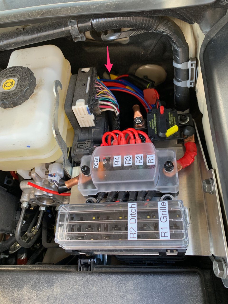

    How did you get them wired up? I already have wiring for accessories using up the firewall hole thats under the drivers side foot well. Will I need to punch a new port through the firewall?
    Formidable[QUOTED] likes this.

    #327210
    193
    Central East Coast, FL
    2020 TRD Pro w/ Mag SC & YotaWerx Tuned - 2003 DCSB & EXTCB
    Straight behind the battery, down on the firewall, there is a rubber grommet where the main harness goes through. Dont bother trying to squeeze it in there, very tight. I used a long screw driver, taped my wire to it, punched a hole through, and pulled it out on the other side. I mounted mine above the steering column which made wire management super easy.
    Formidable likes this.

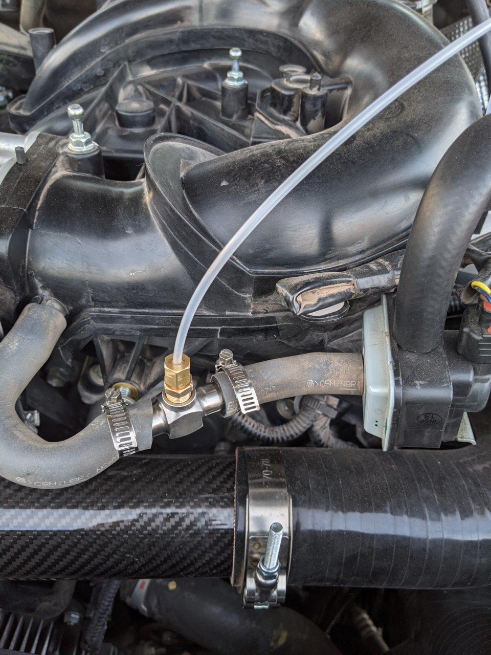

    I threaded through that firewall port for my lighting accessories as well as my boost gauge. Idk if this is the same for you guys with the Maggy kit but for the TTs I tapped here for my boost gauge
    Was a PITA to find the proper tee due to the sizes. That piece took me hours to track down online and cost like $15 lol can't remember the sizing, maybe @Turd Hawg does

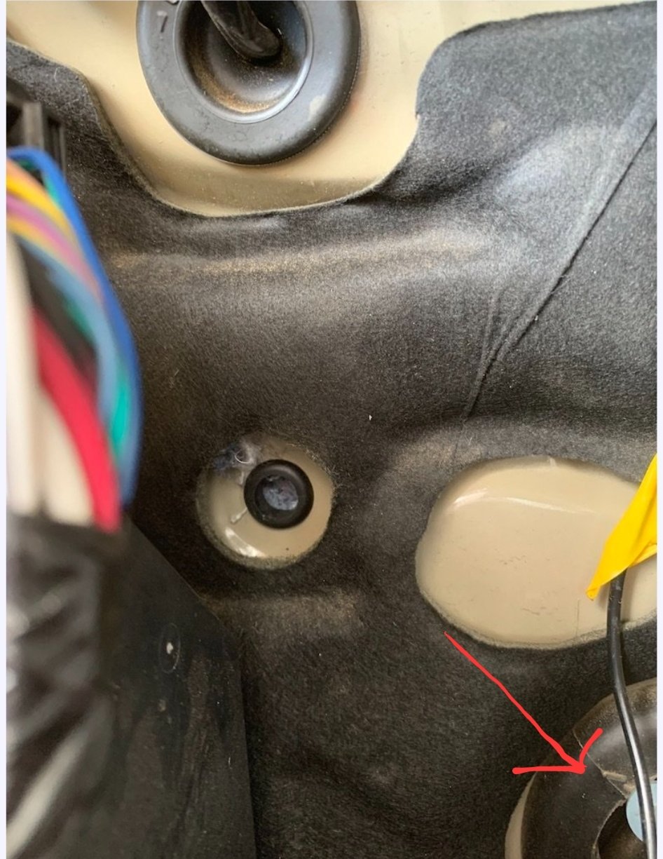

    This is the hole I am using for electronic accessories already. Need a different hole to run wires through the firewall for the gauges.
    I went through....

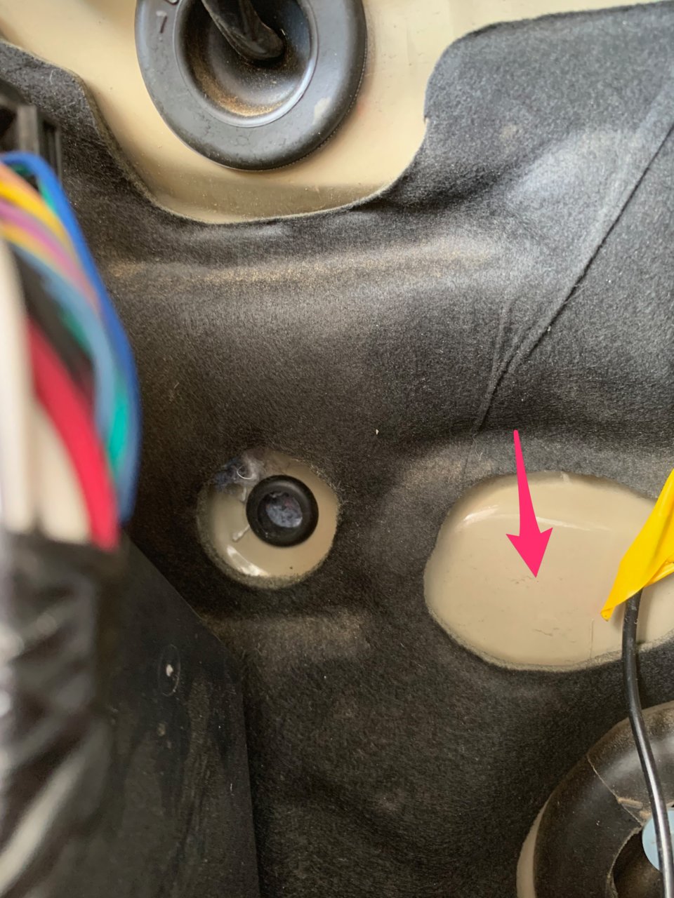

    I should probably punch a new hole right about here. RSG is doing the install. I'll have to have a chat with them about it.

    2020 MGM Tundra SR5; 2020 4R TRD Pro; 2008 4R SR5 v8
    Just cut a larger slit in the rubber below where where your arrow is and feed through there
