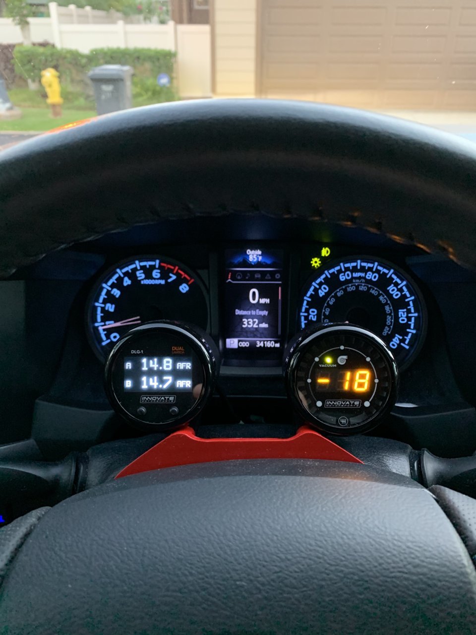

    I bought the innovative dual and a craven speed flexpod. Unfortunately the bezel for the innovative gauge is too large and it contacts the mount on the flexpod. Normal I would just file it down but it looks like it also would be cutting into the gauge itself. I can snap a pic tomorrow but it looks like I’ll be sending it back and probably picking up the same gauges that @Formidable has.

    It works if you file the mount down a bit. The bezel does still touch the mount a little, but I didn’t have to mod the bezel.

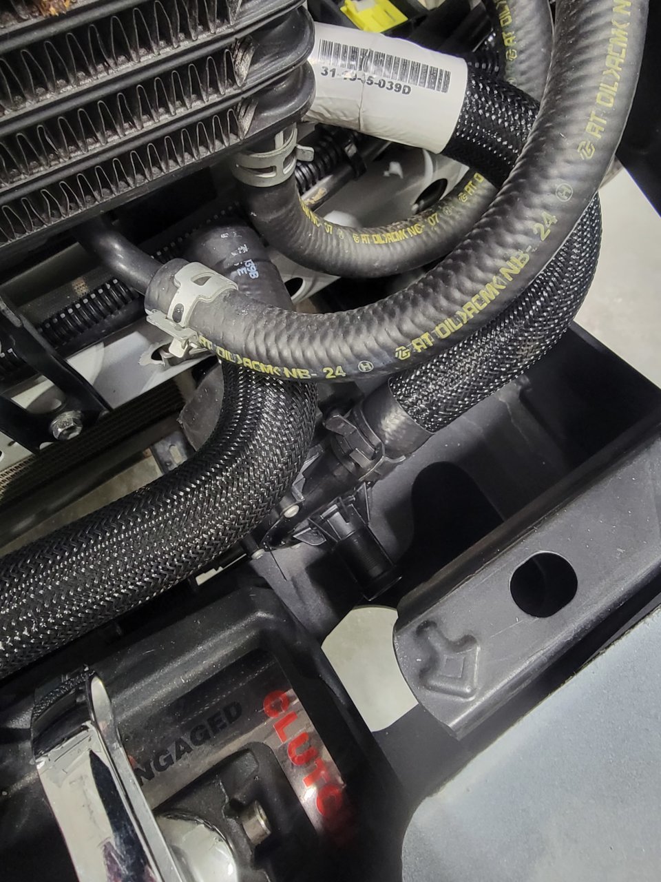

    How's everyone re plumbing the inlet hose to the pump if running bumper/winch? Have a silicone 90 and some couplings. Didn't know if anybody has found a 1 piece bend out there

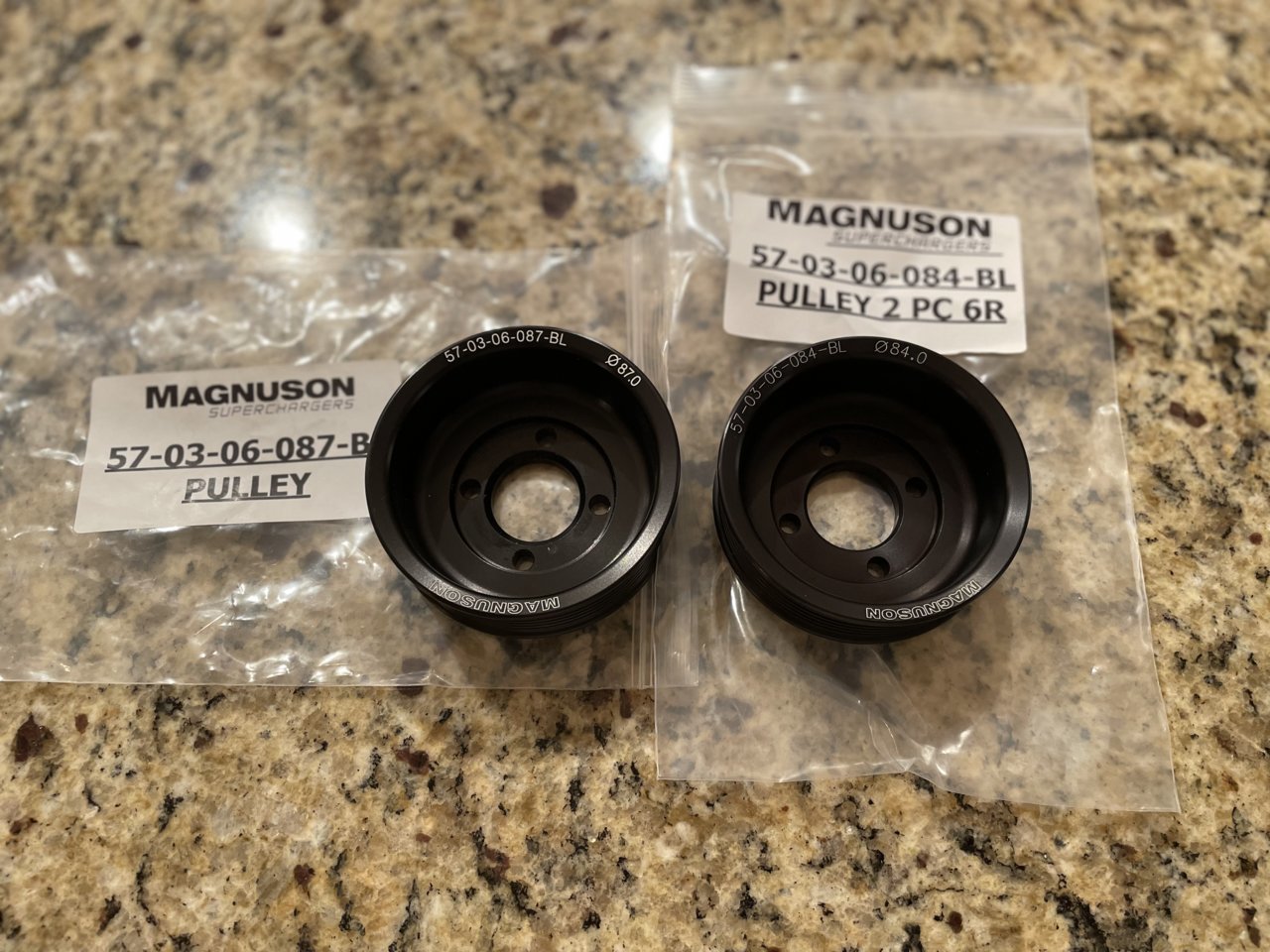

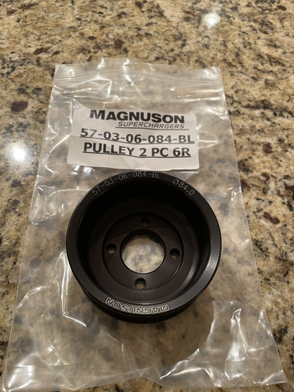

    One very promising thing about the Magnuson supercharger is that it is WAY oversized for this motor. If you look at how linear the dyno looks as it approaches redline… lots of room. The limit won’t be due to heat soak as was part of the problem on prior generations. The limit will be fuel. The Yotawerx tune allows us to run the smaller 87mm pulley safely… and the 84mm is ready to be installed for further testing.
    Few more things to iron out for the 90mm and we hope to get the 84mm up and running here soon.

    Are you needing to install a shorter belt for the smaller pulleys or is there enough adjustment in the tensioner to take up the slack?

    the 87 fits fine with no belt change. Haven’t tried the 84mm pulley yet.
