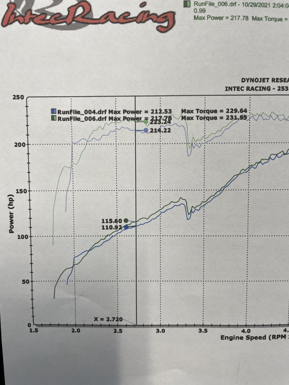

    Anyone here have the URD Y pipe and see any improvements?

    Magnuson Supercharger TRD Bilstein 6112/5610 w/ Head Strong 3 leaf AAL URD Mark 2 Y Pipe OV Tuned (pre Magnuson install) TRD Intake TRD Exhaust TRD Skid Plate TRD Shift Knob Leer 100XR Subaru Kicker Tweeters Toyota Bed Mat Kicker CS Door Speakers Kicker H8S Hideaway Sub Toyota All Weather Floor Liners Caliraised LED Bumper Light Bar De Badged Tint Console Organizer CMC with BAMF Plates 17” SCS Ray 10’s 285/70r17 Ridge Grapplers Faux PRO Grille Hondo Radio Knobs Accumulator Delete Mod URD Short Throw Shifter JLT Oil Separator MESO Ultimate Turn Signals MESO Map Lights MESO V2 Dual Color Dome Light RC Seat Covers Stoptech Slotted Rotors Sport Pads and Stainless Brake Hoses
    I have it. I don’t know if there is any difference. I would have to do another Dyno run. Before the Y pipe I had 308 to the wheels. Peak probably isn’t different but I’d bet there might be some more ponies somewhere else in the powerband.

    It’s a 9 WTQ gain down low 2-3200 rpm before the torque dip associated with ACIS. This is noticeable driving around town. The peak WHP gain was only 5 but the torque you definitely feel. This was on OV tune 2.0. Y pipe was installed and run same day as baseline dyno. Prob a bit more gain with supercharger.

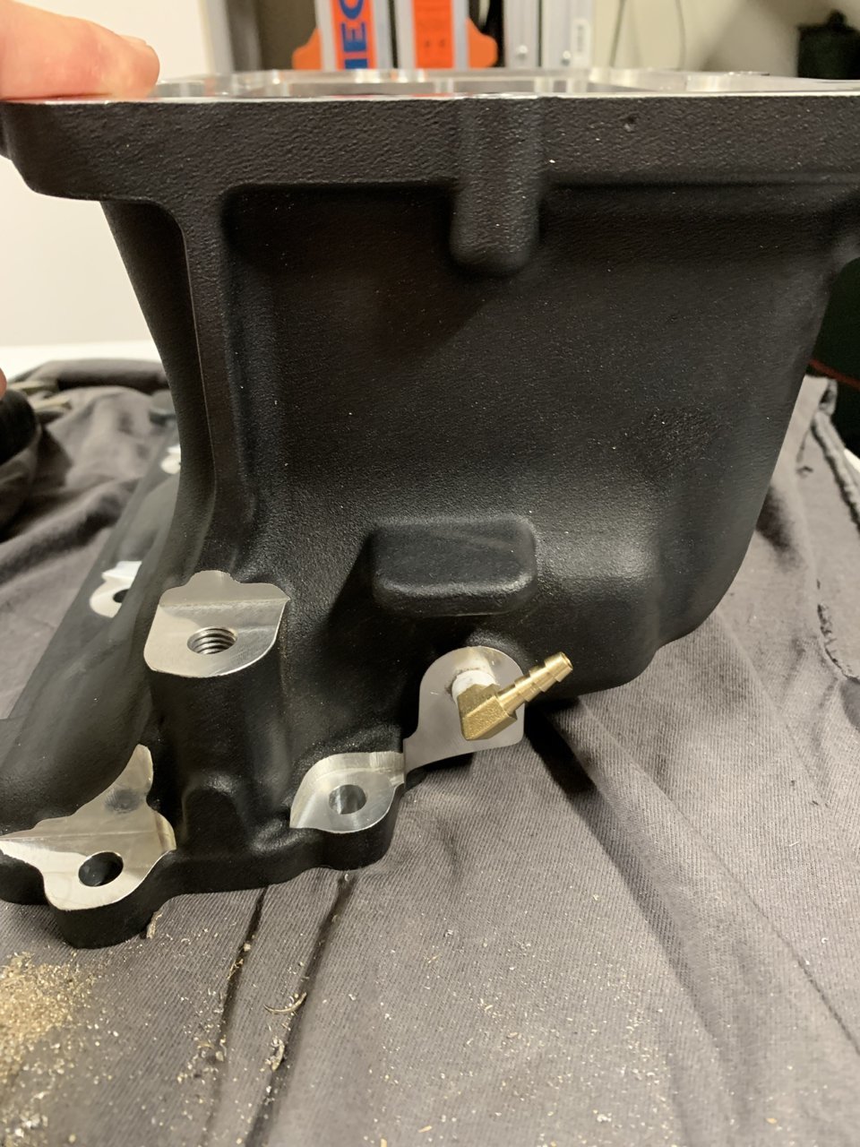

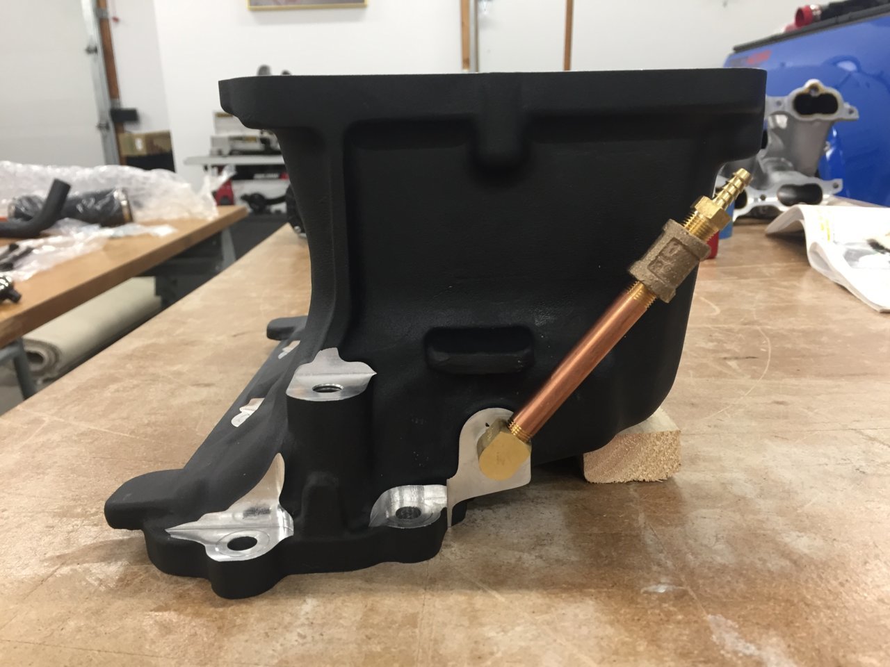

    I'm installing a 90° fitting on the back of the upper intake for a boost gauge later.
    Can anyone comment on the orientation of the fitting?
    I'm assuming it would be best at 45° like the attached picture to get between a casting tab and the mounting hole?

    That looks correct. You want to try get the straight 1/8 NPT male to 3/16 hose barb in before install.

    Now that I think about it, maybe it would be best to rotate that fitting 90 degrees and take it out the passenger side?
    The picture shows the tubing running behind the SC.

    Yes, I installed mine 90 degrees clockwise from that. Makes it easy to get to.

    I turned mine after that tab.

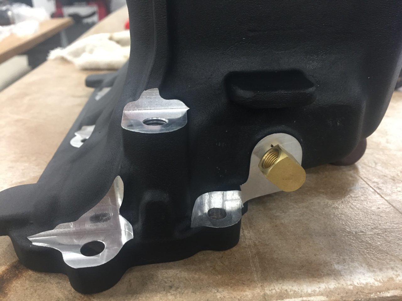

    One step further.

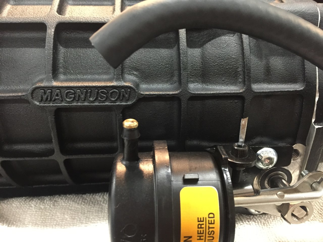

    1CF5A2DD-A33B-4880-AC6B-E4D0145EEE04.jpg Is the the restrictor everyone is removing?
    This thing is NOT coming out, even grabbing it with needle nose pliers.
    I’m afraid I’m gonna break off the plastic port.
  15. Jan 16, 2022 at 10:14 AM

    Yes, that is it. I grabbed mine with small needle nose vise grips and twisted it out. Looks like there was some bonding agent on there holding it in place that you need to break loose.

    Ya, mine must’ve had more bonding agent cause it won’t come out, even with a heat gun. I break that port and I’m dead in the water! LOL

    Hold the plastic with a pair of pliers and grab the restrictor with pliers. Twist the brass restrictor while holding the plastic.
