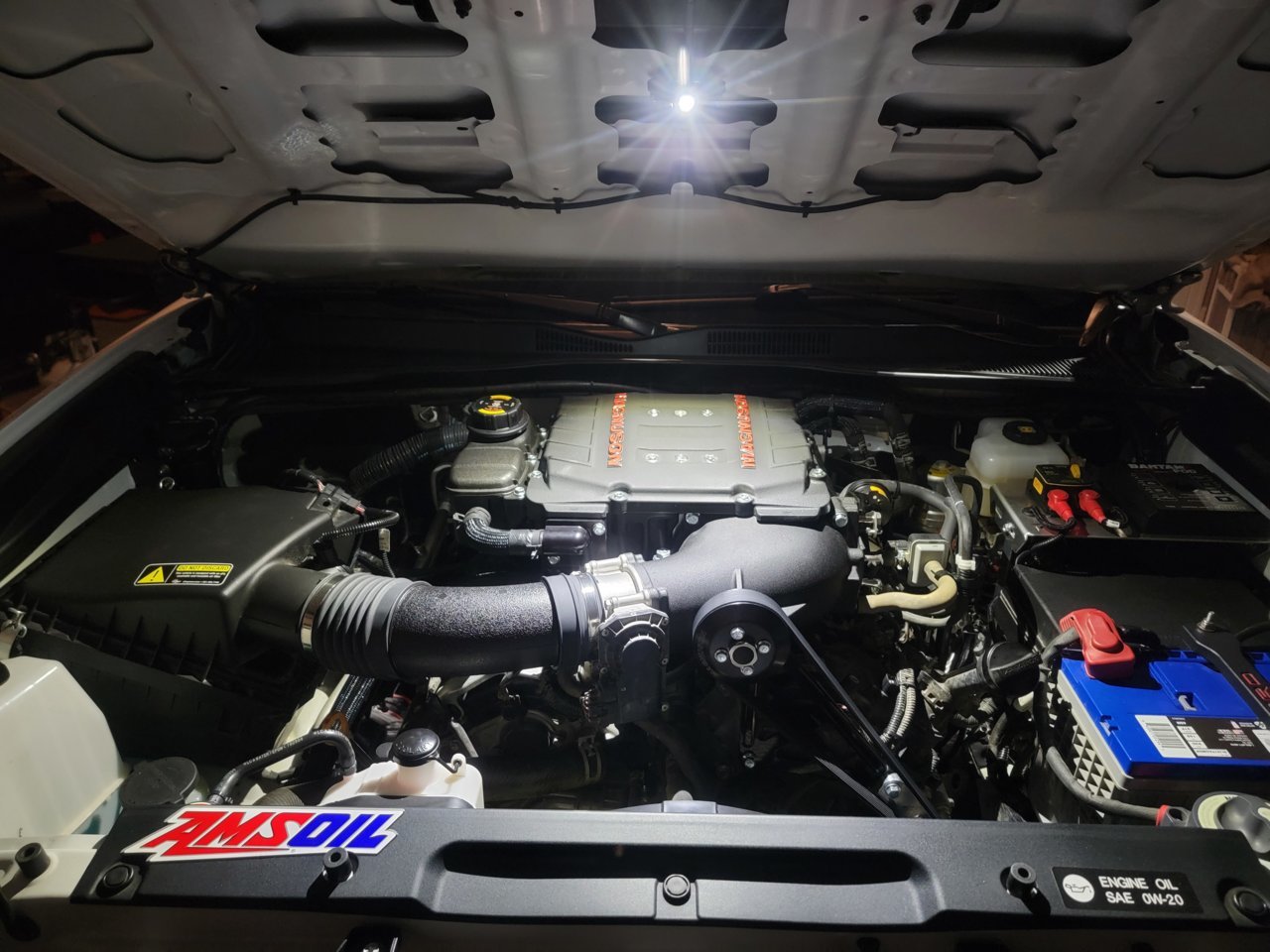

    Finally all together. Very pleased with the results coming from kdmax tune. Awaiting boost/afr gauge setup to monitor everything.

    Damn now i need to go wipe down my engine bay, yours is so clean!

    Not gonna use the Magnuson tune? Looks great!
