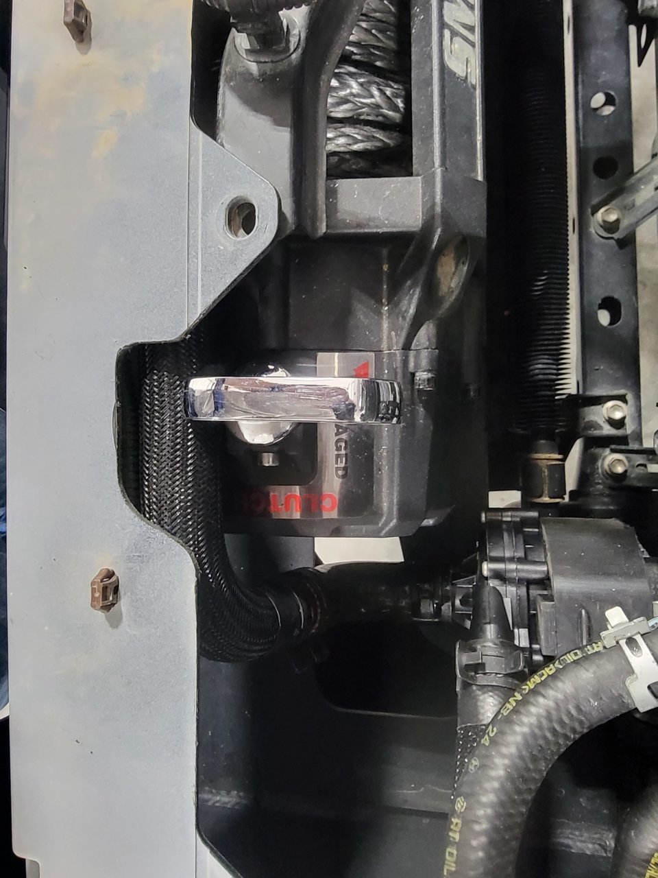

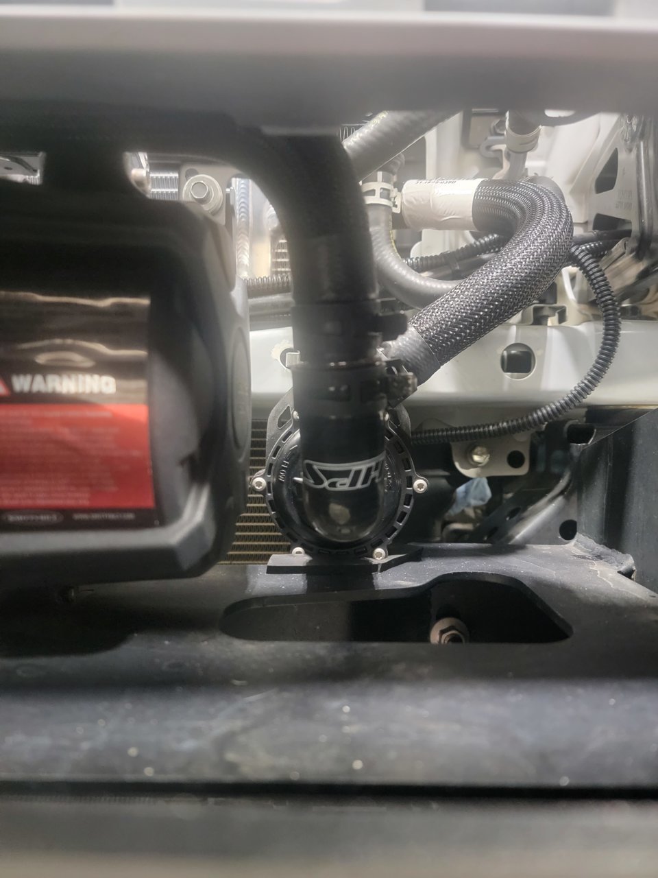

    My kit should be delivered tomorrow and I have everything else to do the install. I have a few questions:
    I have new sparkplugs, but only have 17000 miles on the truck. I see Magnuson says anything over 5000 should be changed in the instructions. Should I just pull one to inspect and change if needed or just change them?
    I have a winch bumper and see the coolant pump will have to be moved over to clear the winch. Is there enough hose to do that or will a piece need to be spliced in? If yes, what size hose is it and/or what parts are recommended?

    I would also like to know, awaiting the delivery of the front bumper next month and with the winch on its looking like it may not fit exactly. Looking at getting a radiator style hose with a sleeve on it as a potential replacement to that lengthy hose from the pump to the reservoir. I’m pretty certain I’ll have to cross that bridge right at that moment of install And then have to refill the reservoir with coolant as well.
    Any tips are much appreciated.

    Here's how I routed mine. Moved pump over about 4" with rivnut. Added a short silicone (3/4" ID) 90 degree elbow and coupling. I'm sure there's other ways to do it.

    Very helpful pictures. Thank you
