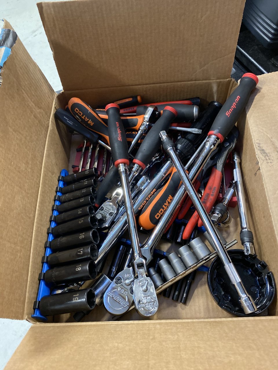

    Having a lift helps. I removed my wheels and tires to get the truck closer to the ground. I was still hunched over the truck for a solid day but it made it easier. Mine was done almost 80% with hand tools and I had 3 torque wrenches that were preset to the most common torque values so I wasn’t constantly switching back and forth. I used the tools shown below an m18 Milwaukee impact to get the crank bolt out and an m12 ratchet to help with final assembly as I wanted to be done by closing time. 0CBD1DA5-1FA6-453E-A64D-ED40C6CBD34E.jpg

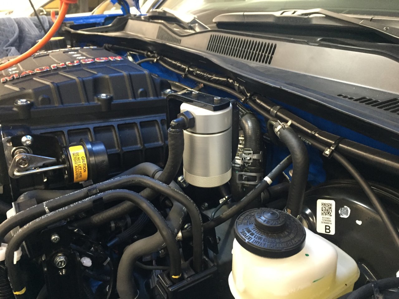

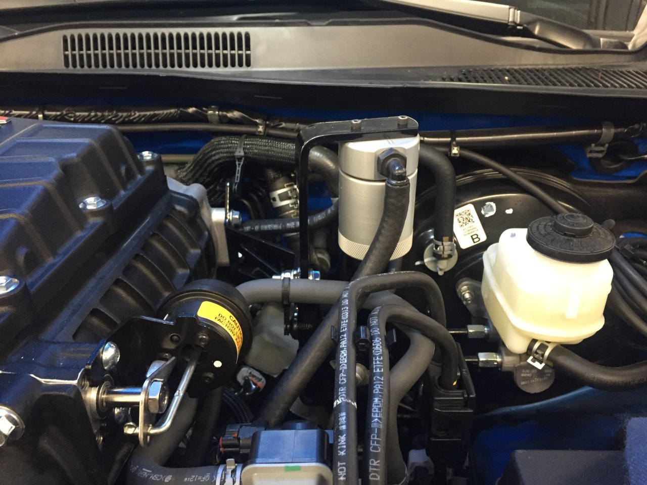

    Wrapped mine up today too.
    I also made a bracket to get the catch can a little higher so it’s easier to reach.

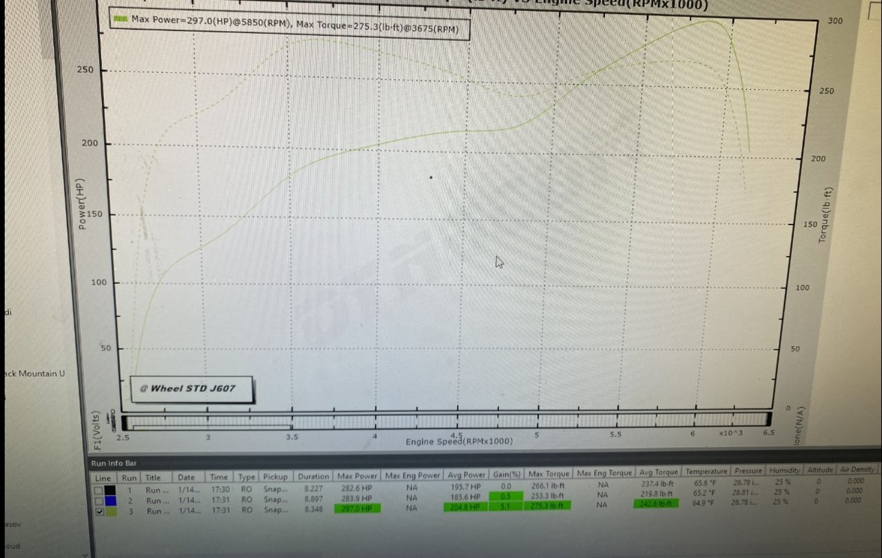

    Put mine on the dyno last week. It’s in the video, starts at 1:33
    https://youtu.be/rsysOeseYoE
    please excuse the terrible picture by the way

    That mid-rpm torque dip though...

    Yeah not sure why :confused:

    It's a combination of a couple of things.
    The YW tune addresses this.

    Lol @mZiggy knows the reason and addresses this torque dip with his Yotawerx tune.
