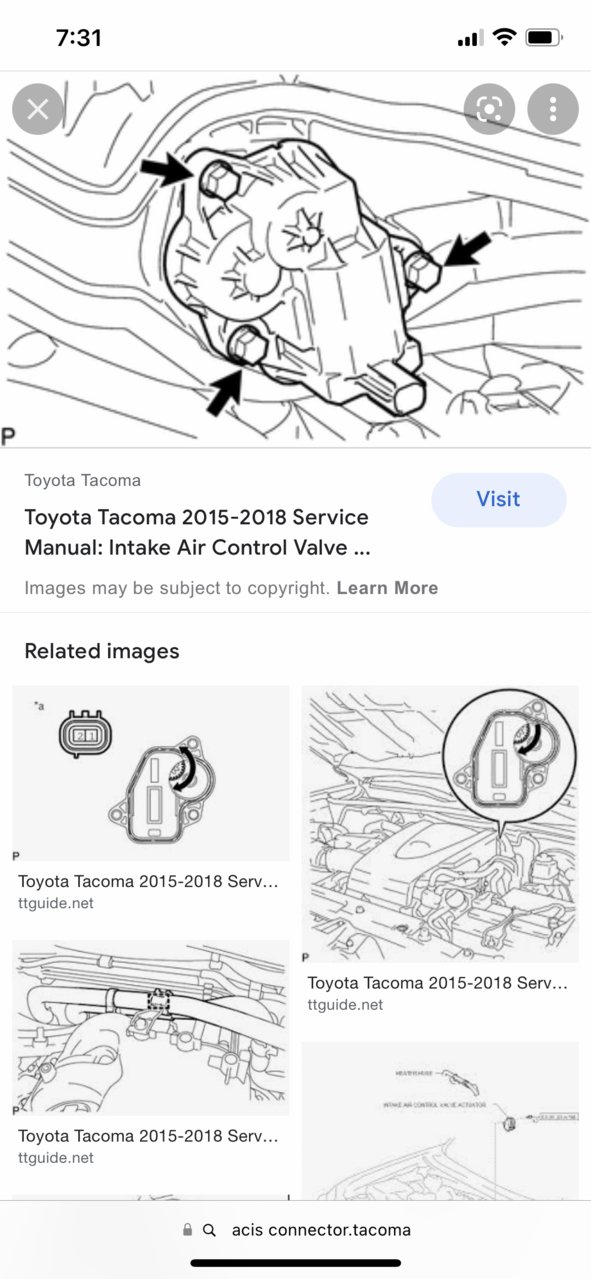

    The intake manifold tuning valve control likely references the ACIS system. What did they do with the ACIS plug?

    Hard to say. If it is referring to the runners, it would be related to the acis

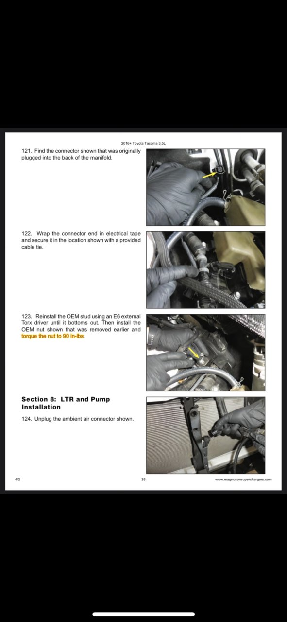

    Yes it’s safe to drive it back to them. Have them reread the following directions and locate the ACIS plug.

    No idea. I've read to leave it in on the ATs because its boost engagement kick-in is too hard otherwise?

    So the instructions say to leave the ACIS plug unplugged with the Magnuson install, yeah? So, if this code is being thrown and its from the ACIS, it would be because they plugged the ACIS plug back in? Just making sure I follow, because I could probably go unplug a plug, assuming its reasonably accessible.

    My guess? They probably plugged the ACIS plug into somewhere it shouldn’t be. Or they did something other than just tape it off as the instructions state.

    There is no ACIS unit when you install the supercharger. But it is possible they did something funky to the plug itself, crimped or cut the wires, plugged it into another plug off the engine harness or some other nonsense. Check the back of the intake manifold that they should have returned to you. Might find the plug still inserted with the wires cut. Lol

    The fault for the acis P0660-14 will pop up any time you pull faults. The system is no longer present, however it will not set a light by itself. I'm guessing you have an exhaust leak that is causing all your issues.
