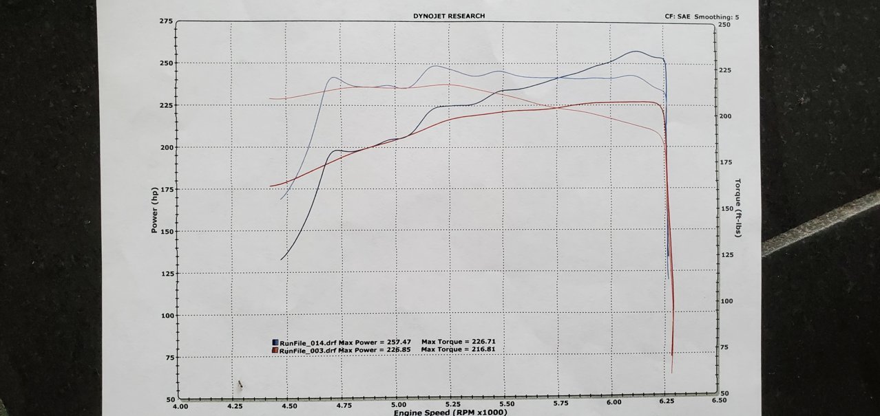

    I'm surprised at your gains with their Spec-U exhaust...I got a gain of 30hp/10ftlbs on my non supercharged truck (stock size tires for dyno). Are you running larger tires and regeared?

    That’s a ridiculous gain for an exhaust NA. Was the dyno done on the same day? Same dyno? Same gear? Same tune? I dyno’d their Y pipe NA and it did 9 WTQ. No retuning. Same gear. Just bolt on while on the dyno and go. Removing the rear cats is where the majority of the gains are. The gains for the system on the supercharger is as expected. Again, installed this spec u system while the truck was on the dyno. @tonered can verify this as he saw the system getting installed at intec.
    Running 295 MT. Not regeared.

    Same dyno, same tune, both 3rd gear runs, done a few days apart to give the ECU a couple miles to adjust for the exhaust but the SoCal weather was exactly the same. Low 60's both days.
    This is stock vs URD Spec-U and AFE Intake. I believe the dyno for AFE intake alone was 235hp/208TQ...so Spec-U gains were 22hp/18tq. This was on stock tune, so unfortunately no gear lock which is why it starts so high in the rpm range.
    Running a higher flowing muffler with a turndown than what the Spec-U came with, but I doubt that makes any difference aside from being way louder.

    Was the baseline done with no tune and the follow up done with a tune? Was the stock y pipe or exhaust damaged in any way prior to the baseline run somehow artificially decreasing that number? It’s an exhaust… Not a 50 shot nitrous. Lol

    All runs done on stock tune, wheels and tires. I just got flashed with KDM Pro recently but haven't been back to the dyno with that yet. Truck had ~10k miles on it when those runs were done, no damage to stock exhaust system.
