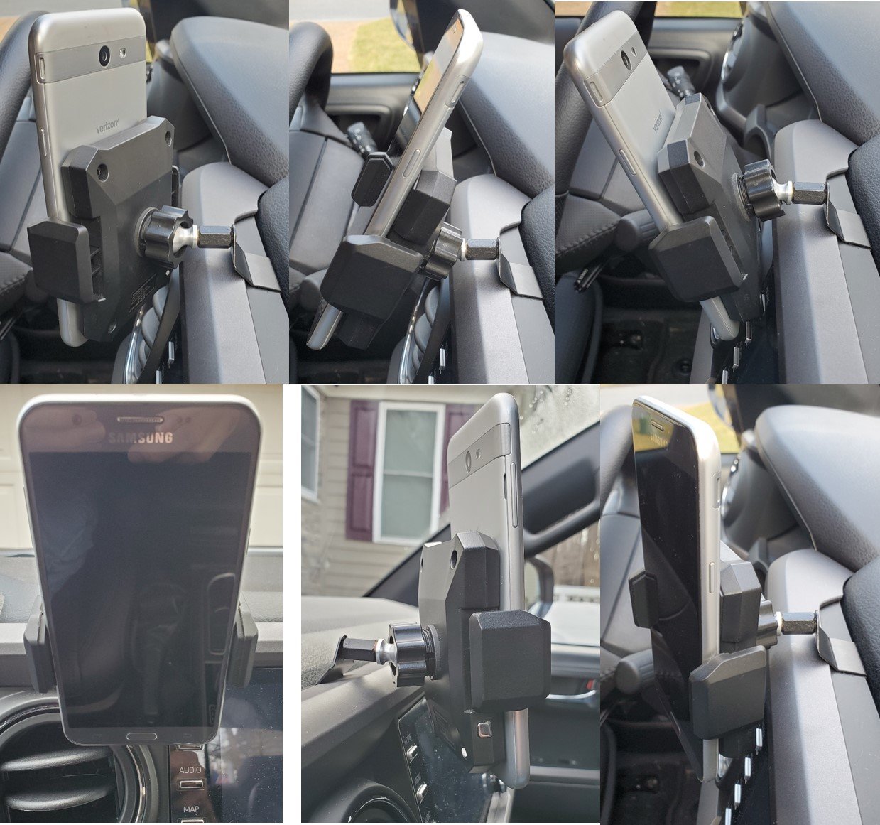

    With the small extension I put on, the phone can swivel to the full capability of the ball mount.

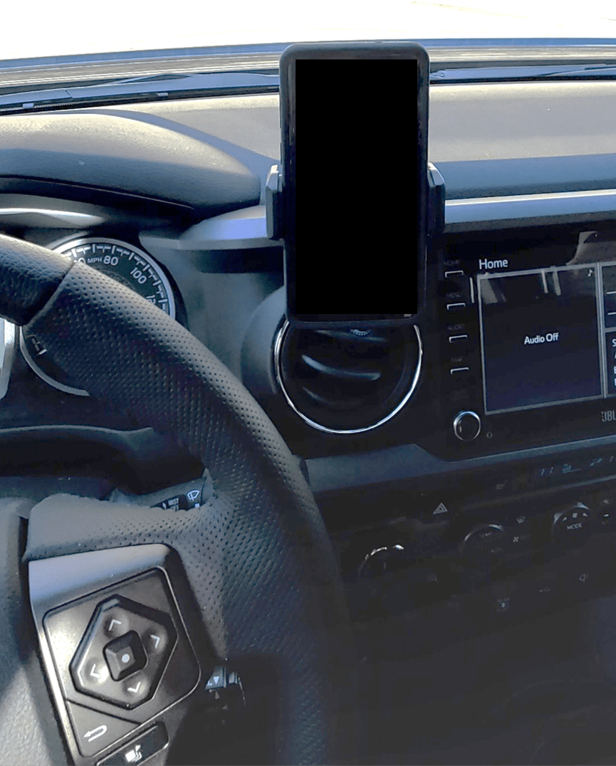

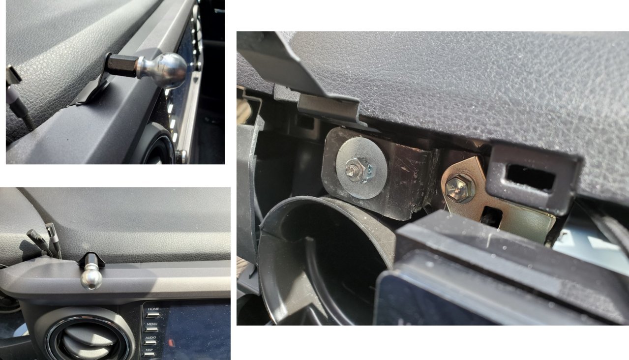

    I really didn't like not being able to see or easily reach the left hand buttons of the factory radio I had to make another mod to the Course Motorsports bracket. I took a flat bracket and shaped is so that I could attach the right side of the bracket to the top left bolt of the radio (where Course Motorsports designed their bracket to fit). I then took the Course Motorsports bracket and attached it to the left side of the bracket I made using a screw, nut, washer and lock washer. I put a couple bends in my bracket to follow curve of the area behind the bezel. The end result is the Course Motorsports bracket now sits a couple of inches to the left and the cell phone no longer covers the radio buttons. With the extension I put on and with the relocation, I can now adjust the phone so there is no glare and it no longer covers the radio buttons.

    Can you post some photos of the extension that you added on the CM mount? Without the phone. And maybe some pics without the charger, so we can see how it attached to the mount. Thanks for your insight into all of this.

    I guess "extension" was the incorrect term here.
    I meant the flat bracket that allowed @Two Yutes to shift the mount over closer towards the driverside.

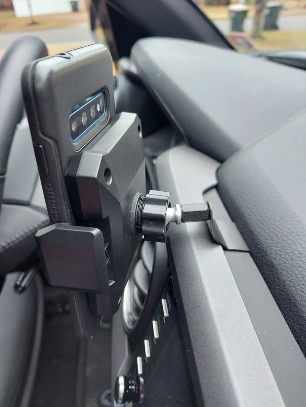

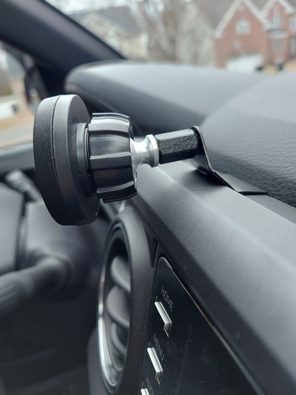

    Sorry for the delay, I was away from home and my truck for the last few weeks. Here are a couple of photos that show the additional bracket I created. I took the original bracket and had to cut it down and re-bend it at various locations so it would work in its new location just to the left of the original location. You can see scratched up bracket I created and how I attached the original bracket to it. Hope this helps

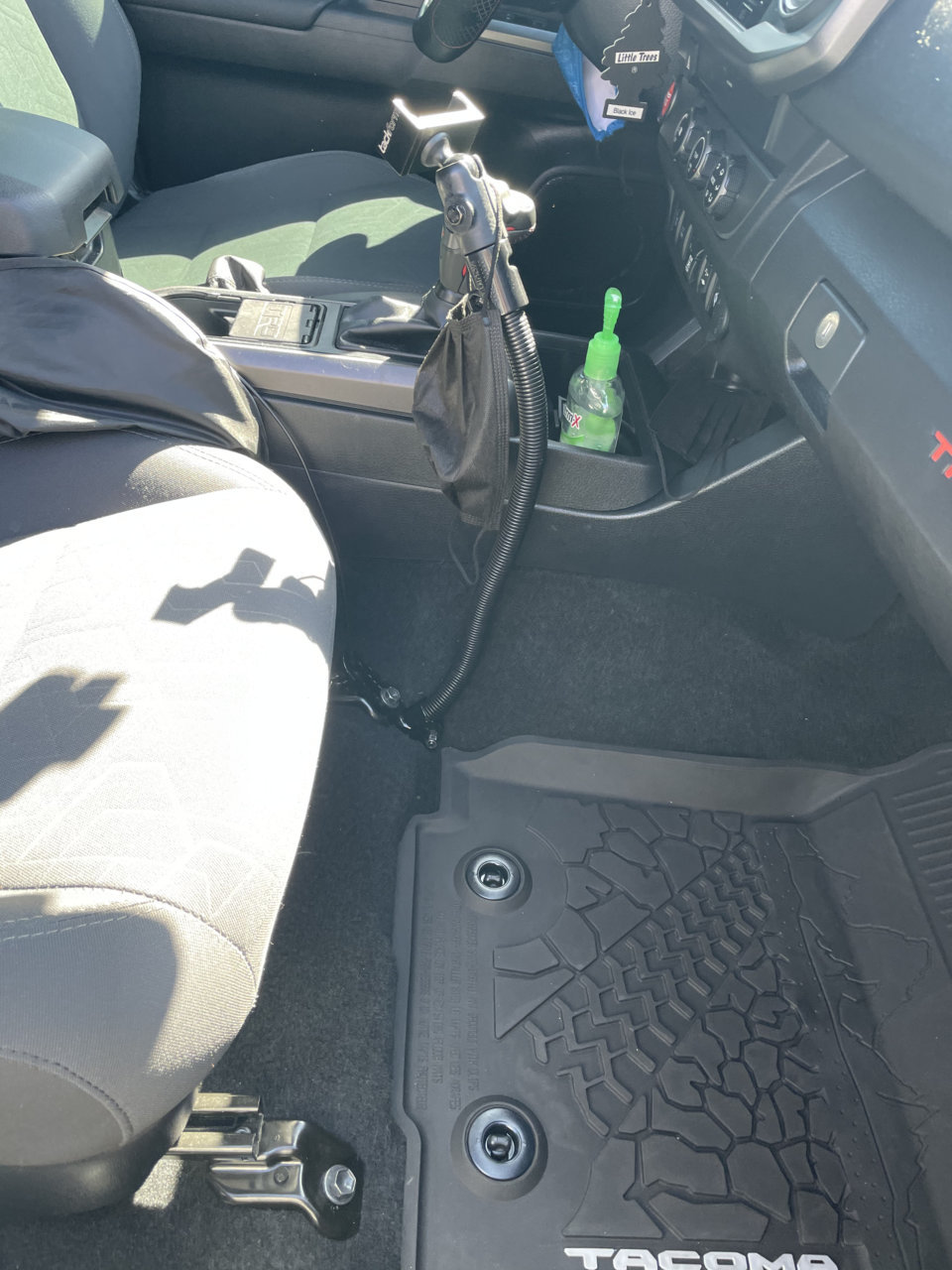

    63C288B2-DF44-4EB7-9F91-9A3DA28A40DA.jpg How does it perform with very heavy cases like a rock form?
    To me this would be perfect with a 1” ram ball. Where we can attach whatever we want extension arms etc. this is what I got rigged up but make one with a 1” ram ball and take my money. This is what I got rigged up

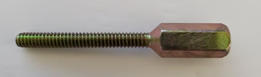

    I love your extension! Can I ask where you got the thread adaptor? I just ordered my CM phone mount and am thinking I also might need/want the adapter you used.
    "So I took a 10-32 RH Female thread adapter M5x1 and placed it in between the mount and the ball"

    Can you share the threaded extension you purchased for the phone mount? Im looking to find one but not sure what I am looking for - is this it? https://www.ebay.com/itm/163674102221
