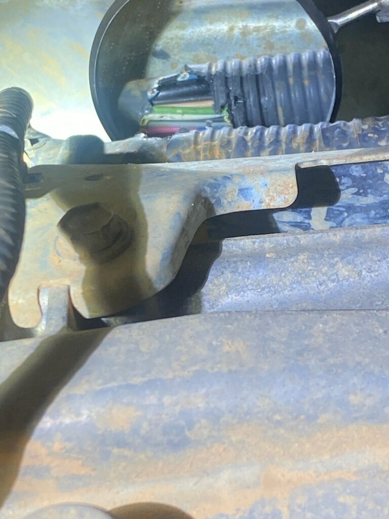

  17. Jun 14, 2023 at 2:53 PM
    #77
    wcoffman
    wcoffman Well-Known Member
    Jul 7, 2018
    #258631
    594
    '18 TRD Sport DCLB 4x4 SuperWhite
    Fr pass door handle replace, Tyger step rails and soft bed cover, DDSS3 fogs, TRD skid, OR front tow hook, SokieTech hood struts, fr seat covers (neoprene), metal oil filter housing, magnetic oil plug, Cyclone under hood lights, Blue Sea Systems 5025 Fuse Block ST Blade 6 Circuit with Ground and Cover, Blue Sea Systems 60A DC Panel Mount circuit breaker.
    2018 lighting up both tach side and speedo side with flashing lights (ABS, pre-collision, CEL) and several displays on the screen between (2WD-4WD Mode Change Failure, ABS Check Anti-Lock Brake System, Pre-Collision System Malfunction - Visit Your Dealer, A/T Oil Temp High Transmission Fluid Temp) - and this was with it sitting in the driveway. Tried to drive, significant gear engagements (automatic) when selecting R and D. Accelerating and hit 15 mph (was in 2nd gear by then) and truck shifted back to first and that was as fast as the Taco would go.
    None of them really indicating one thing. I thought rodents but couldn't find anything. Had it towed to Dealer (had open LP fuel pump recall anyway). They called about 3 hrs later and found something had chewed through several wires in the harness that looks to run above/near the transmission.
    When I was rolling around underneath I saw a piece of yellow wire on the driveway, maybe an inch long. I was hoping it was something I picked up off a trail but when I looked closely at the photo I could see where that wire came from.
    $6K ($1.6K for harness, 20.5 hrs labor). Comprehensive covered. Less deductible.

  18. Jun 14, 2023 at 3:06 PM
    #78
    MannyS
    MannyS Well-Known Member
    Aug 20, 2015
    #162263
    1,939
    Republic of Texas
    Glad you are going now. Wiring harness replacement is sometimes the only solution. Wiring harness on a ten month old Case IH tractor was chewed up by rodents in my ranch barn. It was expensive for the insurance provider, but what made it worse was the 13 month wait for an OEM replacement harness (OEM harnesses were made in Ukraine and I had to wait until the wiring supplier ramped up wiring harness production in another EU country).
