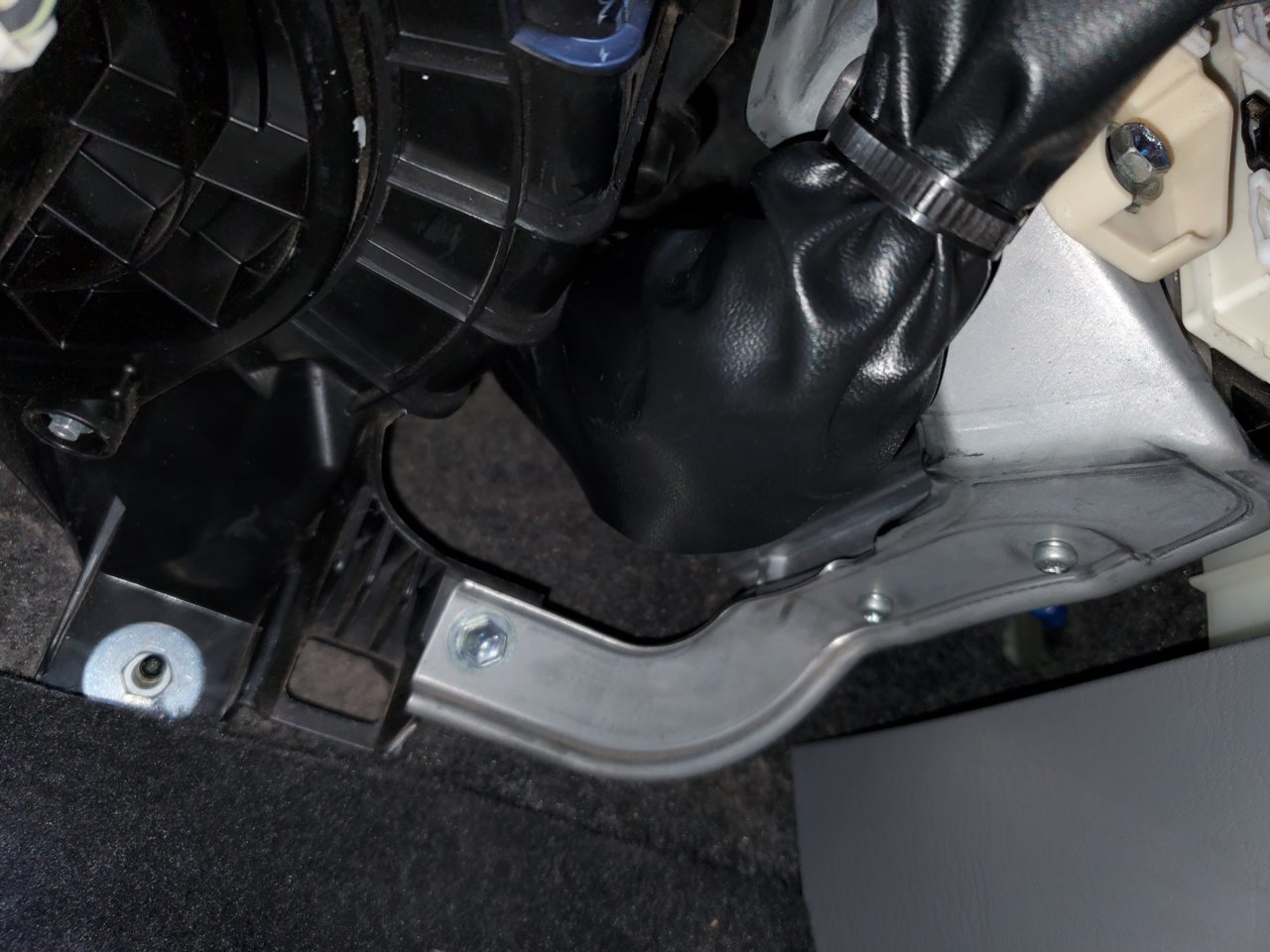

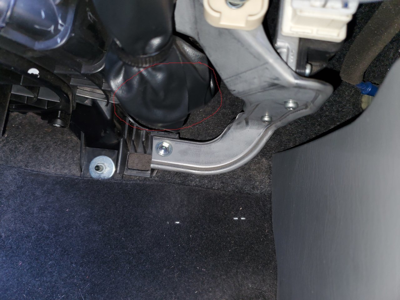

    On the inside the harness is basically just wrapped in a heavy vinyl wrap and there's one zip tie holding it to the metal support.
    Here's a picture of mine (don't mind the circle).

    Your Picture didn't come out for some reason DM93

    Looks like I am going to have to do something like that. Thanks for the time to send those pictures. Very helpful

    You could probably just wrap it in electrical tape although that would make it a bit more difficult to get to J12 should you ever need to, the main thing is to keep it from rubbing on that metal bracket.
    The zip tie is one of those with the oval push pin that holds it in place, I'm not sure where you can get those.
