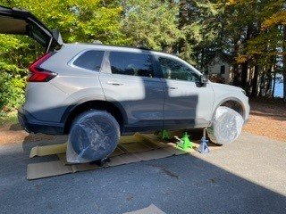

    I don't think missing a spot occasionally will hurt anything. Good chance you'll get it next year, when you're more experienced and progress from undercoating newb to professional. When I notice cars and trucks with rust it seems to be most prevalent at the door bottoms, rockers, wheel wells and tailgate where water can pool. A little bit of FF goes a long way. Plus, the FF creeps and flows. I use <1 gallon per coating. If you don't want to spring for a sprayer, I'd imagine 6-8 or so aerosol cans would be enough.
    I purchased a Kellysports gun from Amazon a few years ago. It came with the gun, 3 bottles, 360 wand and straight wand. About the same time, I bought 5 a five-gallon FF pail from NAPA.
    I like to use an aerosol can with the thin red straw for some of the tighter spots. This year Lowes, Walmart or HD seem to be the cheapest at just over $11 per can. I use less than one aerosol can per two vehicles.
    I jack the truck up, but I've done it before without jacking. Cover the just front tires and wheels with a plastic bag to protect the rotors and take off the spare tire. The back drums are fine uncovered.
    I start with the aerosol can and get the holes at the bottom of the doors. If I remember correctly the other enclosed spots can be done with the 360 wand. I think there's a couple of plugs under the rocker that I pop off. and sprayed in.
    Then I take off every second or third clip on the fender liners and same for the screws at the tailgate liner. Push the 360 wand in and spray while pulling the wand out.
    After that get under the truck and go to town. Most if it can be gotten with just the gun's tip without a wand. Avoid the exhaust if you can but if you spray it no big deal. It'll burn off. I prefer to lay down cardboard under the truck to shimmy around opposed to a creeper. Once that's done, I'll pop the hood and spray with the straight wand down towards the lower UCA's and maybe a few spots toward the front of the hood.
    Done
    It helps to have the FF warm so it's less viscous. This time of year, I place the full bottle in warm water while prepping.
    I have yet to do my truck, but here's a pic of wife's new CRV about to get its first FF.

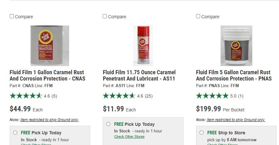

    5 gallons was like $200. They sell gallons for about $50. One gallon will be more than enough for one job. You'll need a sprayer and compressor for the one and five gallons. The first year I only had a pancake compressor and had to wait for it to catch up. I've since gotten a larger compressor.
    O'Reilly Lewiston prices online.
    There's a sold separately cap with the 360 nozzle for the aerosol cans. There some of the cans that already have the 360 nozzle, but I've never seen them in a store, only online.
