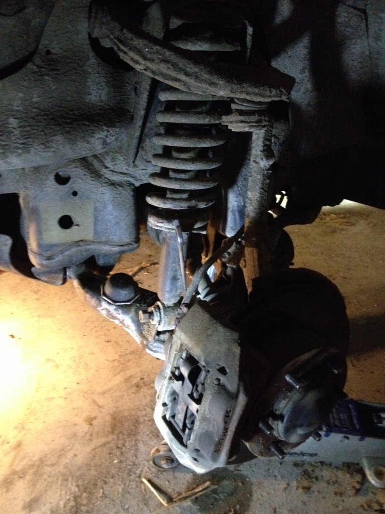

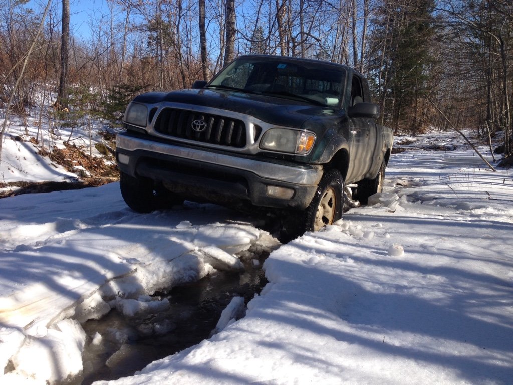

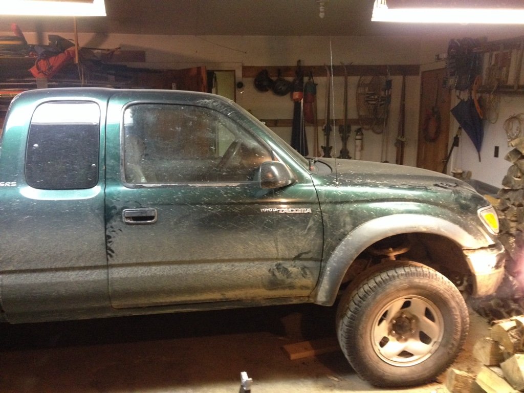

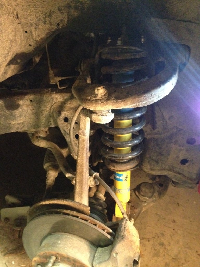

    Well today's progress was amazingly smooth. Not one snapped bolt and only a little swearing.dd975ccb675254c365354e082803cfef_5d96559d5454787442d4e38cec79688474a3f538.jpgb459d939412b12f3018b74469fe28e56_28b7d456274daf76286f381a0a21601cbdcaadf1.jpgbefb15a76ac28be67697debb79b828fb_83a4076c877ccd6ccec35d5b401051accaa85d35.jpg sorry no before pictures, and I forgot to measure but I would guess around 3" of lift was gained maybe a little less.
    And this is the stream I went for a little jaunt down. 5628f15584eecbea78f28afa0f0d0eb8_e13e48387cdb01721c8397199a1c555b9c4591f8.jpg459ae539d82ab0241c7167c1c36956a6_9b7ffba02ad9262a530b40acb93e6c83d32fde10.jpgbfba04449bfdb26514a7ff96896715a0_4bc824b08e179a6d1d5edef50eb28917c2e7f7fc.jpg

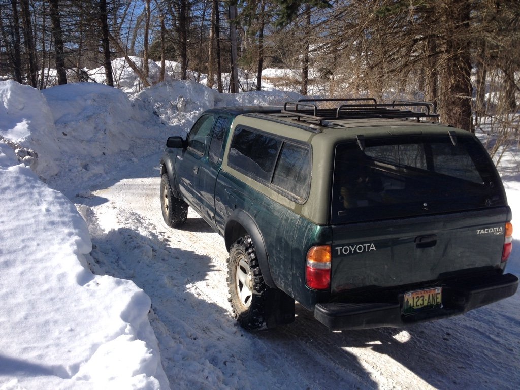

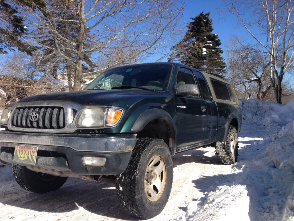

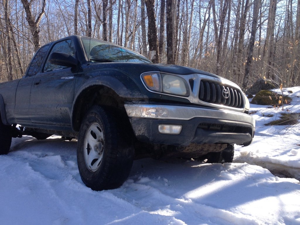

    I finally had a day to run the little toy through the wash and oh man it needed it. But Maine in the winter quickly replaced all the sand and salt I removed. But I gotta couple pictures of it clean. This is mostly the base line for this truck. I can't seem to own a truck and not start modding it. 3d423850e2e9e150815754a5b9628a58_4060b018fbeddc76583e42eb235edd1e473428e0.jpg8d9180f523c30a48f106ec31d3801925_e8ae7669095f0be716800d564eac8023f87bfcc6.jpgf3313f295cf7d9a6261d7d3c09b8bb80_2d7f66c7f4c56d4a88ef38e94d9320e1a71a5de6.jpg

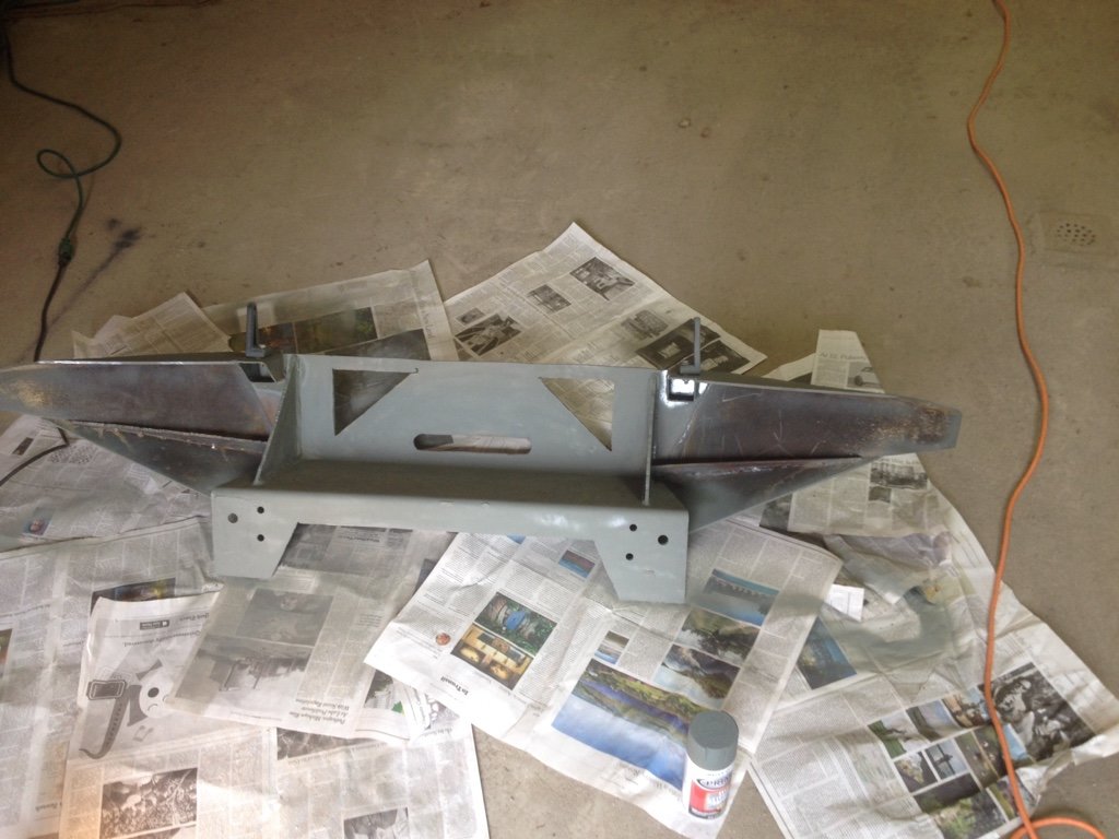

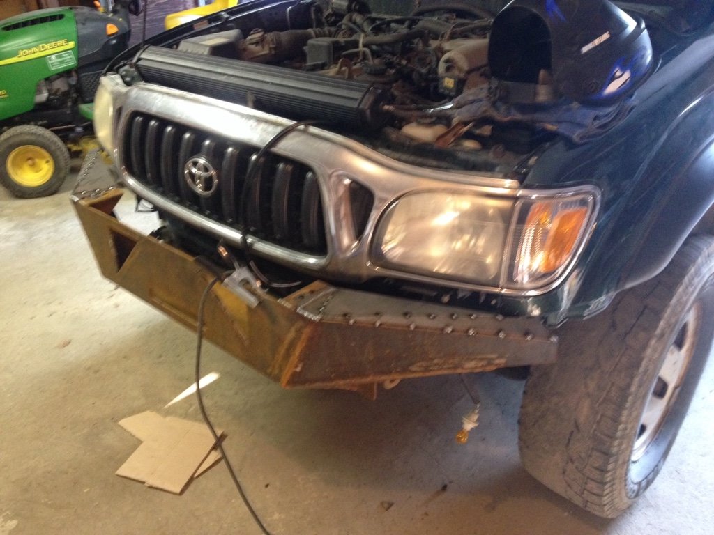

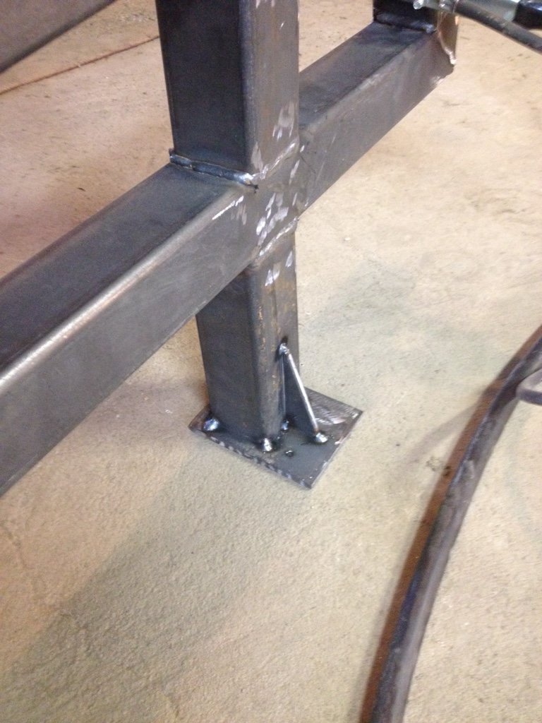

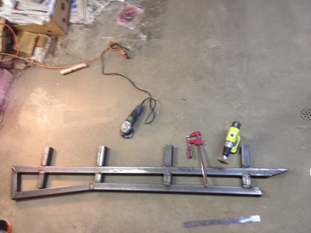

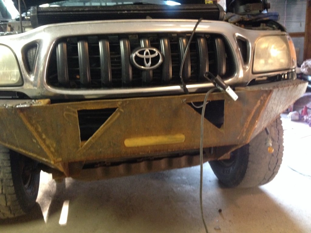

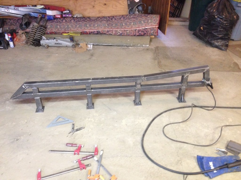

    Lately I have been taking a welding class and have been rather busy, but I am also starting to have a few things to show. My first project was welding up a set of sliders, to keep the sheet metal less dented up than previous vehicles. Here in Maine we have tons of granite boulders and trees, lots of trees.
    I found that they were an easy project to accomplish given a bit of time and a welder. I drew out my plans a few times, looked into every DIY weld up kit and then went and priced out the materials. At least for me going to the local steel supply shop netted me 30' of 2"x2" .120 wall square tube for ~$80 and later I had a machine shop cut 8 3"x4" mounting plates from 1/4" steel and a set of gussets 1"x3" triangles from 3/16" steel. After all the materials were stacked up I got to cutting with a 4 1/2" grinder with cut off wheels. Now this is just my opinion but if you try to use a cut off wheel go with the good ones, the first 5 I bought were the cheapo harbor freight variety, and they burned out fast. The guys at the welding supply store sold me on Walter zip one cut off disks, though a bit more expensive (~2x the cost) they last much longer!
    One of the few issues I had when attaching these new sliders was the frame seems to be 1/4" narrower at the front, and only the front most mount, which I didn't account for. I will be sliding a plate of 4"x4 1/2" steel behind the mount to fill the gap better than just bridging with a weld. I went with welding the sliders on, first because unless they get mangled they are gonna be on the truck for the rest of its life, and secondly I didn't have the money to fabricate mounting plates that run the length of the slider ( kinda like some of the better sets on the market). If I ever happen to make a second version of these I will make them bolt on with full length mounting plates, and probably try to mess with Aluminum to help keep the weight down.
    At the same time I was working on my sliders at home in the garage I was playing with a plasma cutter in class working on making my very own Maine Resistant front plate bumper.
    The core section of the bumper is all 1/4" plate cut into shape then bent at a local machine shop (cost to bend $15) and braced with 1/4" gussets. The rest of the bumpers structural design is made from 3/16" steel for strength and maybe a hair less weight. The top of the bumper is going to be 1/8" as I don't see too much force being applied there, maybe except me climbing over it once in a while.
    And now for a couple pictures, more will follow.

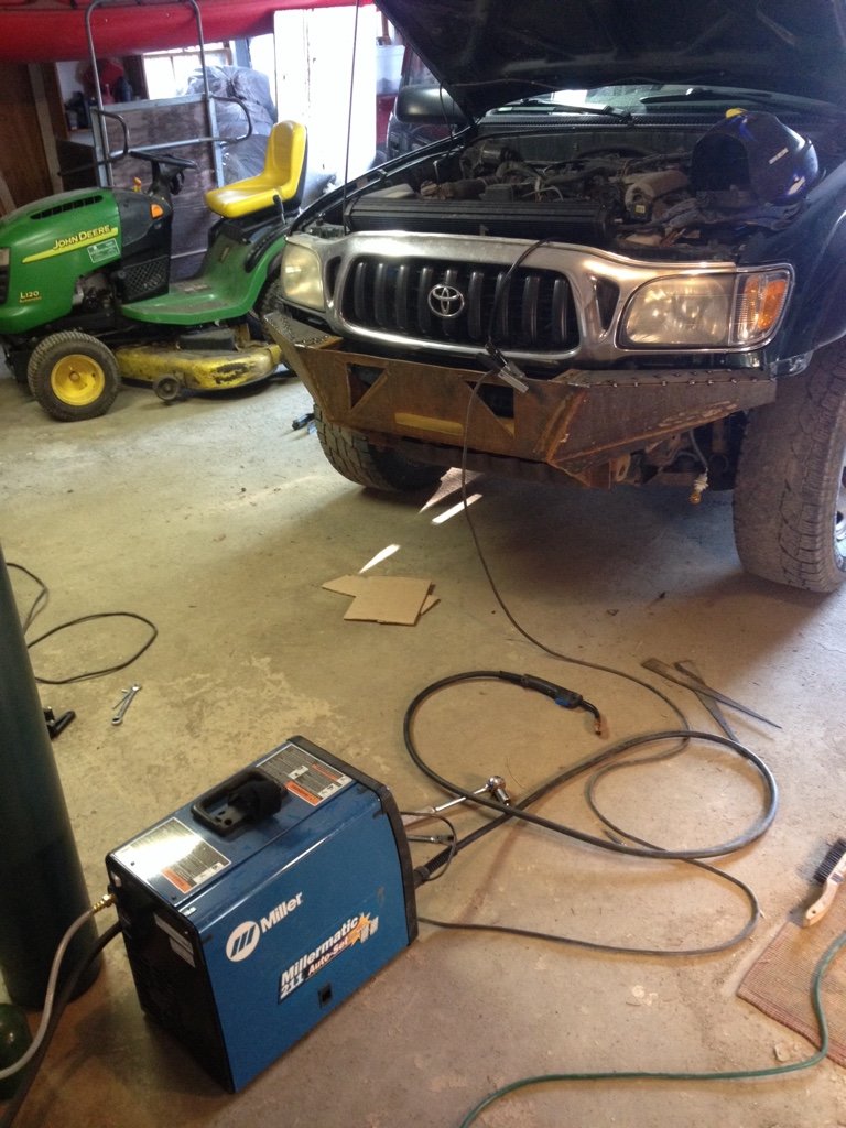

    I finally have had some time today to work on my front bumper! Time for a few pics.

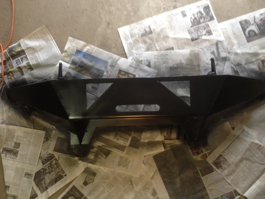

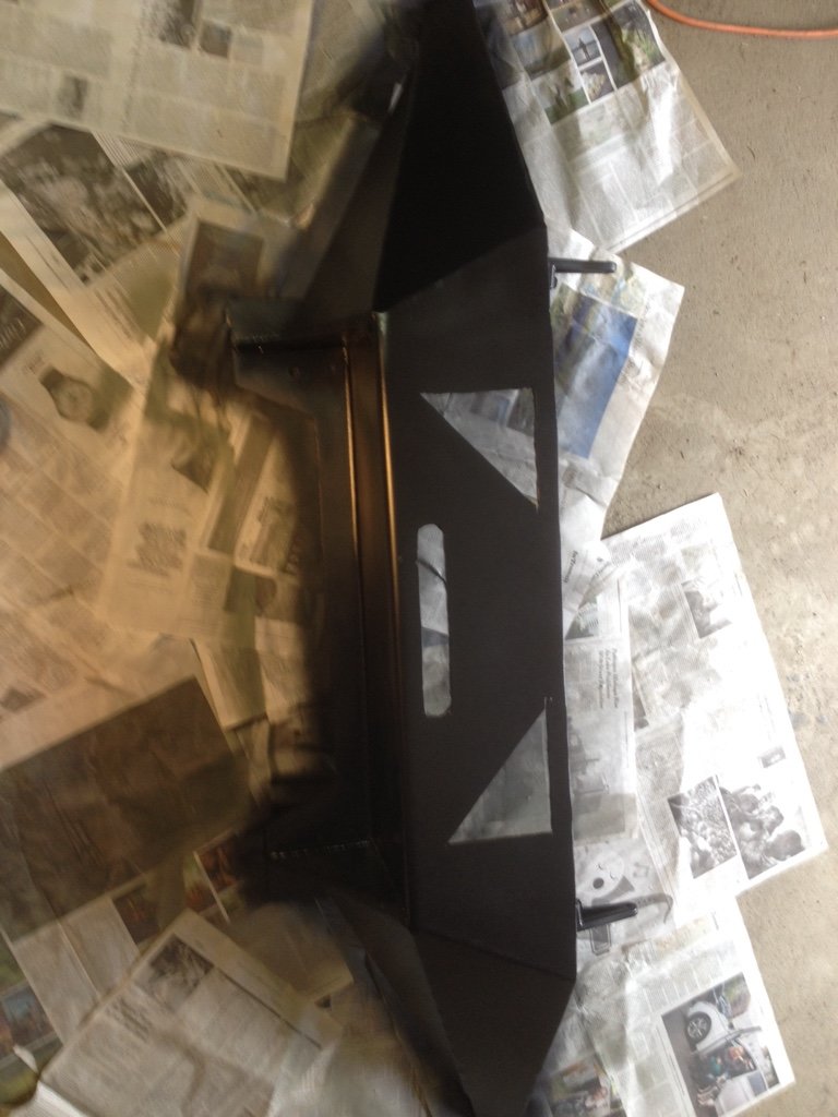

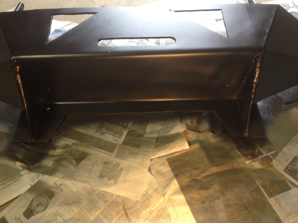

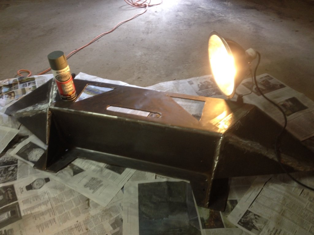

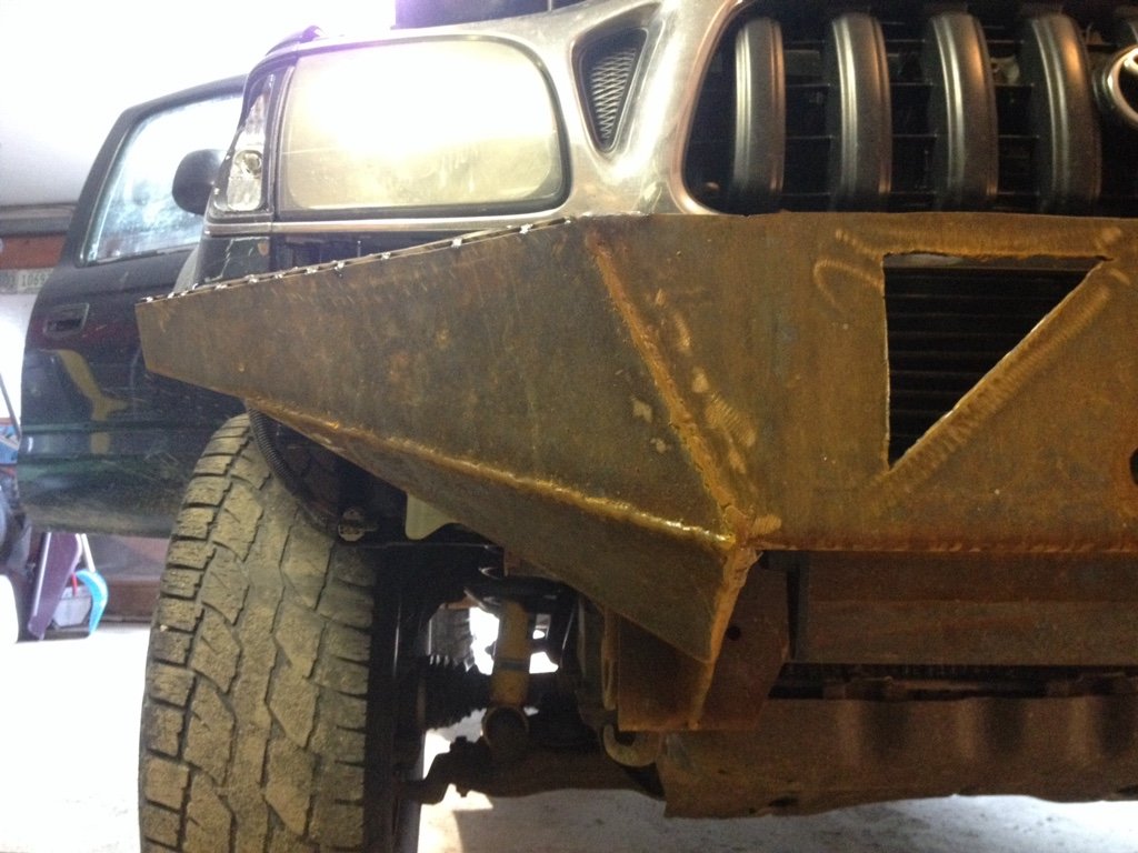

    Today I have continued on finishing up this portion of my front bumper. Grinding all of the welds flat on the outside.
    Removed the bumper for a quick coat of primer inside and out.
    Then a shot of Rust-oleum Undercoat (Professional Grade) to help keep the rust down until I can finish this project up.
    If anyone has any questions or suggestions I will happily answer/ receive them.
    Does anyone have any suggestions for a good set of recovery points? And have any of you mounted a 21" LED bar below the winch tray? Here>>
    My thoughts are it may be the lowest point on the bumper and therefore the first thing to take damage... I am thinking about welding tabs onto the gussets to mount a plate of mesh (maybe expanded metal? Suggestions?) to protect from sticks and such. But I'm still concerned about snow or rocks doing damage. Thanks.

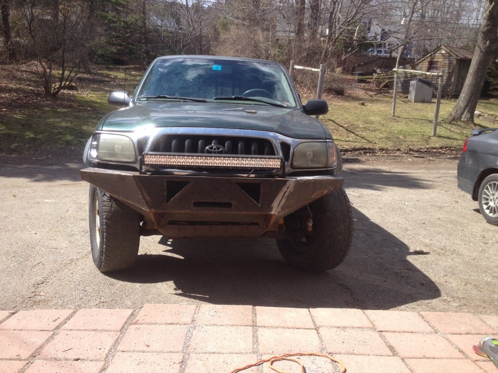

    Nice craftsmanship on the sliders and bumper? Did you design the bumper yourself? Again kudos
  17. May 1, 2015 at 2:58 AM
    #17
    MaineFarmer
    MaineFarmer [OP] Well-Known Member
    Dec 23, 2014
    #144787
    202
    Jason
    Maine
    2018 TRD Off-Road
    Added a bunch of stuff. Cut to fit 285 AT3’s

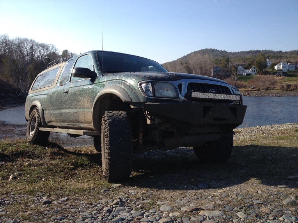

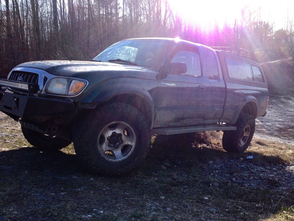

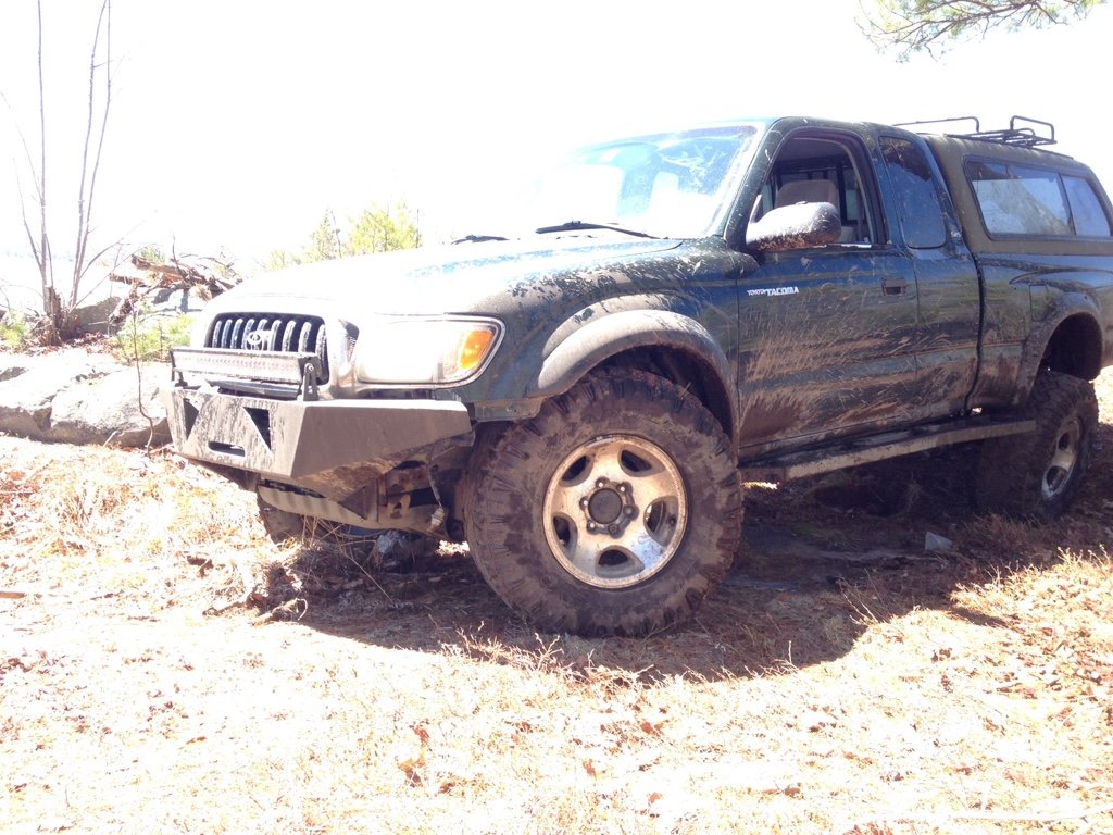

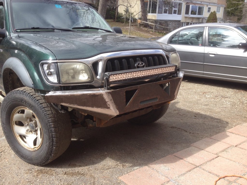

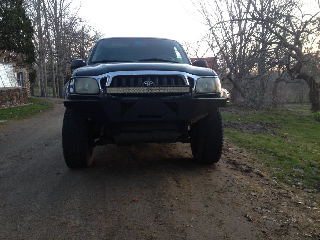

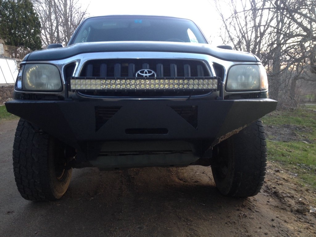

    If looking at what other people have made and trying to replicate what I liked, then yes I designed it. Lots of drawings then I started making a template from cardboard.
    Thanks for the compliments! It's great to hear.
    Here are some pictures of the bumper mounted up.
    aa7387f72497dadf2a86fb6be3d5c5a4_af57fb2bf7005a1deede86a1c155eac01fdd1885.jpg86ff6e0e2fb81f085b033f20bfbece3b_d6c3ef477c0d73c6c19be7e0b6fc2eb598403192.jpg

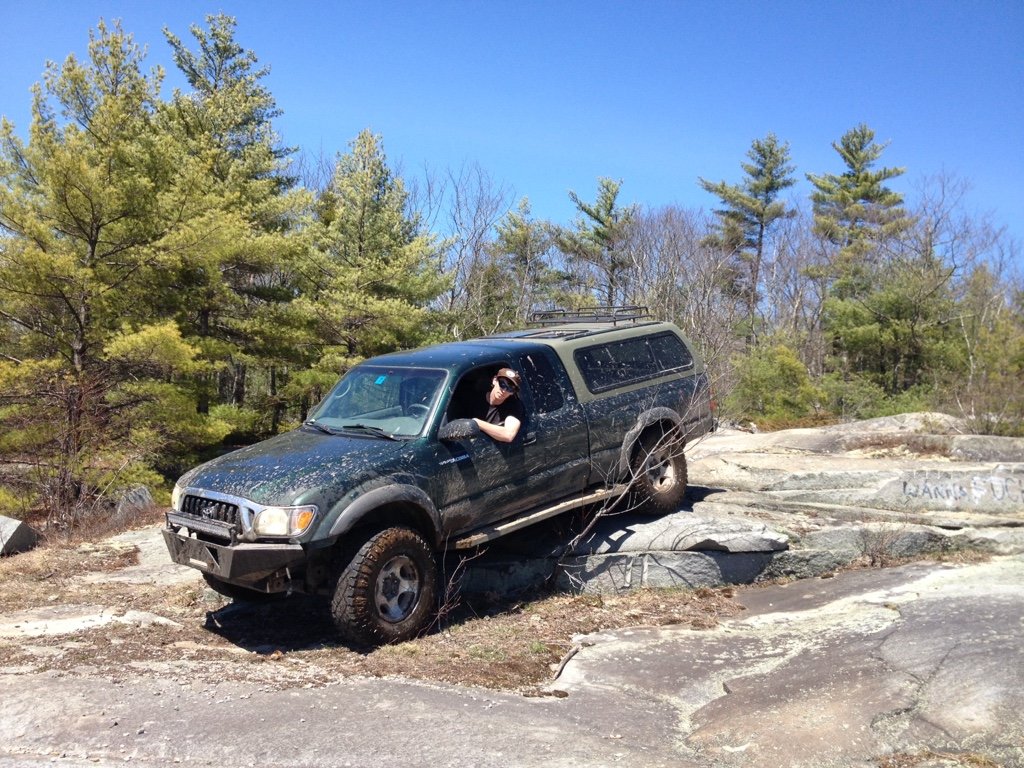

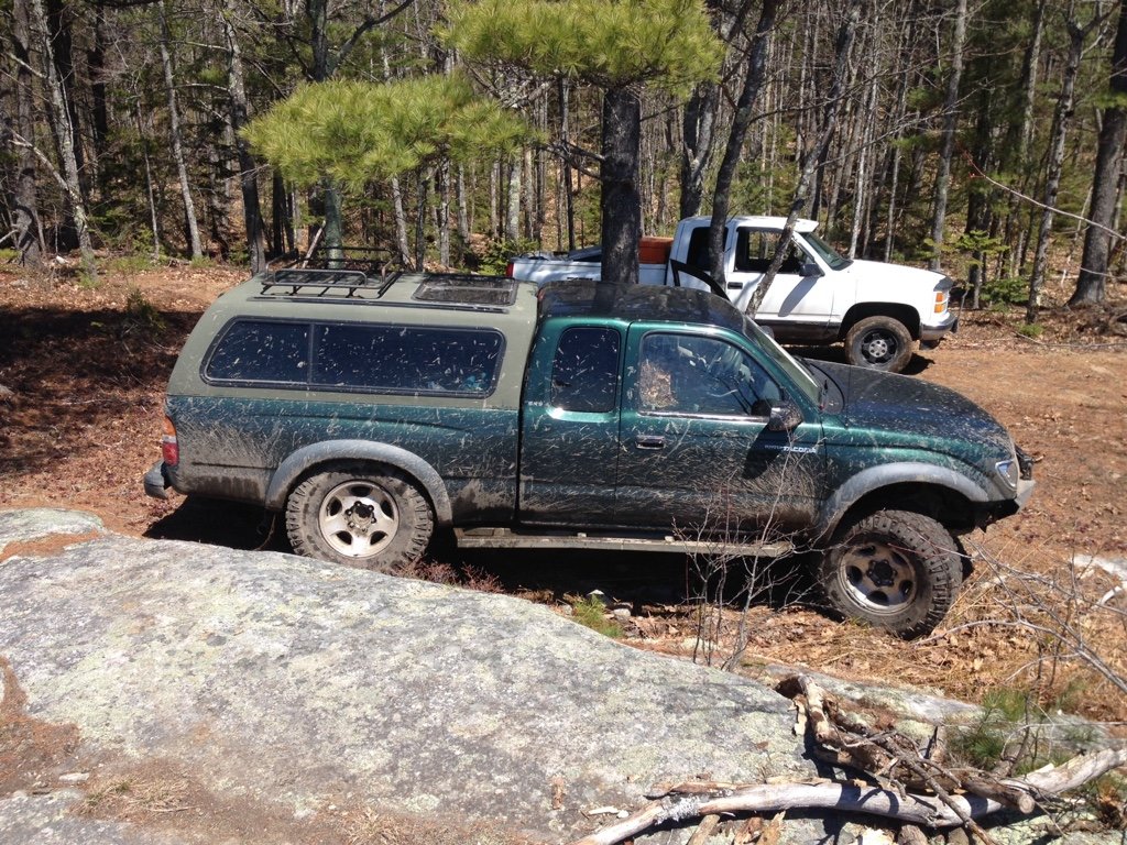

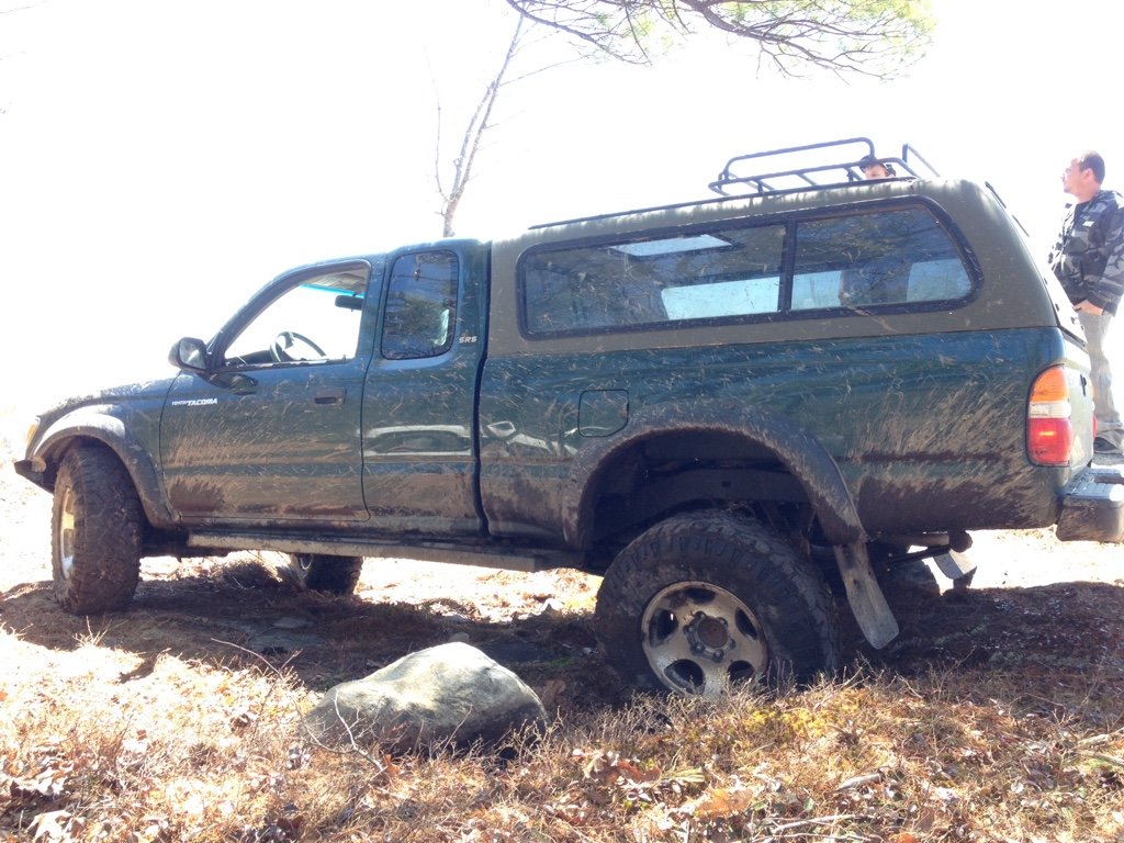

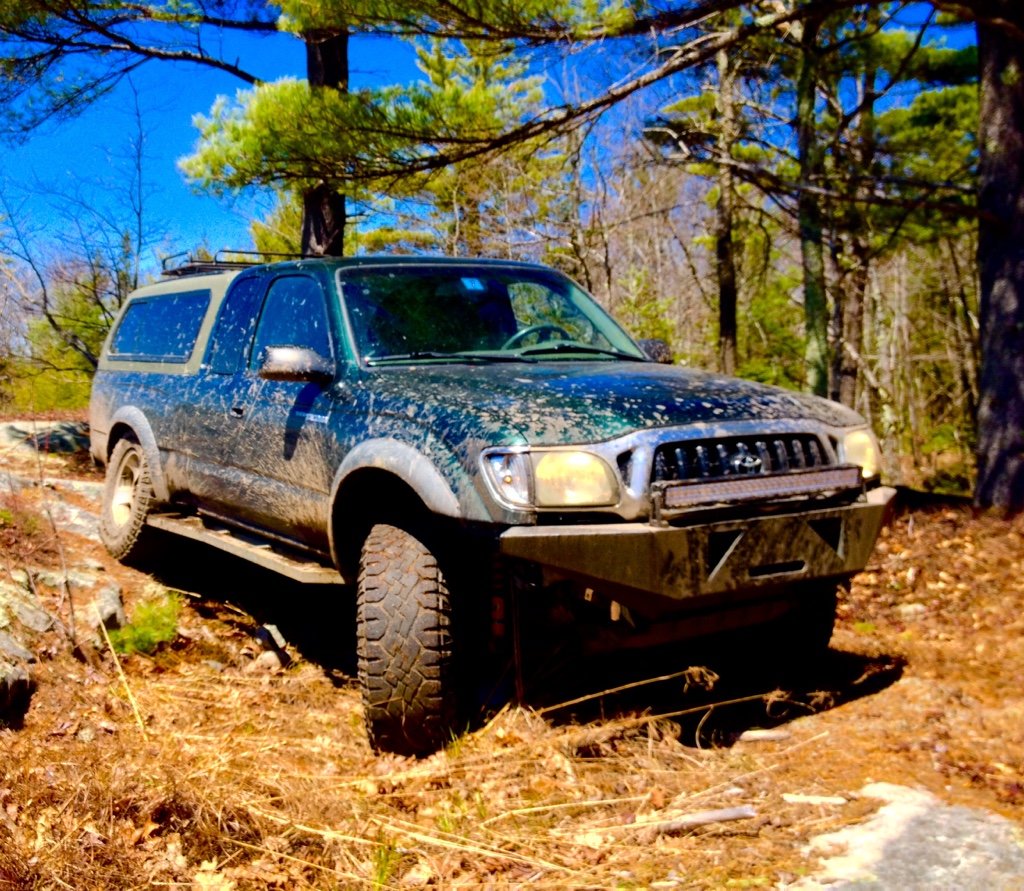

    Finally the weather, time and new tires allowed me to go play around in a trail near me.
    And this is my buddy's 4Runner
    And playin on the granite

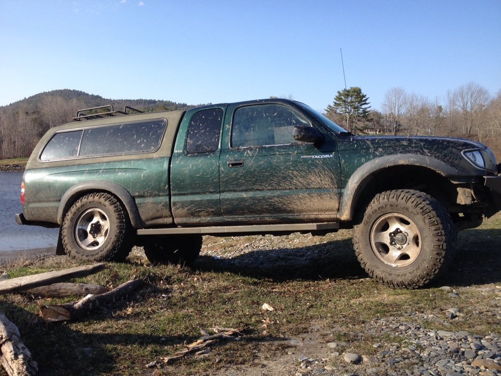

    Went to the beach to gather some compost for my garden and couldn't resist playing a little.
