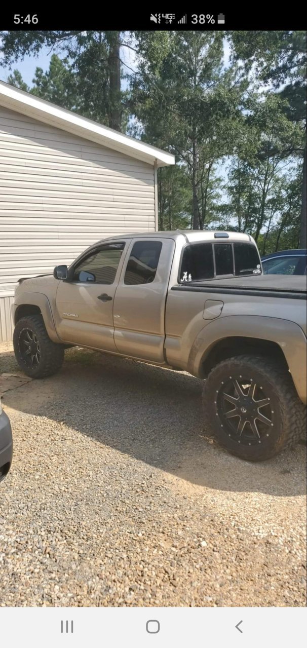

    I have recently purchased an 2006 Tacoma access cab w/4x4. It has 240k miles but was a great deal. I has a rough country lift and oversized tires. I am wondering with a truck with that mileage what are some maintenance items I need to keep a check on or maybe look at replacing. Also I have never owned a truck with a lift on it and am wondering what kind of maintenance that requires.

    Usually with lifts and big tires you'll see CV axles tear and lose all the grease. The steering rack is usually leaking by now (oil in the boots). Upper ball joints can be worn out dependent on how you drive it.

    The main thing I have noticed is that there is a sound almost under the driver seat I can hear when I am coasting. It only happens in 2wd but goes away in 4wd. It sounds almost like a chain moving or something.

    Needle bearing

    Its not a simple job, but if your going to do ball joints shocks and other maintenance, then do it while that's all out or you'll pay twice.

    Replace all fluids and filters, get the needle bearing and ball joints fixed asap before driving it to far. Check the motor mounts on both passenger and driver. Check belts and hoses including brake lines hard and soft.

    Thank you so much! I have read somethings on this forum about how bad rough country lifts are. Should I replace it with a new lift?
