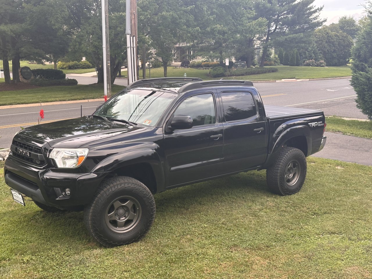

    I just picked up this truck a few weeks ago. It has 70k miles.
    I am planning to do a fluid film coat on it before winter.
    I also wanted to change fluids. Should I change all fluids out? Should I flush trans fluid or just drain and refill?
    Any other maintenance I should do?
    Thank you. I love this community.

    Nice looking truck! How's the frame? Yes do all the fluids unless you have the service records, that way you know everything is the way you want it. Trans. drain and refill unless you suspect something. Follow the maintence schedule.
    Keep us posted

    Thanks! The frame has some very minor surface rust, but otherwise perfect. I looked at over 30 trucks before pulling the trigger. I’m in NJ so this one was the unicorn. The rest had too much rust.
