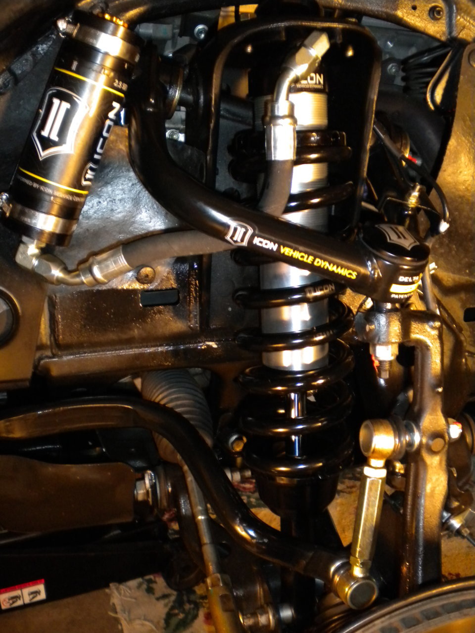

    Thanks for the help! I loosened them and worked a lot better. Spaced that one. If the oil only comes out on the outside busing on each arm is that ok? Spun the bolt a few times as well. Still only came out the outer bushings

    Anyone having a hard time greasing the Deltas? I have the low profile needle zerc, and I can feel it move when I push down, but I can't get any oil to go through. Just keeps coming out the top. Suggestions?

    Did yours come with the standard zerks? I couldn't get the needle zerks to work right. I finally gave up and swapped them for the standard zerks.

    Nope.. they came with the weird low profile ones and I can't get them to work either. I'm going to switch them out for regular

    If u have the odd low profile zercs, I recommend switching them to regular. Work WAY better, easier, and don't get clogged w dirt.

    So I broke one of the tips for the zerk fittings with a crap grease gun. Only had non-tapered fittings at the time so it leaked slowly. Finally got some from Amazon delivered, only to have them be mislabeled. So I put another non-tapered.
    Does any one know the exact specs of the fittings that come with the tubular? From what I've found, it's a tapered 6mm x 1, but I'm not sure of the thread pitch. I already think I damaged the tapered hole on the UCA by using the straight fittings, so any suggestions are appreciated to avoid any further damage.

    Tapered 6mm x 1 from Napa worked for me.

    I literally bought regular ball fittings in the small size on Amazon, threaded them in, and it worked great. Now greasing my DJ's is easy

    I change out from the needle to regular zerks for greasing... like to have the cover plate on for protection from rust/dirt.

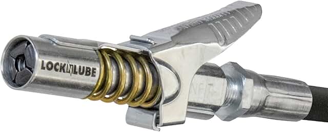

    I tried a few different auto store and online 6mm standard zerks... all were a loose fit. Ended up getting them straight from Icon. Even then when threading the zerks it seems there's only about 3 or 4 threads... very easy to strip. For less stress on the fittings i ended up getting the locknlube coulper... short one for the delta joint and the longer version for access to the pivot bolt zerks.
