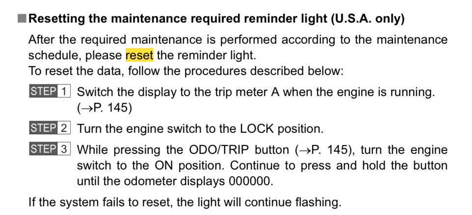

    this is from my owner's manual on my 2015
    If this doesn't work for you, see what your owner's manual says. That's definitive.

    none
