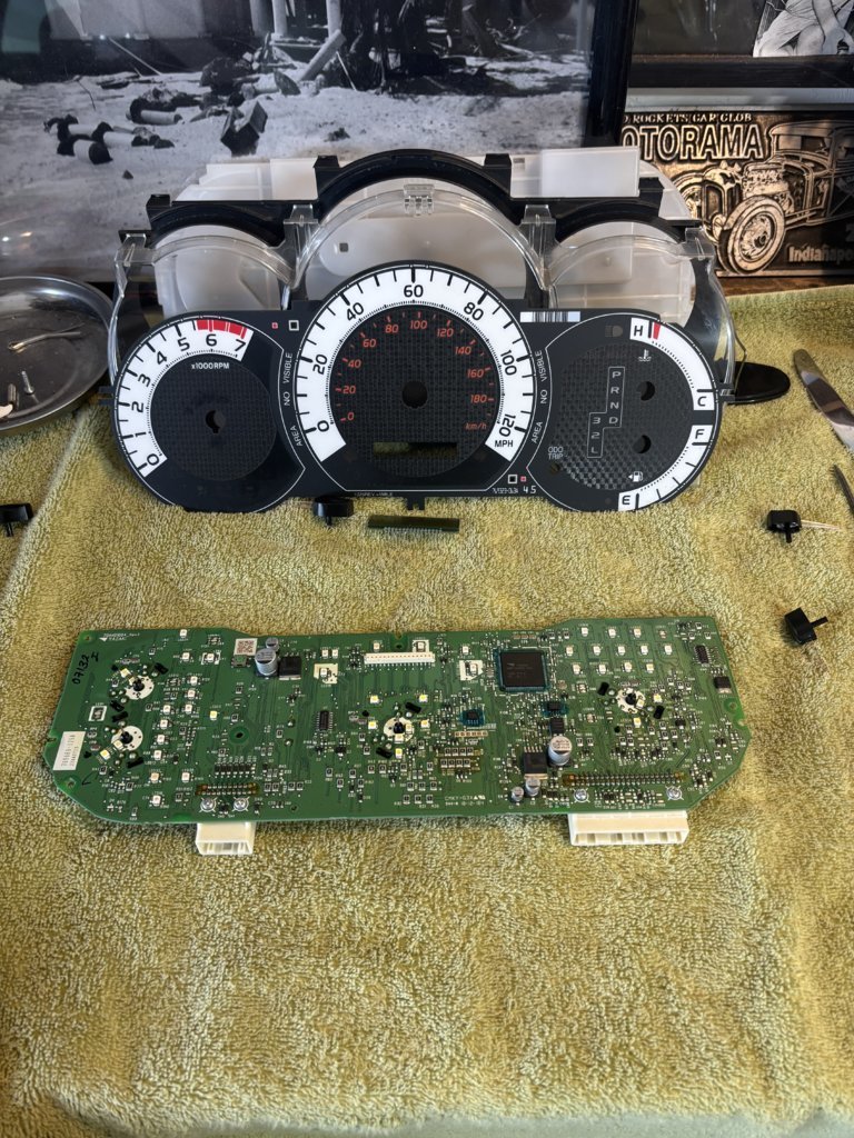

    That is true but the LED can be removed. Many people have changed out their LED's to different colors. I have the gauge cluster on the bench now.

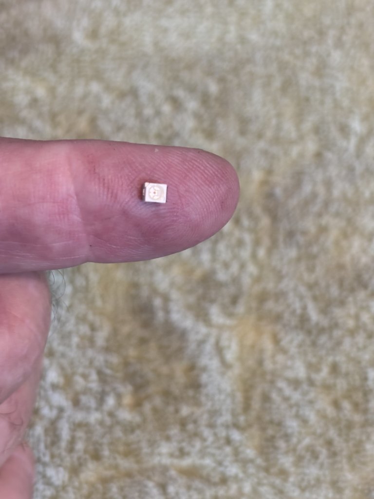

    Success! The Maintenance light is no more. Hard to believe that tiny little LED could be such a thorn in my side.

    I used a cheapo $6.00 soldering iron from Harbor Freight since I didn't have one with a small pointed tip. I unsoldered the LED from the bottom first then the top and it came right off. Here is a Youtube of a guy changing out all the dash lights on a Gen 2 Tacoma to change the color. It also shows how to get the gauge cluster out and apart. I think I counted 42 LEDs on that circuit board, way more than I would want to mess with just to change the color of the lights.
