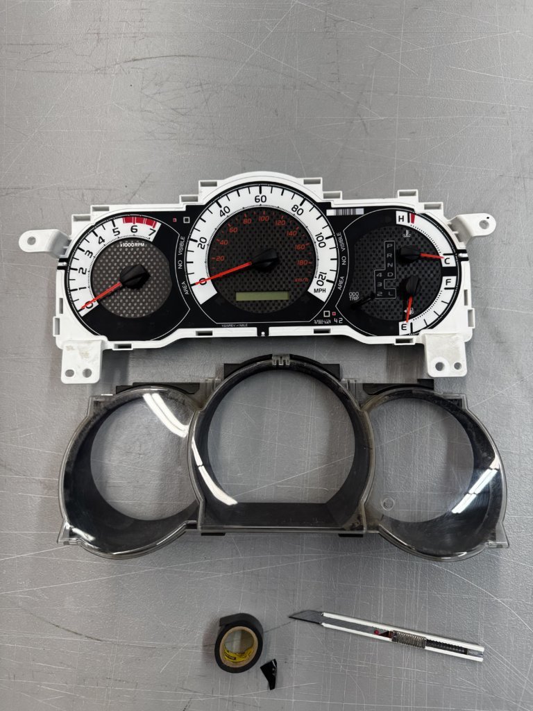

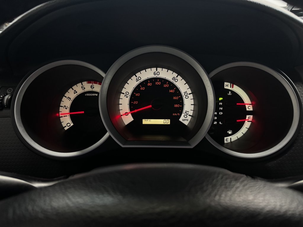

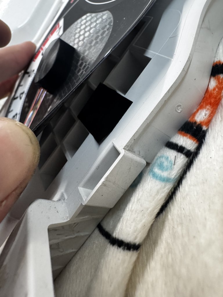

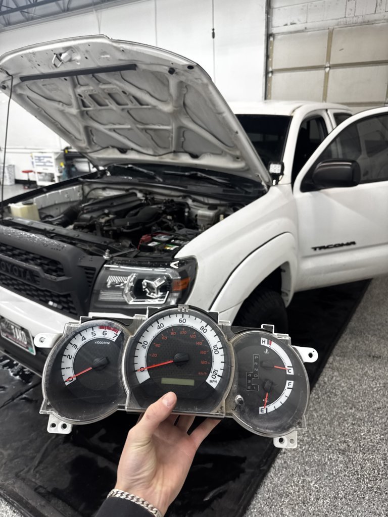

    Finally had enough and had to do a more permanent solution…:devil:
    my 2011 trd would NOT reset no matter what, had dealer inspect it, couldn’t find any issues with the truck whatsoever and still couldn’t get the light reset. Soooo I took matters into my own hands. Took about 10 minutes start to finish, couldn’t believe how easy it was!
    I removed the gauge cluster (literally pull on the trim and it’s all clips pulls straight off torwards driver seat, then 4 bolts for cluster) disconnect negative terminal on battery, then unplug the two wire harnesses to the cluster which are conveniently located right on top with little tabs on the backside, then when cluster is off, the clear cover is just tab clips and pops right off, then was able to lift the corner of the cluster and sneak a piece of electrical tape over the maint reqd light (not touching a light itself, just over the plastic tunnel bezel for the light) and it worked so perfectly. I use my trip A for my oil change mileage so it doesn’t effect my use whatsoever. Jerry rig genius is how i’m feeling. Here’s a few pics i snapped along the process LOL:

    It never reset! I couldn’t figure it out for the life of me, nor could my local Toyota dealer. It’s not a bulb style like some gauges, instead it’s a tiny led on a motherboard so i did double layer electrical tape over the tiny led square and haven’t thought about it again LOL
