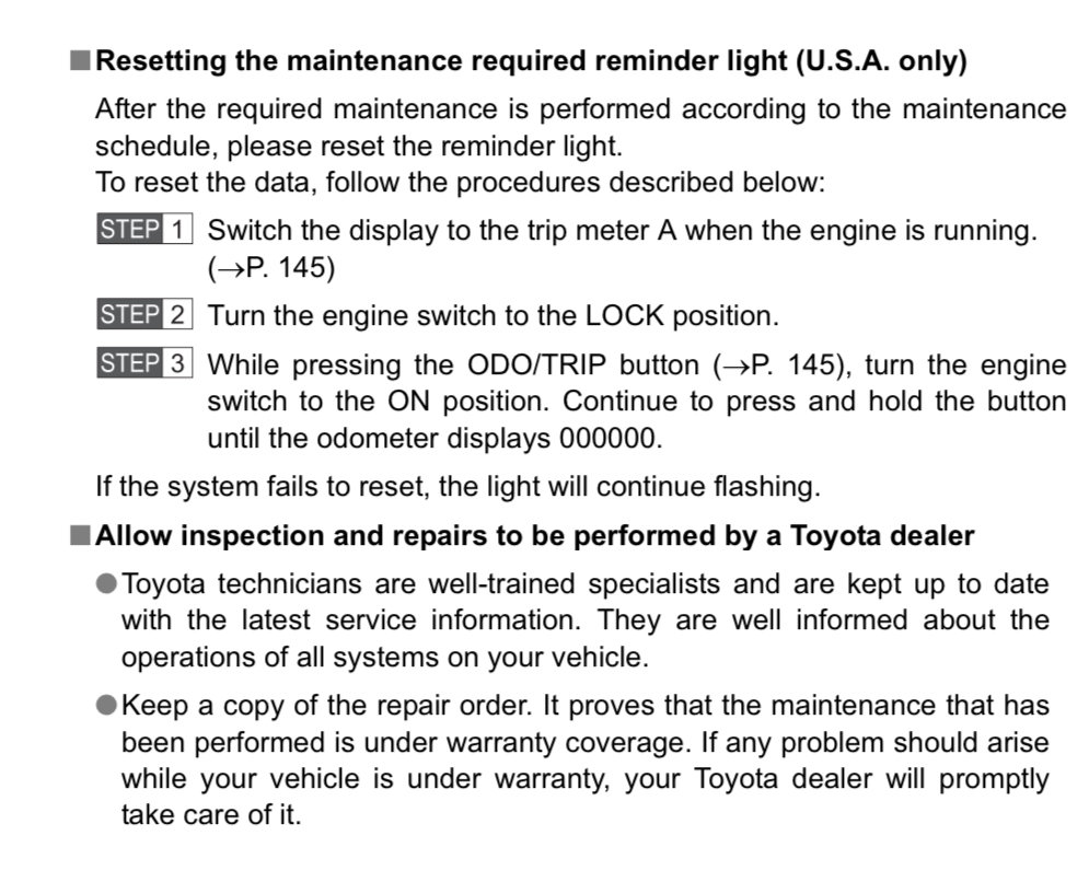

    No idea why it waited so long to come up, but that’s how you reset it.
    Raz and michael roberts[OP] like this.

    At 4,500 mile mark from the last reset it will flash when the truck is started for a short time then turn off. That is a reminder that you are getting close to the 5,000 mile oil change interval.
    At 5,000 miles from the last reset it will come on and stay on when the truck is started. It will do this until it is reset using the procedure above.
    ** Exception to the procedure above is that the early 2011 ( Red Faced Combination Meter ) and older you have to be on the Odometer and not Trip A.
    Late 2011 and newer ( White Faced Combination Meter ) you have to be on Trip A.

    I'm glad you posted the CORRECT method to reset the Gen 2, there are several videos and instructions on the web which say to use the "Total milage" trip ODO setting which is incorrect! Thanks

    Just so we are getting the correct information out there for all second generation Tacomas. Both answers are correct depending on when the truck was made.
    Early 2011 with the red gauge face and earlier do use the Total Odometer setting to reset the Maintenance Required Light.
    It changed in Late 2011 when they went to the white gauge face to use the Trip A setting...

    I’ve had an 08 and 09 Tacoma before this 15, always remembered it being the ODO. Saw that in the manual for the new rig and saved it to remind myself.
