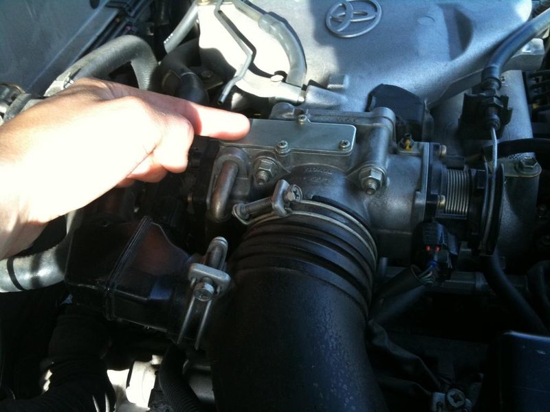

    Yesterday I talked to my buddy whos a Mechanic for Toyota and I asked him for tips on maintenace for my taco. He told me to clean my throttle body because carbon deposit get build up in there. So, I bought some Carb cleaner like he said, I got a rag, spayed and clean my throttle body. Today I drove it to work, OFF the bat i notice my idle is alot smoother. My buddy told me i should get better MPG also. So i totally recommend doing this to your truck. you'll notice a huge difference. IMO
    Also, your TB has about 6 little screws that hold a little plate down. Inside that are about 6 or 7 little holes that carbon gets build up in there also spary and clean those holes out with carb cleaner until there completely free of any carbon.
    Hope this helps :)

    1st question: your TB is located at the end of your intake hose. You'll see your throttle cable attached to it. Right next to your manifold.
    2nd question: maybe a little but i have the Deck plate mod on my truck so i didnt reall notice a change.
    All i notice was a smoother idle. I hope to see a better MPG.

    Heres some pictures hope this helps.
    Picture #1 unscrew the clamp where the intake hose attaches to the TB. Your going to open the Throttle plate so you can clean inside of it.
    Picture #2 - These are the little screw that hole on that little plate i was taking about. There are 6 tiny holes in there clean that out.

    I just cleaned my throttle body about 5 days ago. Not because of this thread but because my truck wouldn't stay at idle, and when I would put on the brakes, it would cause the RPM's to drop and kill the engine. Luckily I had already experienced this once before on previous Toyota models so I knew what to do. Basically just pull off the intake hose, take your can of throttle body cleaner, or carb cleaner (they're basically the same thing), and an old tooth brush. Spray some cleaner into the throttle body, scrub with tooth brush, open the throttle repeat process, don't go heavy on the spray when you open the throttle, it doesn't hurt anything, but it can cause a brief moment of panic when you turn the key and nothing happens, and all you hear is the crank of the engine. you just have to burn off the cleaner, which literally takes 2-3 cranks. Reassemble and your done.
    I too noticed an immediate change in the throttle response, MPG...ehh about the same. But everyone should do this probably once a year. The carb cleaners is like 4 bucks at the local parts store. Takes 5 minutes and keeps your truck running clean.
    Oh and the other best part of doing it yourself, the stealership wants (last time I checked) $85 to do this.
    Oh also another quick tip, get some MAF sensor cleaner and clean that bad boy every once in a while, it will help your engine run more efficient cause it's not misreading air temps & volume.
    Taking care of your truck yourself is sooo much cheaper than paying someone else to do it.
