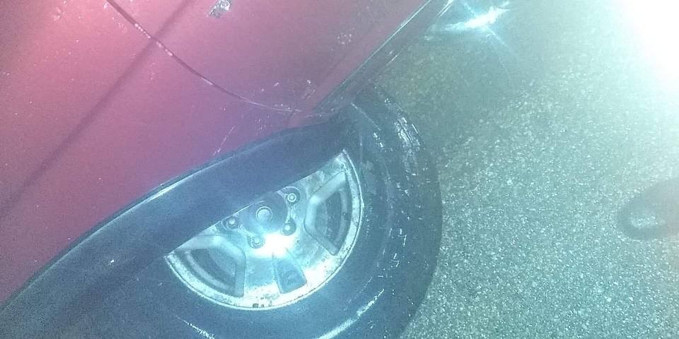

  9. Nov 30, 2020 at 10:16 PM
    #29
    EleventhTry
    EleventhTry Member
    Nov 22, 2020
    #347483
    5
    Jordan
    2002 Maroon Tacoma PreRunner
    People mentioning the ball joints, this is an incredibly important point. Both the upper and lower on my drivers side snapped at the same time as I was driving home one night and this happened -
