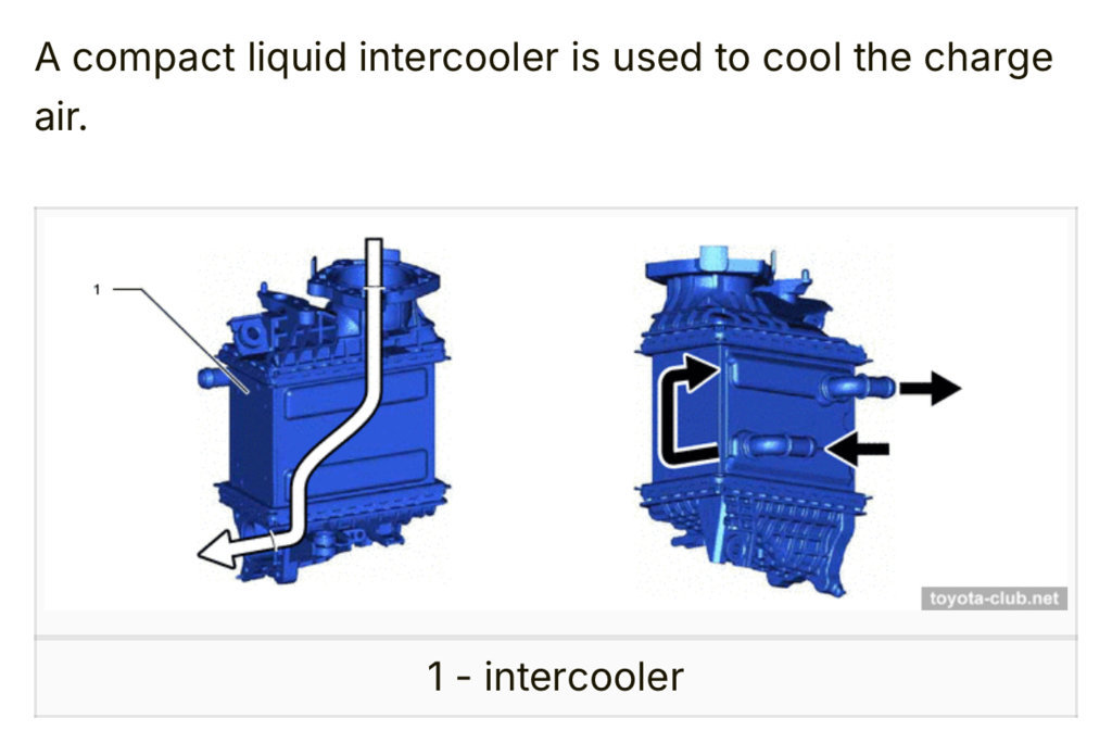

    It doesn't strongly suggest it. It outright says it: "A compact liquid intercooler is used to cool the charge air." There's even a diagram of the coolant flow for the intercooler and turbocharger and a 3D model of the intercooler itself with coolant pipes coming out of it. I managed to gloss over it before, as I thought it was a run of the mill air-to-air intercooler, but it looks like there is an entirely separate coolant circuit for the intercooler and turbo with its own electric coolant pump, reservoir, and radiator.

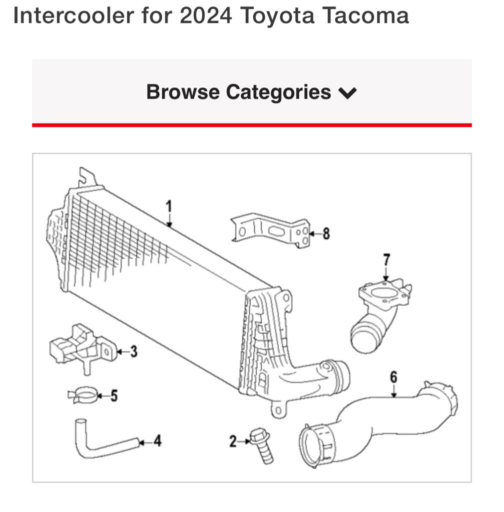

    2024 TRD Off-road
    BearWithMe, gmtech and Delta09 like this.

    That site is not correct. They took the run of the mill T24A-FTS technical document and applied it to the Tacoma. Most T24As use air to water. The Tacoma does not, it is air to air.

    Air to Air is simpler.. SXTH is working on a bigger more efficient one. Should be an easy install but pricey I’m sure?
