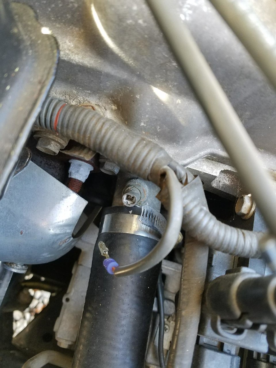

    Please help....
    I just replaced my leaking radiator this morning and now I have coolant boiling in the upper radiator hose for no apparent reason. It seems like nothing is flowing and temp started to rise and overheat, so I shut it off.
    The inlet from the upper radiator hose to the block has some sort of sensor attached to it. Could this possibly be the problem? I have searched online and in my shop manual but cant seem to find any numbers or help on those two items. When I went to remove the wire it just sort of crumbled due to age I guess. Now on top of boiling coolant I have to replace the sensor that I cant locate anywhere.
    I have attached two pics of the inlet and sensor.
    This Tacoma is in great shape for its age, and I was trying to sell it. Any help would be greatly appreciated.
    Thanks.

    Besides all the circulation issues, does anyone know which sensor that is in the pic I posted above. It goes in the water outlet from the block to the upper rad hose. I cant find anything online about that part.

    Not enough to have a build thread.
    I'm not a Toyota expert but I would assume its your coolant temp sensor.
