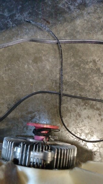

    Checked my hoses. Here's the belt. You can see a chunck came off and wrapped around the fan too however the fan was spinning

    Lol a little shredded? Fill it with coolant or water and see where it comes out. I would think it would be a catastrophic failure of something by what you described. I guess I should say it has to be distilled water, but it's your choice. Your belt flinging may have cut a hose.

    Haha last time one shredded it turned into slivers so I thought a little shredded yeah.
    I'm rechecking all my hoses now for damage again. Any other possibilities? Just trying to get as much input as possible

    That's the weird thing, the belt was totally fine otherwise and was only 8 months old

    Quite possible a small rock / pebble was kicked up and into the belt causing the damage. It's not common, but not rare either, happened to me last year on a low mileage belt, thankfully no other damage or leaks. There is a reason I put the old belt behind the seat when I replace one that is still servicable - a free spare is worth a lot more when you need it to get home.
