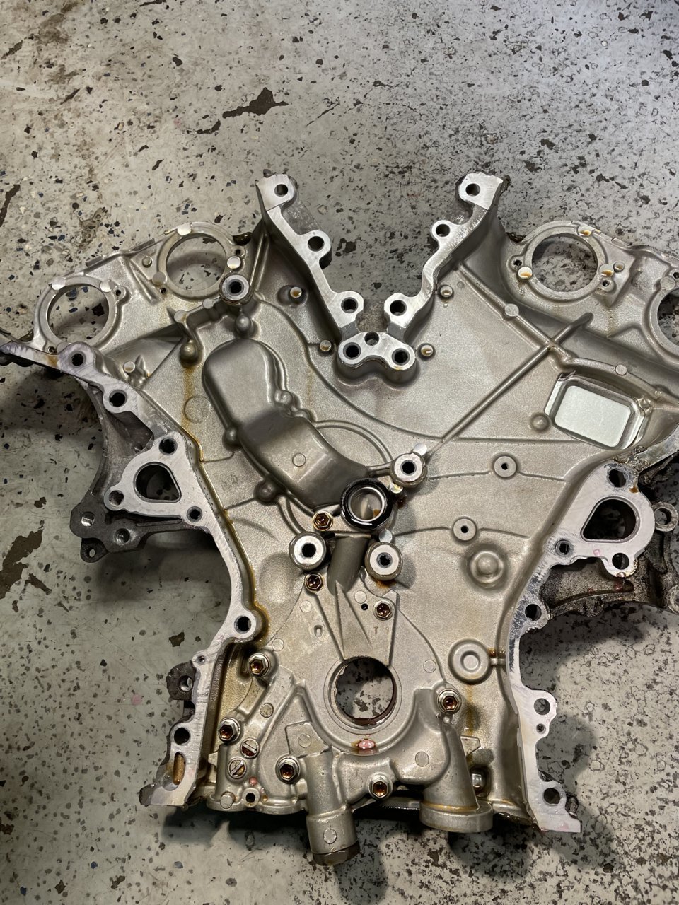

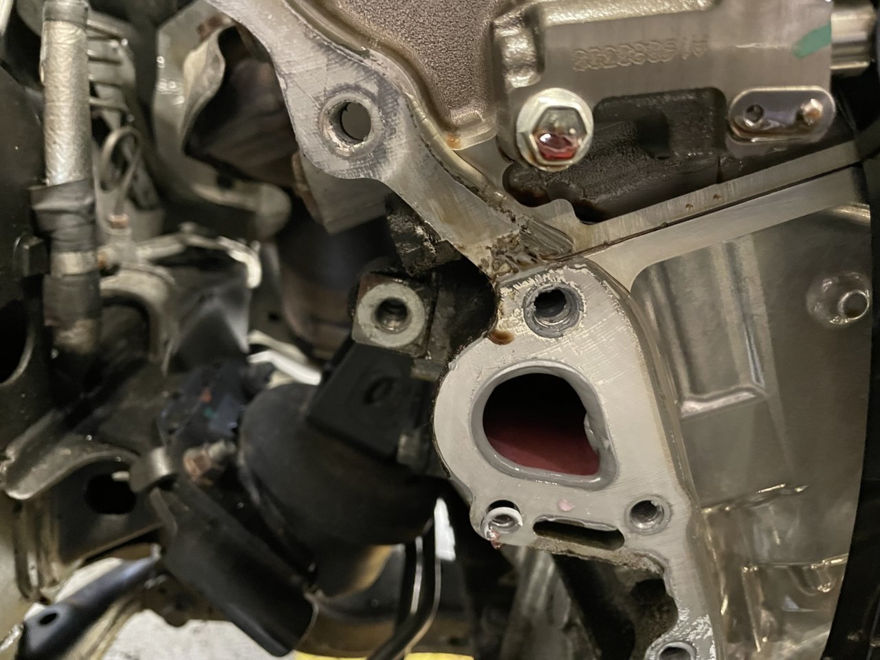

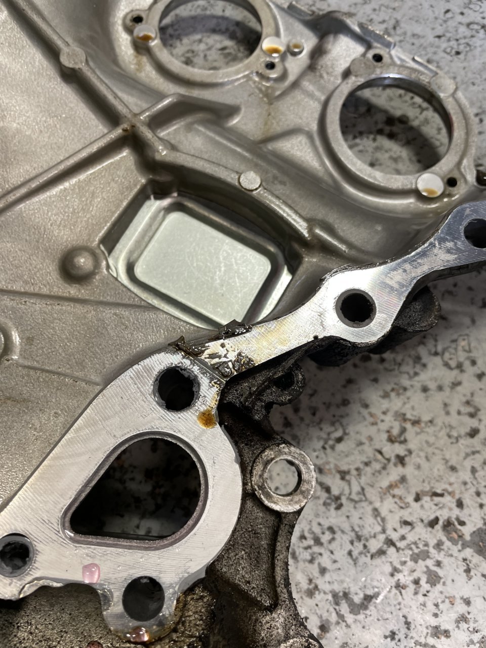

    50C292AB-FCAD-4888-B49F-0A19C2EED4BB.jpg 7F5CD2FA-41F3-428A-9DD5-62259037A2B6.jpg 8E9E99E4-1B22-442E-A68B-F9E8BED97734.jpg 679D424B-26CD-4211-AEC0-EFAF265902A5.jpg 581BF094-80C4-46C7-91FC-BE6EA0765284.jpg Sooo I’ve been dealing with a small oil leak, at first I thought it was the p/s pump leaking but after some googling I found that these engines have a timing cover problem. So at the same time that I’m doing the cover I thought it would be a good time replace my gear set to a 4.88 . So my question is this I purchased the bushing to replace the needle bearing but the guy doing the install , installed the bushing on the wrong side. So I had to order another one to put on the other side. What do you guys think? Will it be ok with both needle bearings removed from both sides? I mean it’s just like the bearing but solid. I’m willing to test it as I have no choice as the bearing is back ordered . Anyway here are some pics of the oil leak

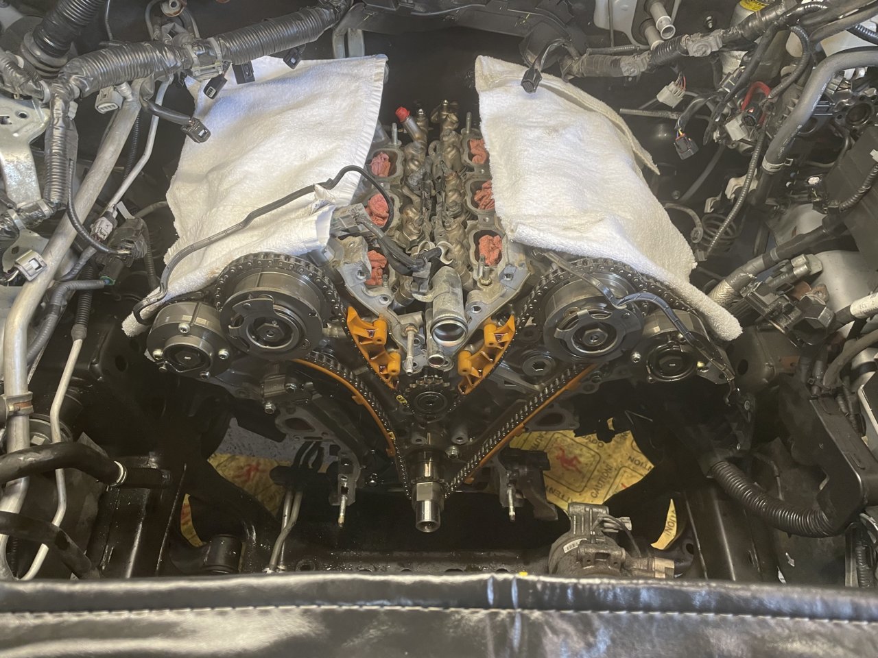

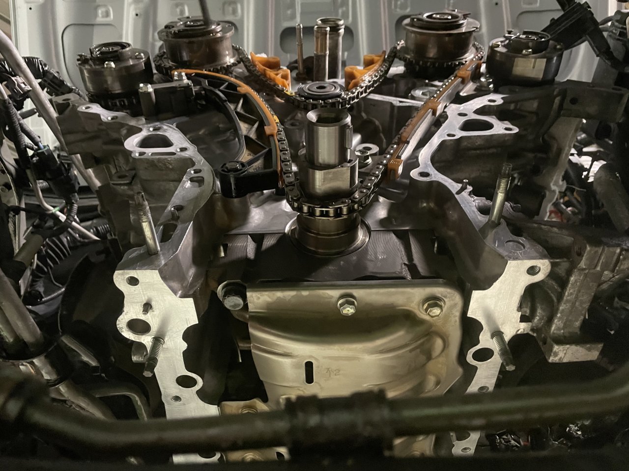

    Honestly it’s a huge job. Tons of bolts , and removing the harness without damaging the clips is very hard, doable but hard. I’m kinda happy about it because I get to go thru the truck and replace everything that needs to be done as far as scheduled maintenance. Water pump was showing signs of a leak, plugs needed to be replaced . Flushed all fluids , alignment afterwards . A huge huge job . I can’t believe it only pays 16 hours warranty for a tech .

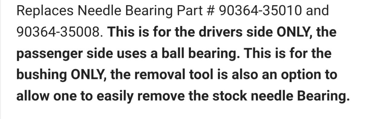

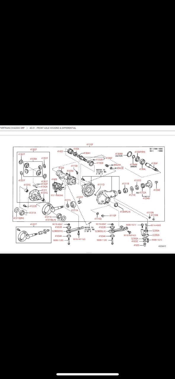

    The needle bearing is only on the drivers side. The passenger side is a ball bearing. It is completely different and not interchangeable. This is from there webpage. 20220201_172348.jpg

    Speedfreak when you take the diff apart there is a needle bearing on both sides .
    41331g is the bearing and it’s on both sides . Thanks for your concern , but I called ecgs and they said it’s even gooder now

    I’m not doing the work , I’m recovering from some health issues . Your right it’s a massive job and I hope it comes out ok

    Good to know. Just going by what the website states. I have not pulled one apart. :thumbsup:

    I've had both of those things done. Timing cover was leaking like mad all over the power steering pump at 65k, common for 2016. Cost $2500 at dealer. Did tons of work and took over a week. They actually resealed everything on the engine that uses the fipg sealant. That was nice and new coolant, freon & power steering fluid. They removed everything to get in there and it's been perfect for the last 5k... On the ecgs bushing, I put on a 3" lift and the old bearing was humming like mad. "4 wheel parts" had the last bushing in town and put it in for $350 in a couple hours, on the correct side thank God! Hope it goes well for you.
