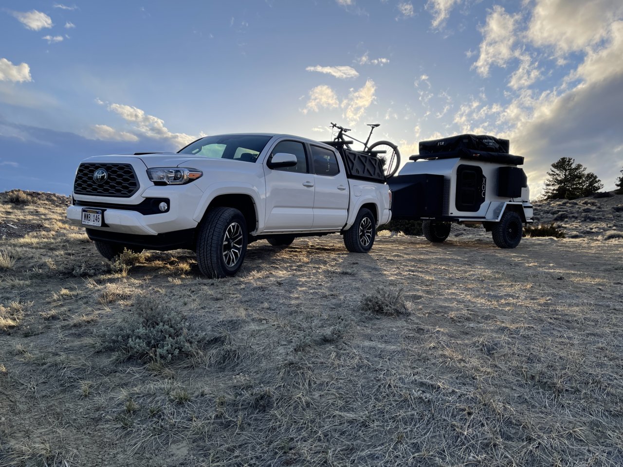

    Something seems off here. Can you please include pictures? Are you using a drop hitch? You may have to flip the drop hitch so the trailer sits level with your taco. My XOC has 26 inches of clearance... much more than my Taco has so I had to buy an 8 inch drop hitch and turn it upside down just to get the XOC to sit on a level plane. I have a feeling your Wolf Pup is pitched down and is putting more weight on the taco than it should.
    Please include pictures of how your trailer is sitting on the taco and also get a pic of your rear wheel wells so I can look at the springs.
    :worthless:
    Also: find a local truck stop or service center with certified scales. Back in Omaha my local QT had a diesel island for the big rigs and the scales were next to the truck island. You should be able to find a TA, Loves, or Pilot/Flying J in your area. When you pull up to the scale position your truck and the trailer so each axle is on its own load cell so you can get the front axle, rear axle, and trailer axle weights. You'll see the cracks between the plates on the scale - those are what separate the load cells. If you're not tall you may have to stretch to push the button for service since they are positioned for big rig drivers. Push the button, tell the person on the intercom you are there for a new weight (rather than a re-weigh), it is your personal vehicle so just number it #1, and you'll be paying out of pocket. Some weigh stations will ask if you are military and if this is part of a PCS move - just say no. Attach pics of the weight slips to this thread. We need pics and data.
    Edit:

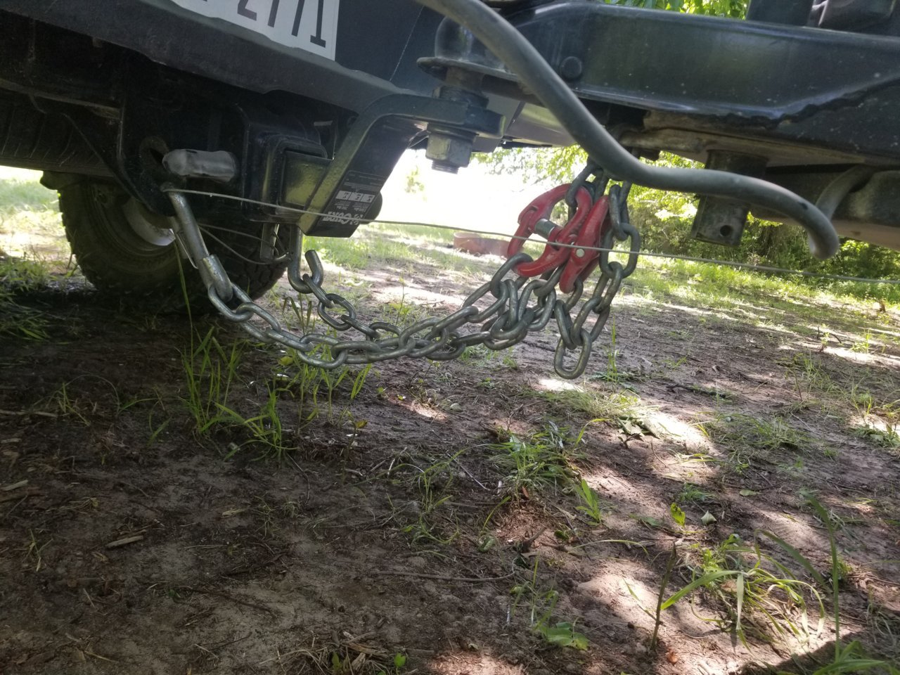

    • Also - I had to shorten my tow chains. I believe most manufacturers purposefully leave them long so owners can trim to their needs.
    This is what I tow: '22 Vorsheer XOC on 285s and 3000# as pictured.

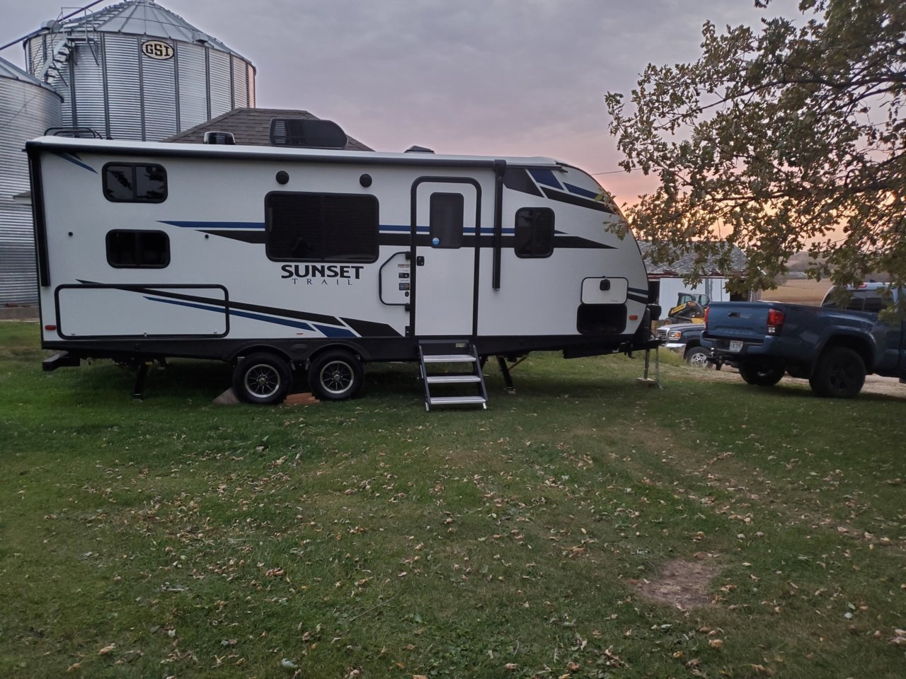

    I have a '19 sport(M/T). I towed a crossroads 215bh sunset trail with it on a 5hr trip. Not ideal but was just fine. 70-75mph average. I had 500lb helper springs and a WDH. Rides level (that is the purpose of the wdh). Keep in the appropriate rpm range and there is no issue. Camper loaded was about 475lb tongue weight. Camper weights 4600ish I think. Close to the vehicle gvwr with the truck and camper loaded but the breaks are the first fail point so just be aware of appropriate stopping distance. Can't speak directly to an auto but I did just fine.

    Also, shorten up the chains. I use hammerlock shackles to take the slack out of mine. I'm surprised it's dragging that low.
