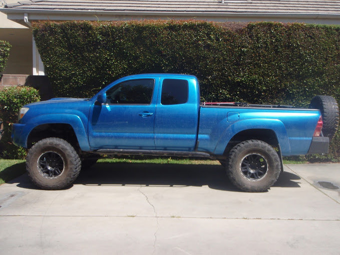

    Here is mine with the ALL pro Leaf expo pack with a heavy ass bumper on the back.

    thanks...yeah I just looked at your whole build thread. Looks good. I honestly think a small tiny amount of bro lean would bother me. :(

    Quite possibly the best looking drop bracket lifted truck I've seen. Well done sir.
