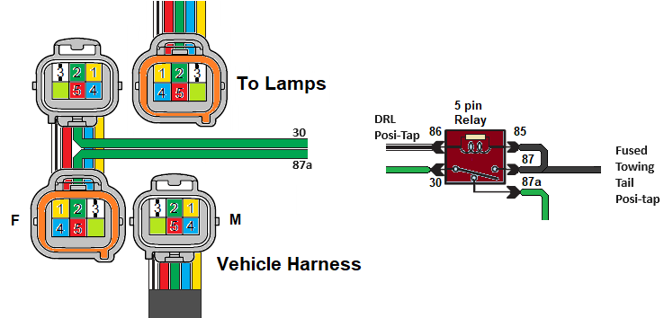

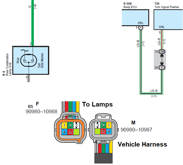

    If you insist, with an assembled Y pigtail to the rear light assemblies you'd isolate the parking circuit. You could tap into the towing circuit-battery charger side for IGN fused source. Then run a wire (-) to the DRL wire on the main body ECU. It would require a 5 pin relay also.

  8. May 15, 2024 at 7:46 PM

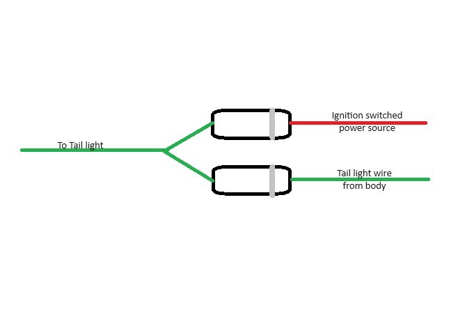

    While caribe makaira's solution is elegant and the correct way to do it you can also doing on the cheap with a pair of 3-5A diodes, one placed inline on the green wire of each tail light with the stripes facing toward the body side and then tap the other one to an ignition controlled power source, such as the towing circuit.

    That be always ON after IGN. So no DRL switch control.:burp:

    True. I didn't realize the was a switch for DRLs. I run an 05, so no DRL at all.
