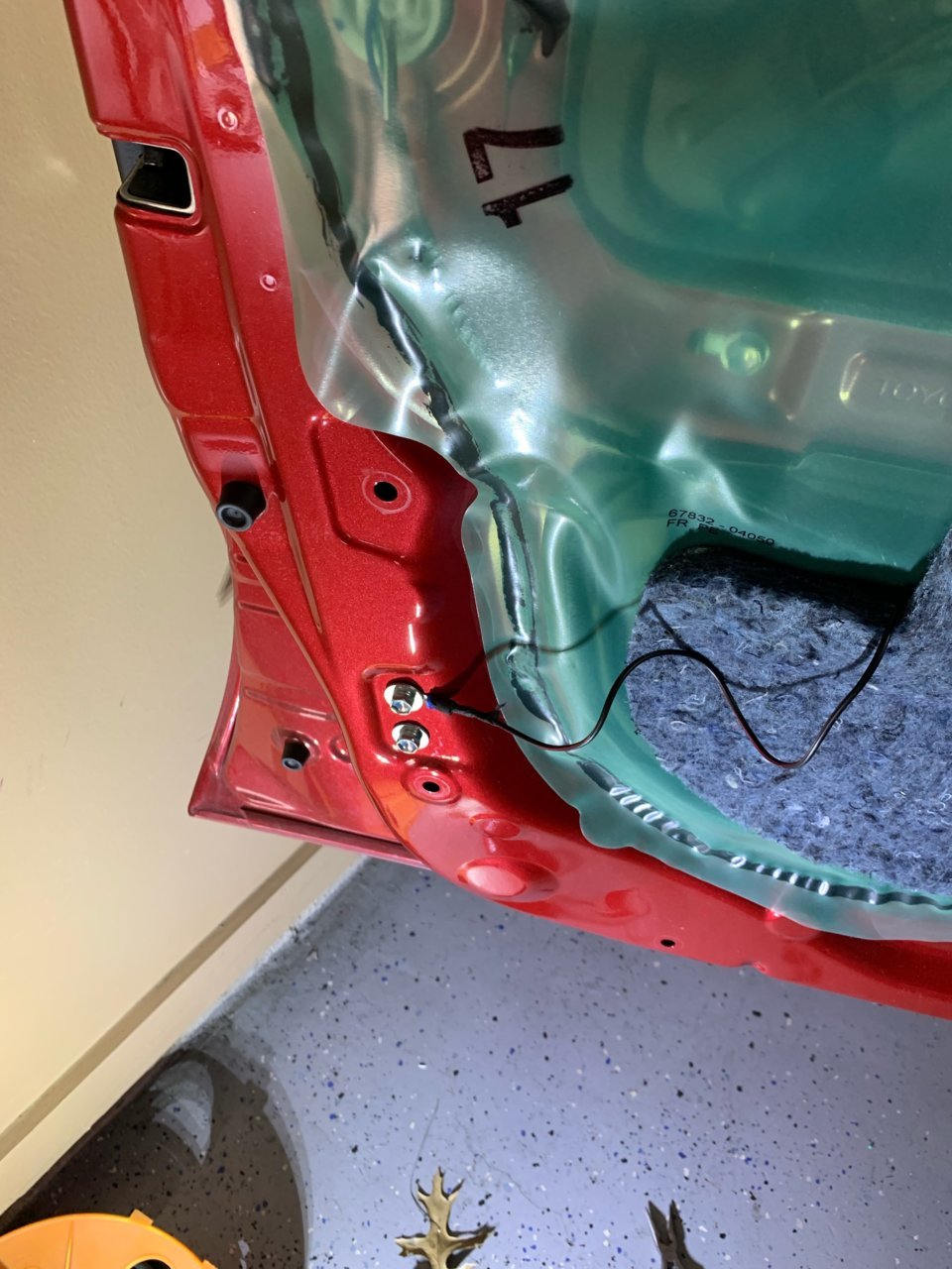

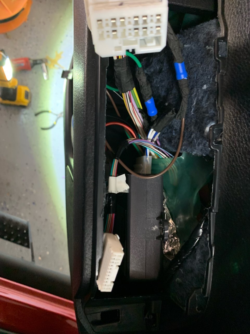

    On my 2020
    Drivers side up wire color is
    Pink with a blue line
    Down which I already had is pink with a black line.
    12 volt was a white wire
    I grounded mine to a bolt that holds the window track.
    When you cut the wire one side will now be switch side one motor side it’s what will call it since the wire was cut in half.
    so from the module
    Brown wire switch up
    Green motor up
    White switch down
    Blue motor down
    Red to 12 volt
    Black ground
    2 other wires unused
    pass side
    Up wire pink with blue line same as drivers.
    Down pink with a yellow line.
    12 volt white same as drivers no need to cut in half.
    Cut wires and call one side switch side and the side going into the door motor side. Connect wires to module accordingly.
    Best way to double check is get a test light pull switch cover off leave switch plugged in ground one end of test light to a bolt stick the pointed end of test light into the wire color where it plugs into switch you think is correct wire and press the switch up/down whatever wire you’re checking if test light lights up and corresponds correctly with the switch you got it.
    My ground
    Where I put module
    I normally soldier everything but on this I used quick connections on the wires I cut in half so if for some reason the module stops working with the window down I can pull the switch cover off by hand unplug module and plug factory wires back together. Working great still!!!
    From what I read ktjo 4x4 has the passenger side plug and play for like the same price the module cost so I’d do that on pass side and buy 1 module for drivers side. I bought a 2 pack of modules is why I wired my passenger side up.

    Thank you for the detail and the pictures. Will make the work much easier for me.
