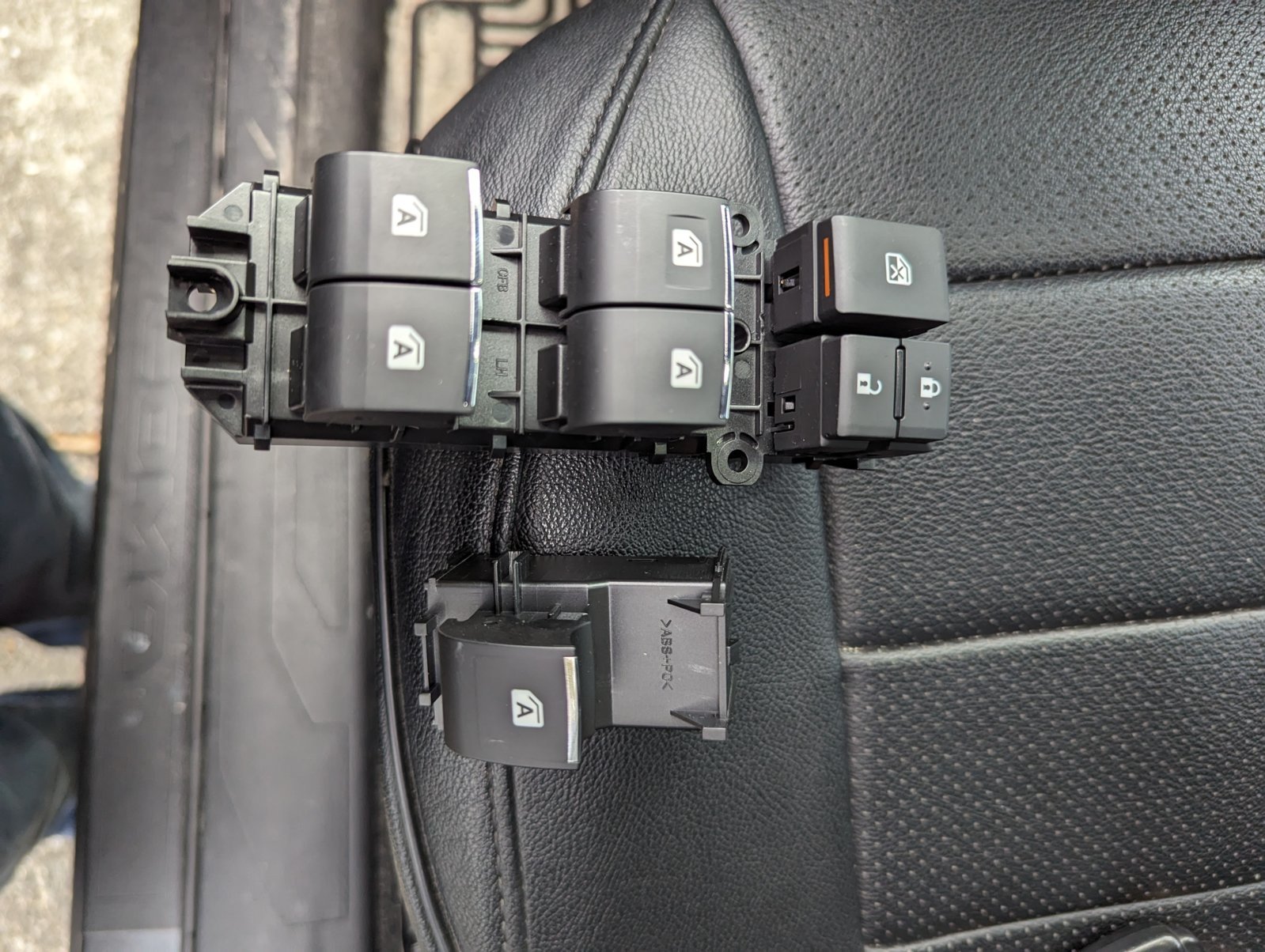

    The cartrim option post#38 seems like a great solution. I have an access cab so only 2 buttons on drivers side. Does anyone know if I can replace just one of the buttons or so they come as a unit? I’m asking because cartrim sells a bank of 4 (for crew cab) or individual switches. I would buy 2 individual switches if I can install as 1+1 rather that a bank of 2 that are inseparable if that makes sense.

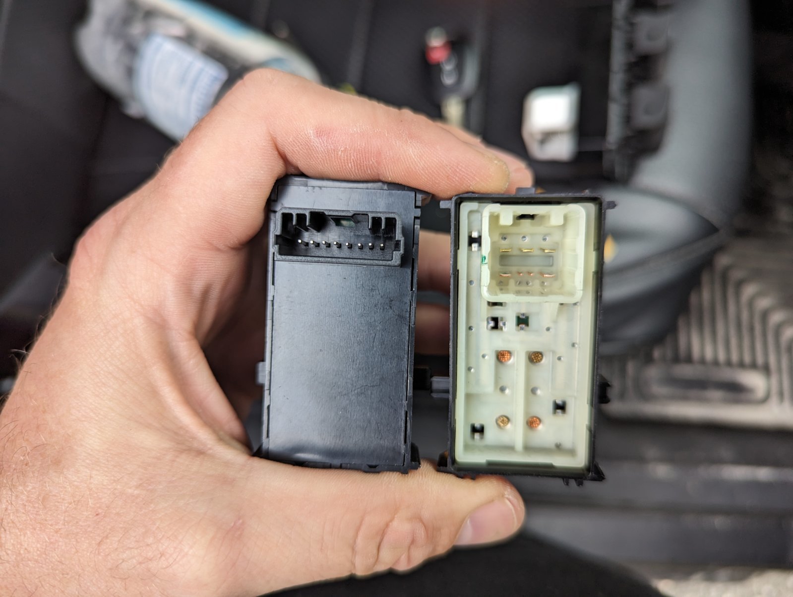

    Got my cartrimhome auto up switches today. Got the driver side in and it works great! Finally have auto up and down on everything. Only thing is I bought the two piece set and the passenger side has the wrong plug. Sent them an email, hopefully it can be resolved. Not that it's a big deal, I can still control all the windows from my side.

    My switches from cartrimhome arrived today. Install was super easy. Works as advertise and excited to use it. I do hear a click a few seconds after windows are up from the switch/door area. Guessing that’s normal?
