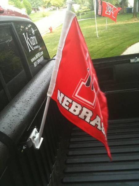

    I mounted mine the same way nammer, except instead of using the washers, I got 1" flat aluminum and cut to the same length as the mounts, drilled 2 holes and slid them into the bed railing, much more secure. I was having problems with them moving and the washers popping out and almost losing the bike while driving down the road.
    Also when its football season and I'm not riding my bike it is converted into my flag holder. I took some 1" flat steel and and bent it around the bike mount with enough to drill holes and slide the rod through.
    Cmurder likes this.
