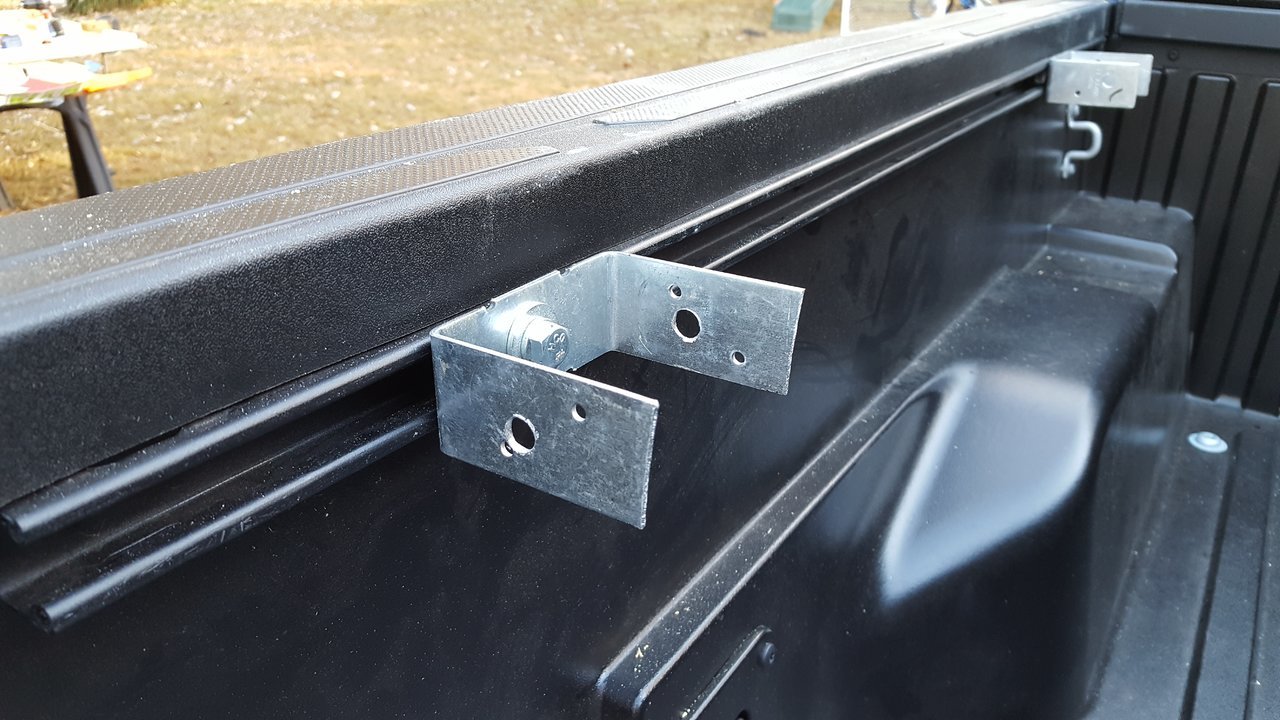

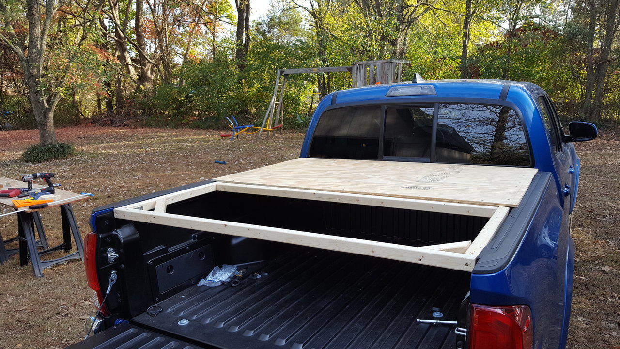

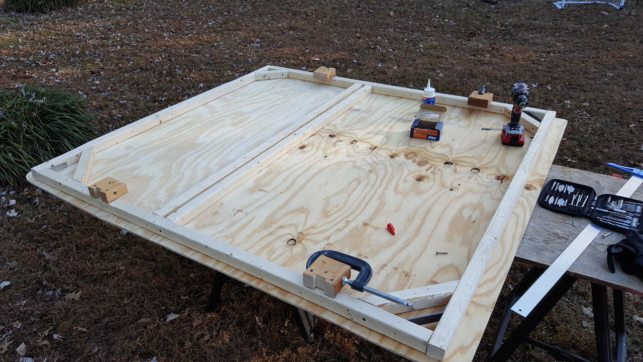

    I made a tonneau of sorts out of wood. I needed it for camping and use it 2-3 times a year. $65-70ish.
    I don't have pics of the finished item, but I used 2x4 brackets to attach to the rails, then used T handles to attach the cover to the brackets. I also put a few large eye hooks underneath to bungy it to the truck just in case something fails.
    I sprayed it with bed liner so it's black. Folds up at the hinge area.

    Also, this didn't provide enough room for 4 guys gear with guns and such, so I'm planning to make a soft topper here in a week or two... we'll see how that works out... :\

    Thank you sureshot for sharing your project, nice work!
    Did you use T slot nuts to attache to the bed rail?

    I actually found something at lowes that is used for electrical installation that has a spring on it... it has a threaded hole in the middle and that's what I used. I did that before I found out about the T nuts that would fit our rails.
