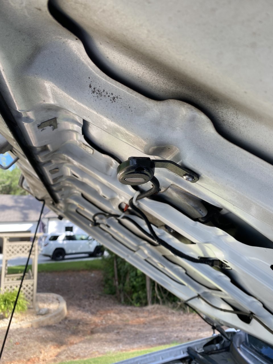

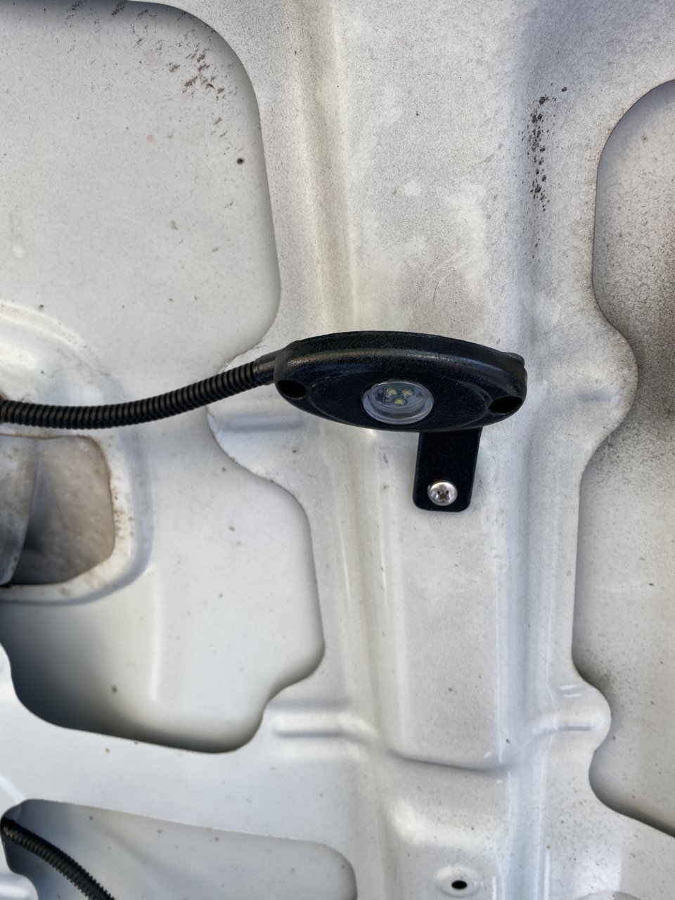

    TomTwo
    TomTwo I love God but I cuss a little
    Jul 14, 2013
    #108271
    14,216
    Bill
    I-85 Southbound
    2013 TRD Double Cab Sport
    66EC5240-C19F-45EB-8D1E-0C5FE5DFF6DC.jpg So I stumbled across this thread last week went to Lowes and grabbed some T brackets and some 10/24 rubber nuts like the ones the OP used and ordered some cheap white rock lights off Amazon. Used epoxy to mount the lights to the brackets and painted them with bed liner. Covered all the wires with split loom and waiting on darkness now to testEA77CD08-8E9E-4605-B144-DC192DDCA2CE.jpg3975185C-696A-41D7-9D40-F197D78E64B3.jpg
