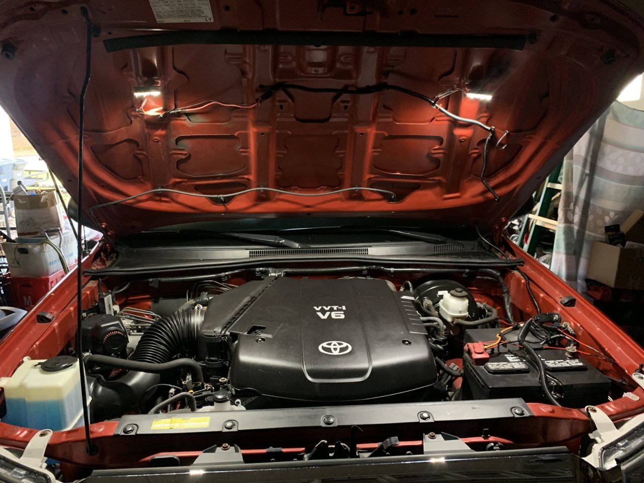

    Got my brackets today. Was going to install tomorrow, but this election is giving me anxiety so I just finished. I used the KC Cyclones with the KC harness. Both red wires were too short and I had to add wire, but other than that it was a smooth install and a great mod!

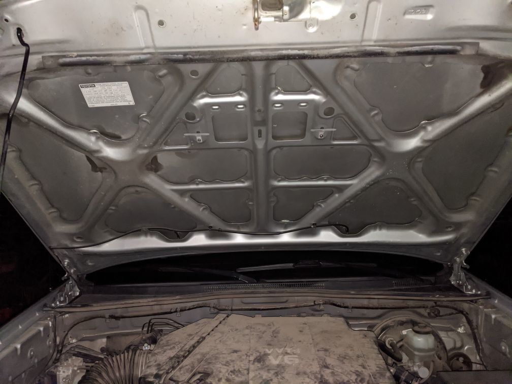

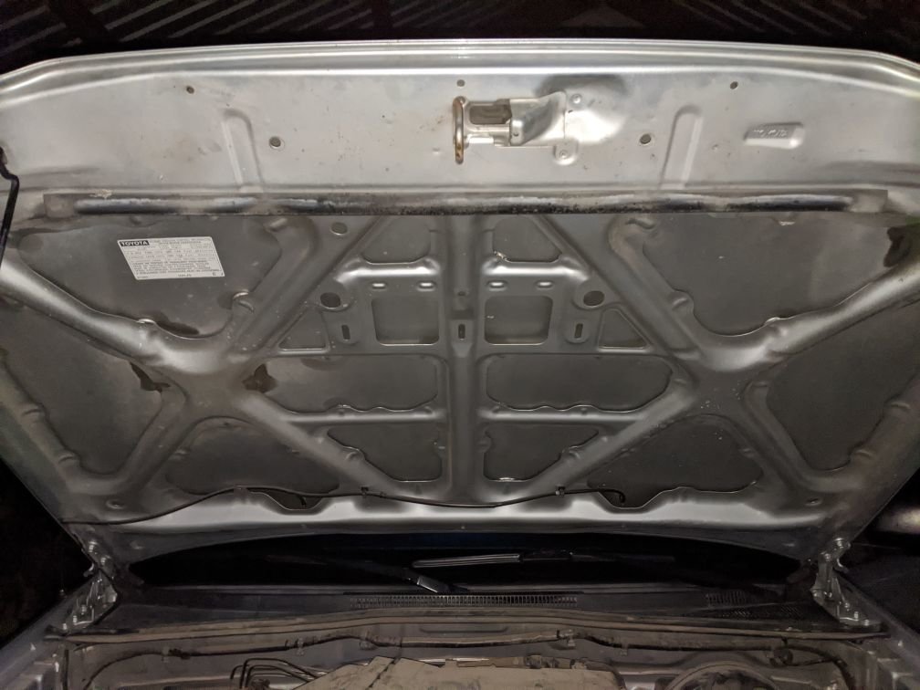

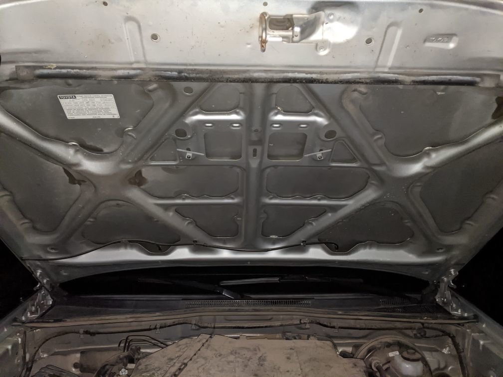

    Got the brackets in today, thanks! I went to go take a look under my hood and found out that the 2nd gen and 2.5 gen hoods are different. The brackets are still mountable with the included well nuts without drilling if you use the slots that are used to mount the fake hood-scoop. They will be closer together so I may angle them a bit to get better coverage. As far as I can tell there should be enough clearance so that it won't hit the engine cover. Once I actually get them fully mounted I will be able to tell better. If they won't clear, it looks like the next best spot would be to drill a 3/8" hole in the center of each X in the hood bracing. Still need to find a switch I like, once I do I'll wire everything up.
    Stock hood from my 2011:
    Brackets mounted straight:
    Brackets mounted at an angle:
    tamer[OP] likes this.

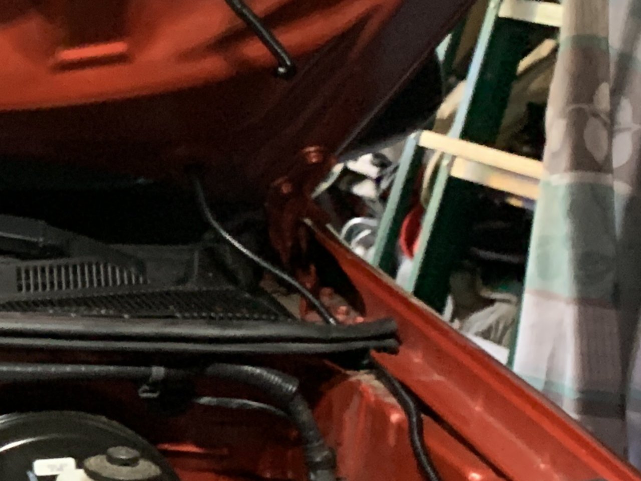

    Would you have a photo of the wire routing by the hood hinge?
  18. Nov 13, 2020 at 4:13 AM
    #98
    RedTaco68
    RedTaco68 Well-Known Member
    Oct 4, 2020
    #342735
    144
    Pete
    WOOtown County, MA
    2013 Barcelona Red SR5 4x4 DCSB V6 6spd MT
    Millennial Anti-Theft Device (stick shift)
    Hope this is useful:
